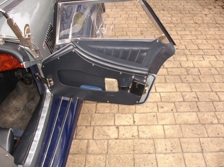

As I posted earlier I had tracked down a strange knock to loose rear spring covers.
Today being a slow home office day (most of Europe being on holiday) I clawed back some work life balance & fixed those plus I added some neoprene section to the doors to I hope stop water ingress & reduce draughts with the hood up.
I used a 10mm x 6 mm self adhesive p section neoprene from Seals + Direct Ltd (usual disclaimer etc). I bought 3 m which left c 1/2 m over. cost £9.60.
Now I need to drive it in the rain again to test it.
You can also see the charger lead for the battery but not the inline fuse which is behind the aluminium plate.

Nice job John. I may well try the same.

Thanks I saw it on Dave W's car & decided to give it a go.
I am going to wash the car with the hood up Thursday to review the filth from driving to Devon at the weekend so I will give it a test drive.

Only a little to test it. I can tell you over 60 mph a lot of water was coming in epsecially in the windy exposed areas like Salisbury plain. Not a problem I have had before but then I haven't driven for 6 hrs in a monsoon before.

That's an excellent picture of the end of the spring that I found was the cause of the squeak on mine. I spray grease them every year and hadn't thought about that bit. Removed the covers, greased them and squeak cured.

Yep I took the opportunity to spray them with first pentrating oil and then moly grease. You can see that in fact they wre / are rusting.
