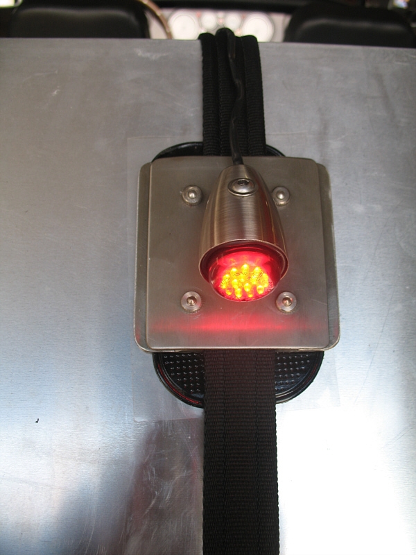

Here some examples from the modifications I made the last days before our trip through Norway last June.
Part two:

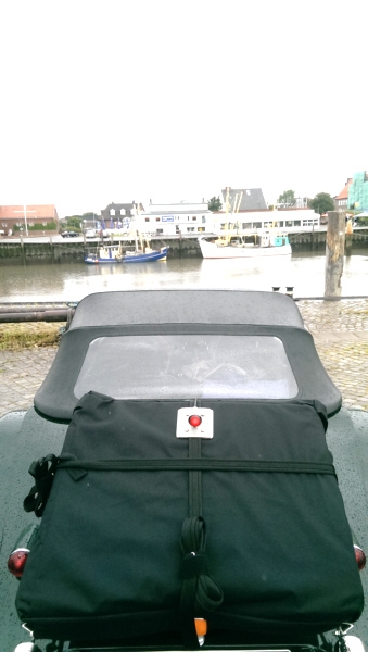

Driving with different cases we need an adjustable (high) brake light. I also want to secure the cases a little bit when parking with lockable straps.
So I made two stainless steel plates and welded two small s/steel on one plate to guide the straps on each side. Because I sell bike parts I now only had to take a led brake light out of my stock and had to insert it in a housing from an old wall lamp.
The whole brake light is connected with a coil cable to the Morgan loom.

Very nice indeed. I think there are quite a few Morgan owners would buy one of those if ever you decided to put it into production.
