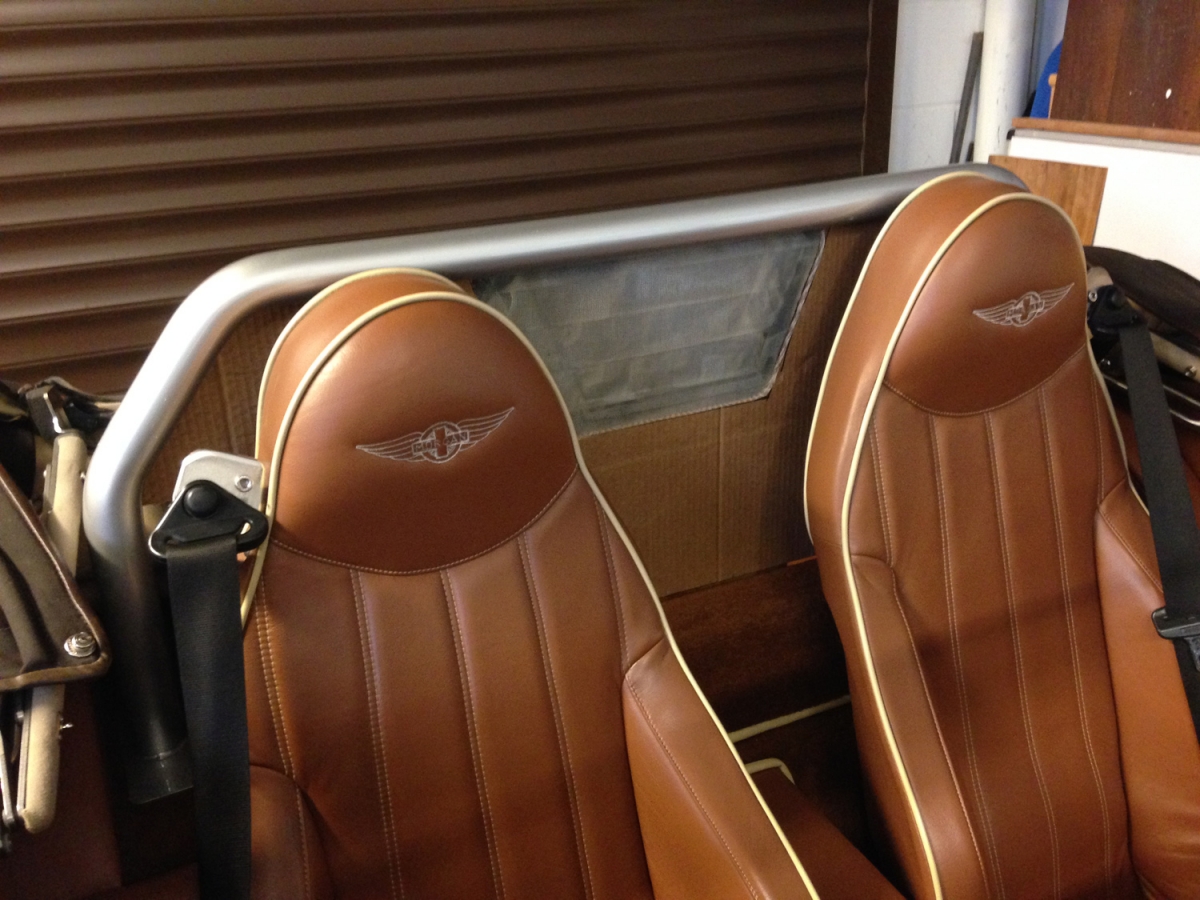

Step 1 was to have Aero Racing fit the roll over bar they developed for Aeroman.

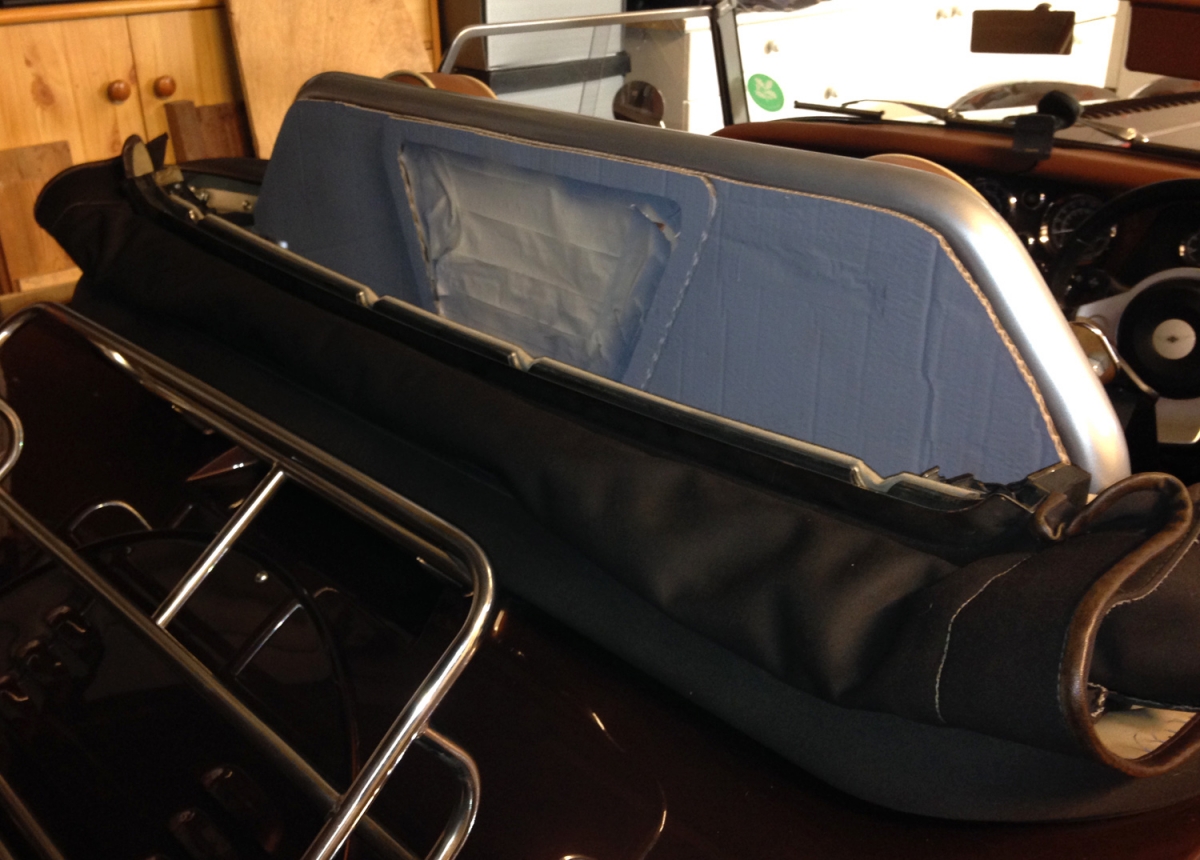

Step 2 was to make a prototype wind deflector and road test it.

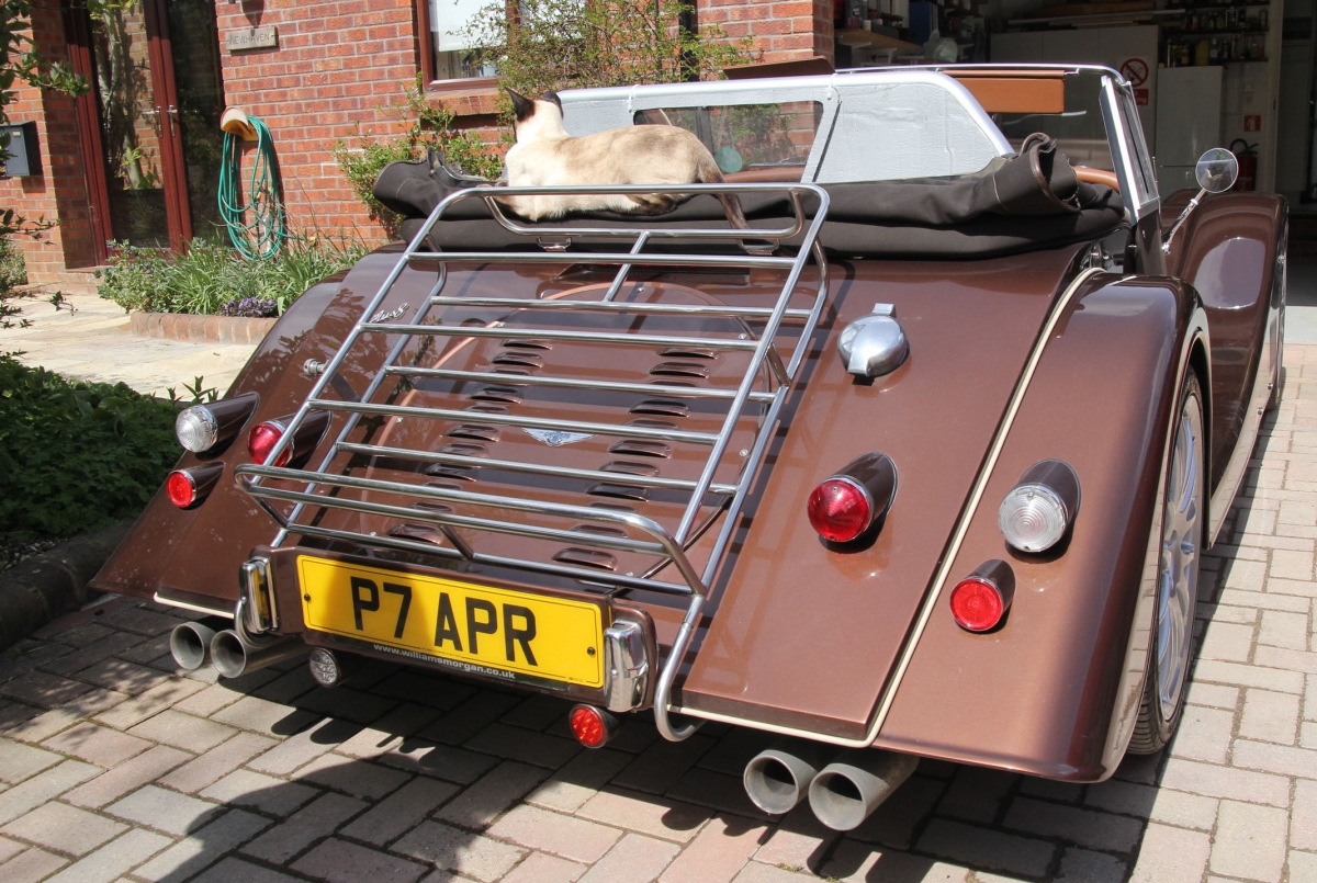

These photos show the evolution of the screen and the finished card prototype. The fitting, using zip-ties is temporary, the final version will clip to the roll bar frame.
The hole, covered by fly screen mesh, was put there for two reasons:
1. So I could see behind
2. To see how much air comes through this space. The answer was "a lot"

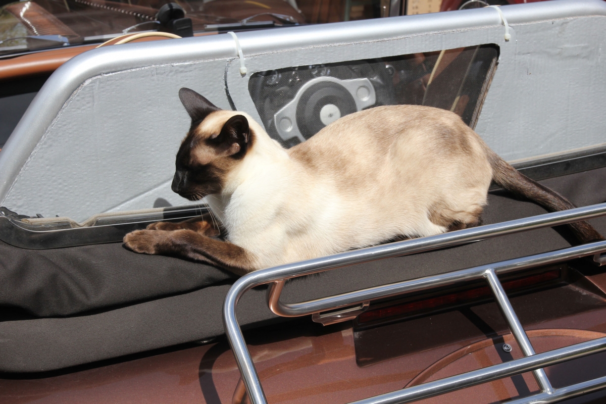

The cat is removable amd simply there because he likes sitting in the sun. He is, of course, nicely colour coordinated!
A road test today shoiwed it is promising..the Co-Pilot said that the cockpit was quieter, her knees didn't get cold and she needed neither scarf nor at lower speeds, a hat.
