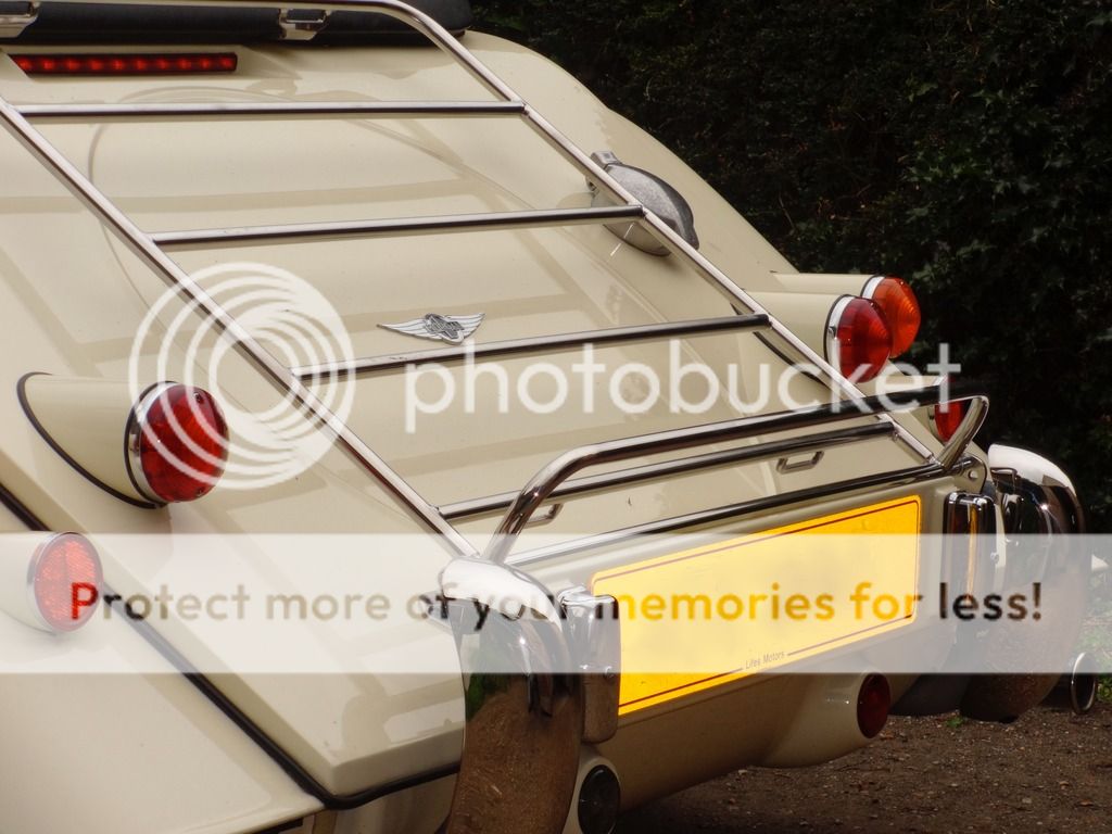

Re: Luggage rack for Plus 4 Sport [Re: Nickplus4] #398072
07/10/16 07:51 PM
07/10/16 07:51 PM
Posts: 18,502
South Yorkshire
DaveW Offline
DaveW  Offline
Posts: 18,502
South Yorkshire
2005 Corsa Red Roadster S1
2016 Saffron Yellow (Narrow) AR Plus 4

Thanks Dave.
I can see how, now. Good old Fred Dinage..
I have a plan, y'see.
