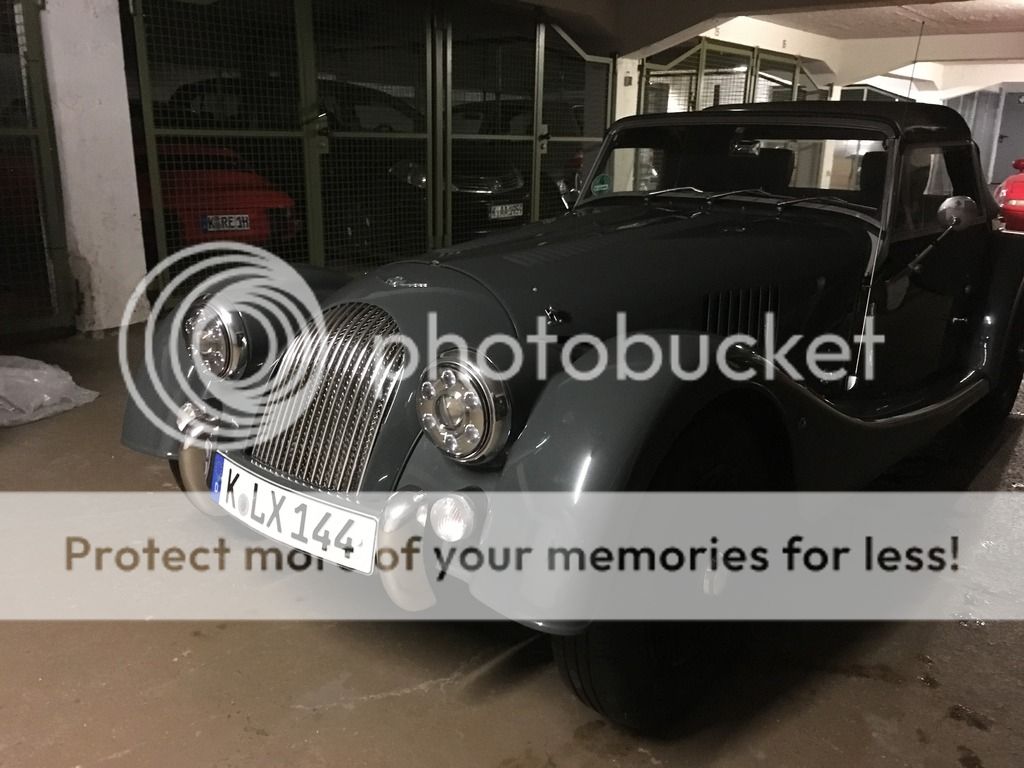

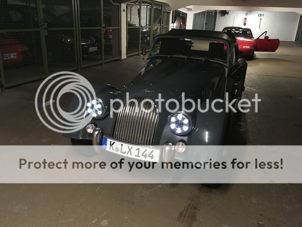

Here we are, Unfortunately no nice pictures with landscape, it snows, rains and is very salty since a week here. That's why she stays in the basement garage.
But it's all about how the headlights look to her.
Of course, the classic H4 headlight is the best look, or even these old Lucas with the three rods.
But the look could be worse in my view. I post it because it's a deviation from Richard's car, narrow body and chrome rings with the headlights.
The light output is not writable. I am curious how it will be on the road at dusk. But everything has already been said here about that.
The lights probably still have to be adjusted exactly by a professional. I was now defensive in the alignment, so that nobody is dazzled.
[/UR
[URL=http://s576.photobucket.com/user/heinzrehbein/media/0913DD20-868E-40F7-83DF-37EA8F4D476E.jpg.html]
BTW the DRL is still running when the dipped beam is switched on. But I don't think it's a problem. With high beam, the small lamps add up with full power.

Looks fine Heinz - maybe better with the chrome rims.
Must admit that the advice I gave you on DRL mode switching off on dipped beam was from sales pictures. In any case you may have noticed that the current draw from DRL alone is just 1 watt (24 watts on full power).
Regarding adjustment I wound the previously fitted ARV6 headlamps one full turn downwards as testing suggested they were too high. With the LED's I put them back to factory setting as a reference point. They seem to be spot on innocent
ETA: for the benefit of others the middle picture Heinz posted is DRL alone.

In combination with your black grill and Le mans overriders the black headlight ring looks very good as well, Richard.
I had thought how black LEDs would look like, but I didn't order it because the small LEDs would only stand out even more.
