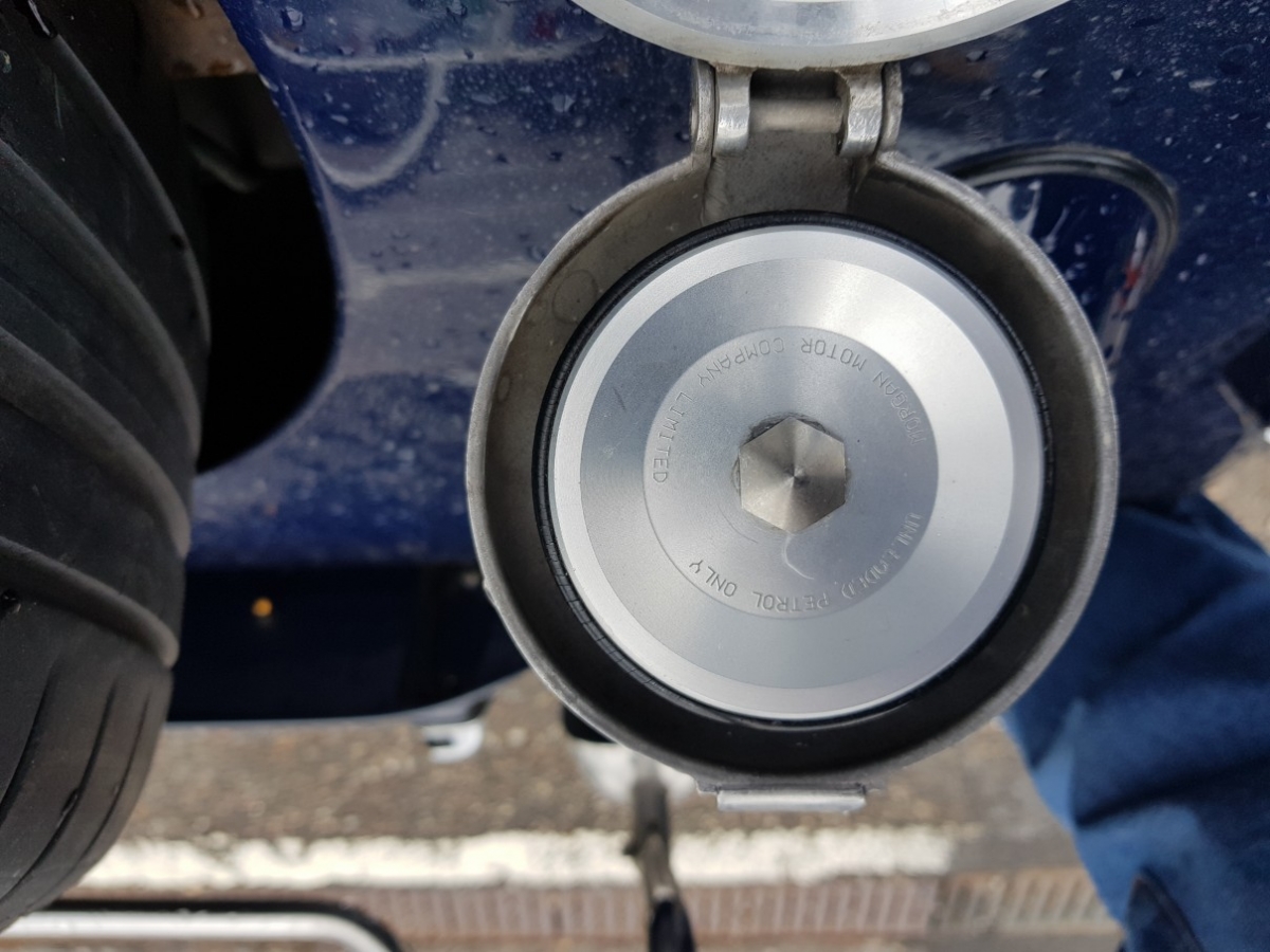

There is something odd about your cap (the fuel cap). I now have a small collection of caps, new and old. My original 2007 cap, a new MMC cap on the car, and a CLA300 cap from Newton (the manufacturers).
All the caps have the same structure for the secondary seal
The primary seal is the locking insert, the secondary seal is by way of an o-ring around the sprung loaded disc in the cap, o/d 78mm as mentioned by Dave. There is no other seal on the cap.
Your picture shows what looks to be a rubber sheet gasket in addition to the sprung loaded disc
Once the sealing disc is removed the cap looks like
The edge of the sealing disc showing the o-ring
The disc and o-ring is fairly well spring loaded and appears to make a good seal with the filler cap body. Although on my old cap the o-ring is showing signs of age.
I have to add that on my Plus 4 the seal on the locking insert definitely seals the tank and there is an intake of air when I remove the insert, so I don't know to what level this secondary seal is important if the primary seal is good.
Just wonder at what point the flat gasket (third level of seal) was added to your cap.
