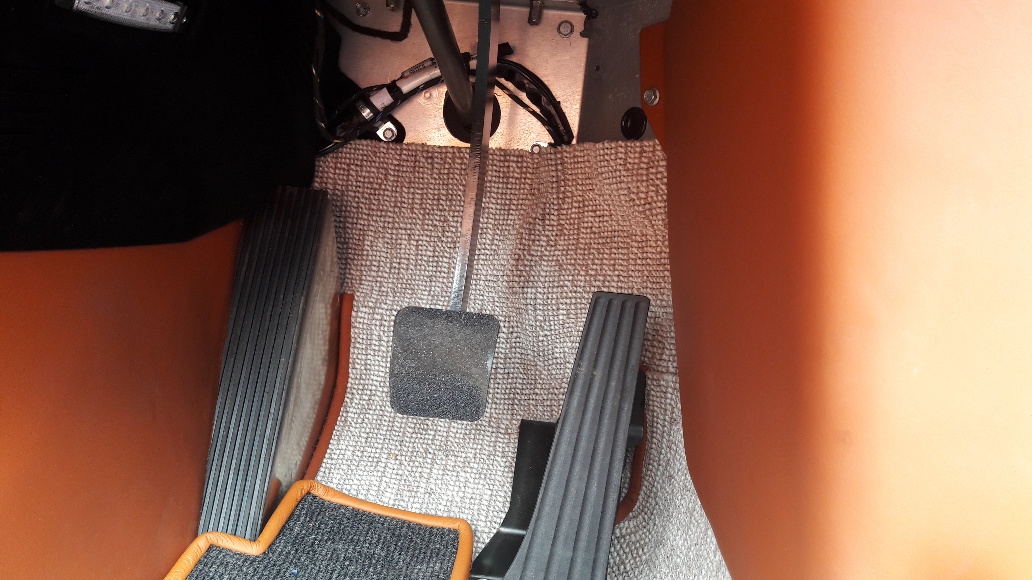

And talking of brakes, the master cylinder / servo is mounted much higher on the bulkhead (compared to Trads) which allows a more conventional top hung brake pedal
Although, my right foot whilst resting on the accelerator was only a knats whatsit from touching the right hand edge of the brake, nice that there's a proper rest for your redundant left foot

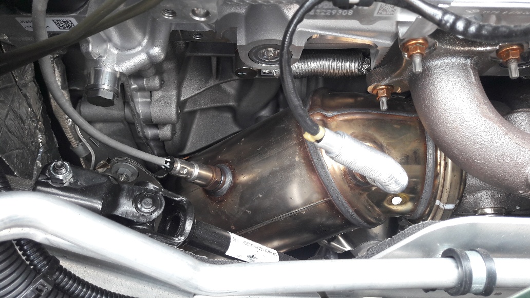

The exhaust manifold is cast not tubular & the CAT is attached direct, so in effect sits in the engine bay
I think it needs a proper heat shield - it's going to get very hot in here, and radiated heat could effect some of those cables & pipes
As others have commented on, there are masses of cables & pipes within the engine bay, see also the battery shot in previous post
