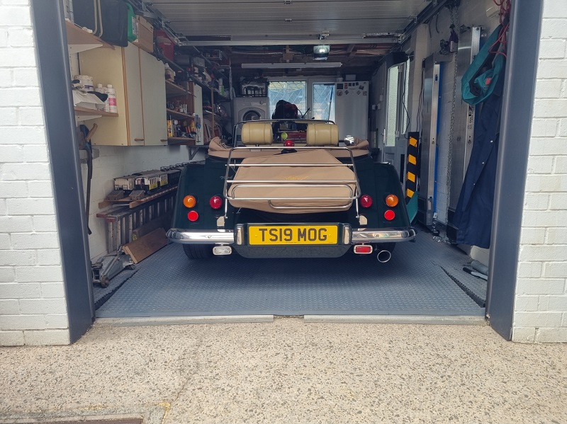

I use a "EZCarlift from Holden Vintage and Classic - https://www.holden.co.uk/p/car_lift_e_z_mobile_for_home_and_professional_use
Winds up with an electric drill
I hang it on the wall of the garage when not in use - you can see it on the right in the picture below

Wow that's way over the price of mine somestick. At my age oldgit I need to be able to sit underneath wink
I admit I can't hang mine on the wall although there is provision to wheel it around.

Ian, in the photo taken outside of your garage, does the floor slope slightly?. The reason I ask Is that I have a slight slope in ours, as its a converted stable.. Most of the scissor jacks state to lift on level ground.. Now I can get around this with some tapering planks under the scuissor jack, but this takes away some of the access height to deploy the jack under the car.. If the Holden jack will work on a slight slope, then that would do the business..
Rgds Dave
Dave
Sorry no its relatively flat
If anything it slopes slightly away from the house
I'd check with Holdens to see what they say
The lift has "square feet" on one end and rollers on the other - The pieces of ply you see in this pic are for the rollers to sit on, rather than "rolling" across the concrete.
I do have a set of low car ramps that I drive onto and then roll the lift under the car as space is tight
