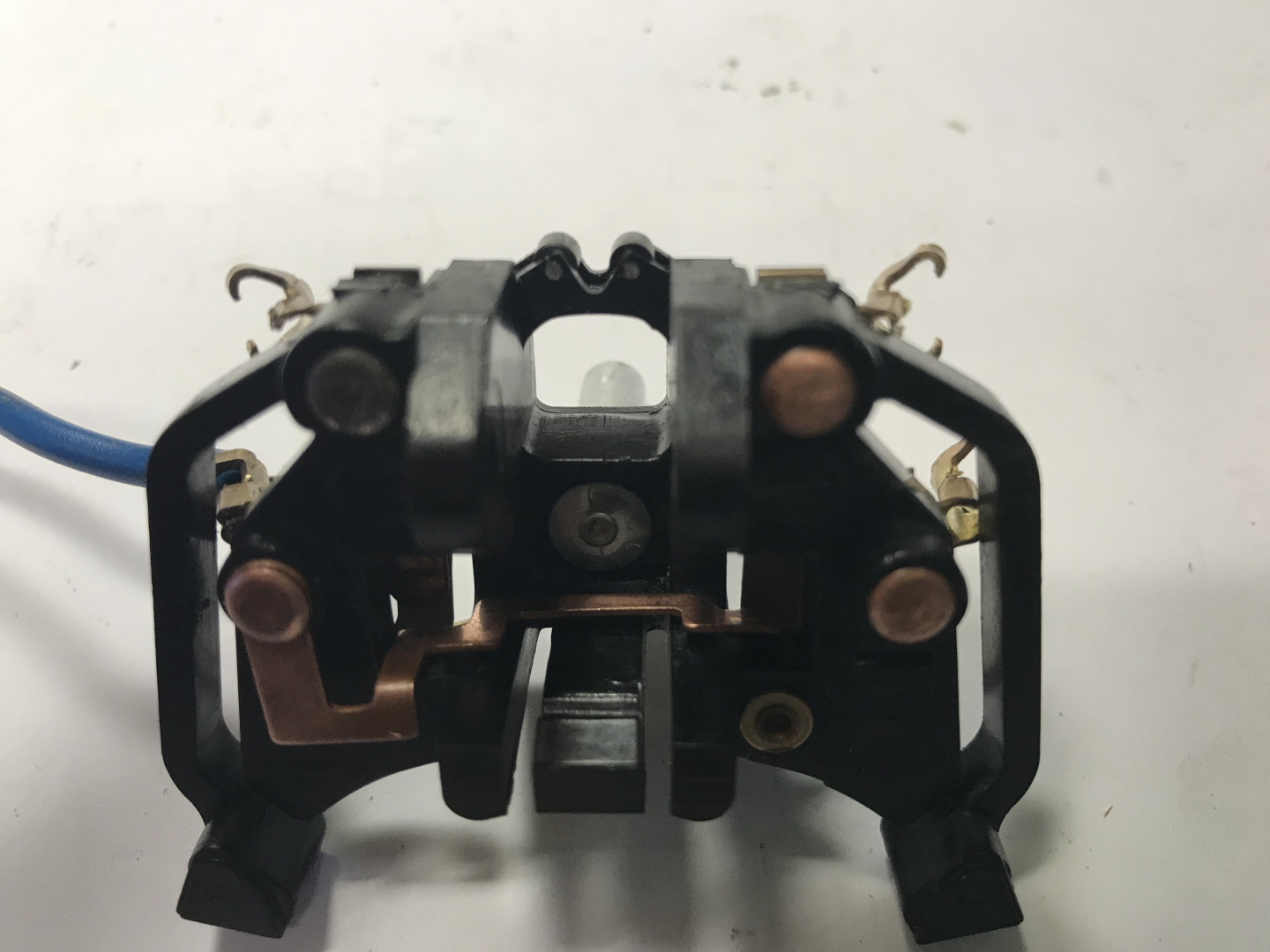

Firstly I apologise for contributing to the proliferation of a thread in the wrong section. But with regard to the new SQB119 switches I found them to be of an inferior quality compared to the original Lucas swiches, and that's not saying a lot.
In an attempt to solve this problem I decided to rework an original indicator switch. Firstly I dismantled the afore mentioned switch and enlarged the central hole, in the switch base in which the switchgear rotates, and fitted a bush made of Peek which reduced the hole size to give close transition fit for the switchgear pin. I then modified the indicator arm detent arrangement, which I have always found to be not very positive due to the friction created when the detent rides up out of the centre knotch, this I achieved by machining a slot through the centre of the knotch and fitting two small rollers that rotate as the detent rides up out of the off position and passes over the crest of the roller to give location to the left and right switch positions
Also as the switch was dismantled I extracted the indicator arm from its base, removed its sleeving and formed the arm in a tight S bend, then replaced the original sleeving with heatshrink.
The re-worked switch has now been fitted to my car for 18 months, its function has been as I hoped, positive and problem free. However I have fitted relays so I don't have to do the job again.
If you find my description unclear, I will try to post some images(if I can find them)
Owen

Below are the images I mentioned, not the best I know but it will give you an idea of what I did with the indicator switch.
Owen

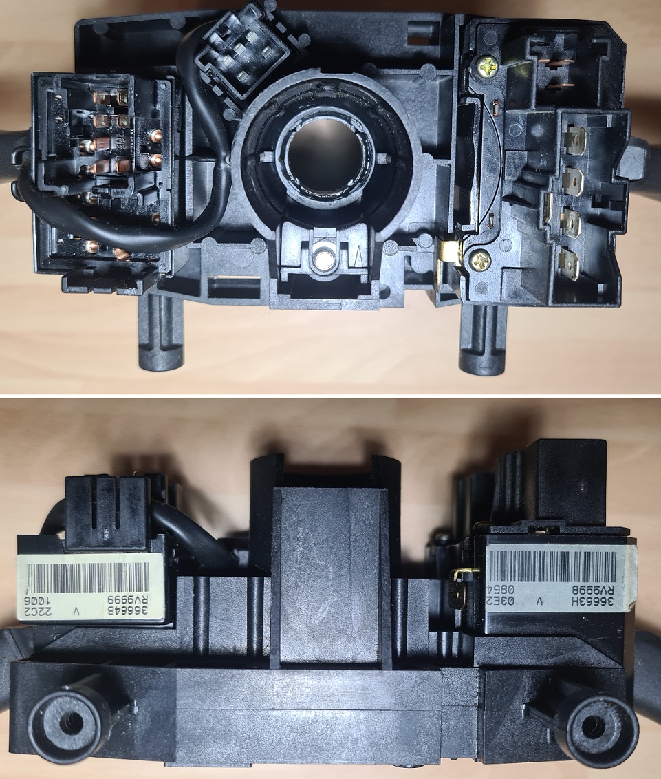

Here are photos of my original switch unit as I removed it. As I wrote, this unit was modified, i.e. fitted with different levers.
I gave Morgan-Park another used complete unit in exchange for a complete switch unit modified by Morgan-Park.
In my 1st photo the part number of the centre section (housing) of the switch around the steering column.
Apparently there are 2 versions with the same part number but matching mounts for the levers. The actual switches/levers are screwed into this centre part.
On the 2nd and 3rd picture you can see my complete (old) switch unit photographed from two angles. Do you have 4 (in one row) or 7 contact pins (in two rows) on the indicator side?
It looks right to me if you also have 7 connections there!
I hope that helps.

Thank you again Bernd. Very helpful! Your explanation and photos were perfect. I’m convinced now that it is the same item so will keep it for my spares stash. Yes there are 7 contacts but I see 2 were hiding in my photo. These items will become harder to get hold of as time goes by, the donor vehicles are beginning to disappear now. It’s nice to have spares for the critical items, particularly the harder to fix electrical items.
