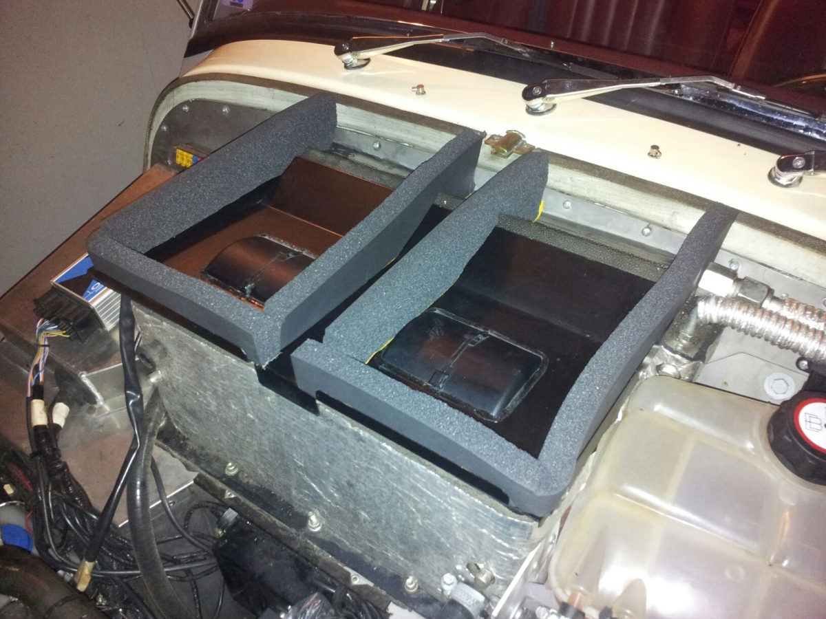

There is a very important issue and that is the entry of hot air from the engine bay into the cabin ventilation intake.
The mod is covered in the 2 threads below.
http://www.talkmorgan.com/ubbthreads.php/ubb/showflat/Number/370049
http://www.talkmorgan.com/ubbthreads.php/ubb/showflat/Number/371247
Posts: 15,548
Formerly known as Aldermog
Posts: 15,548
In a perfect Morgan world the heater intake would not be where it is, but where could it be?
I've spent time thinking about this question, without finding an answer.
Your solution is the best option, imperfect though it is.
Posts: 14,128
Posts: 14,128
My friend's '99 car has a completely different setup with two square intakes, either side of the hinge, with rubber seals that press up to the underside of the bonnets when closed. I think this may have been the inspiration for my mod.
