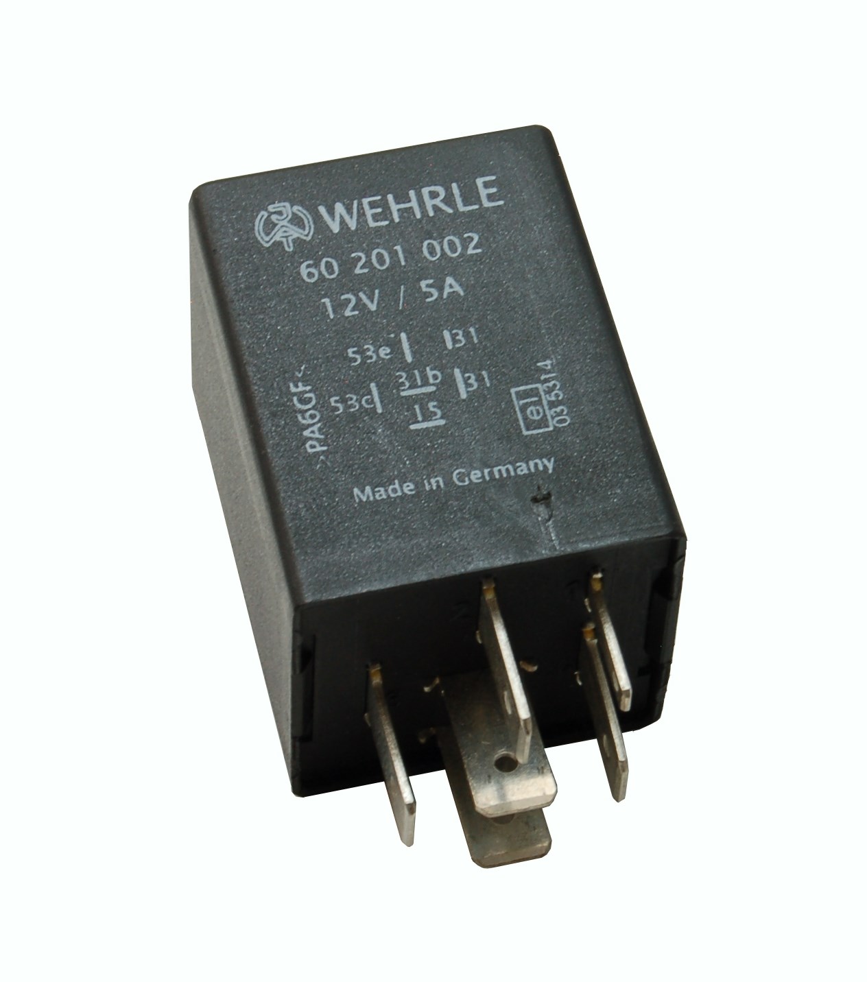

Paul although the ARP4 had a plethora of differences with mainstream Classic production, I cannot for the life of me see why MMC would have departed from adoption of the normal readily available stalk switches given they look identical. The outlay and time in developing differing wiper control just for the sake of offering something different wouldn't have made economic sense.
Having taken the opportunity recently to delve into the above mentioned Lucas STC4016 (see above for source) wiper stalk application I can say that it's heavily integrated with the six pin WEHRLE 60 201 002 wiper relay as shown below to implement the single wipes, wash wipe and delay functions available on the switch as well as constant two speeds.
Presence of this on your car would be further confirmation although there are alternatives seemingly offering the same functions.
Look forward to hearing your updates.
