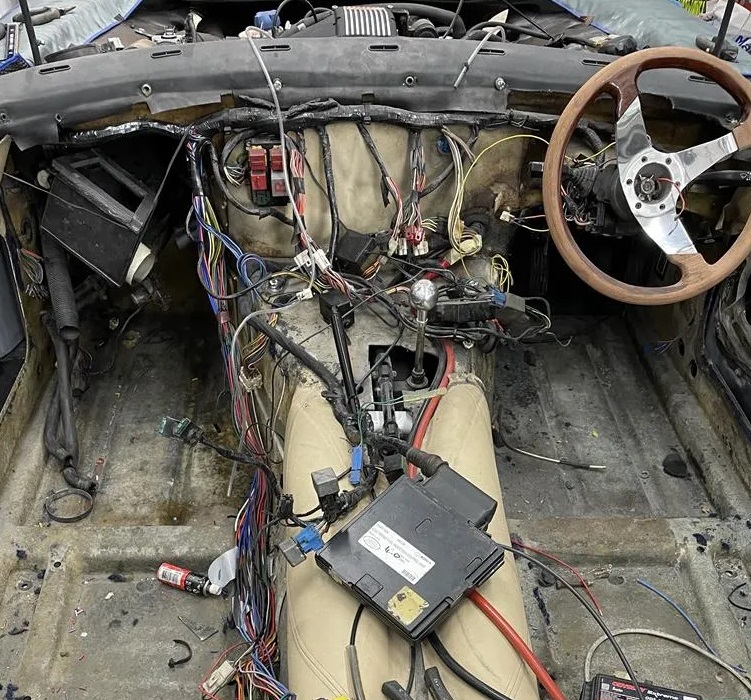

Originally Posted by britmog
If you can't get to the back of the speedometer then you know you have to take the dash off.
Just don't get carried-away like the owner of this TVR........
Re: Bulb fused [Re: Bert Wiegand] #772409
23/03/23 05:56 PM
23/03/23 05:56 PM
Joined: Feb 2013
Posts: 301
north yorkshire
B
B3MOG Offline
B3MOG  Offline
B
Joined: Feb 2013
Posts: 301
north yorkshire
thats how TVRs left the factory.
