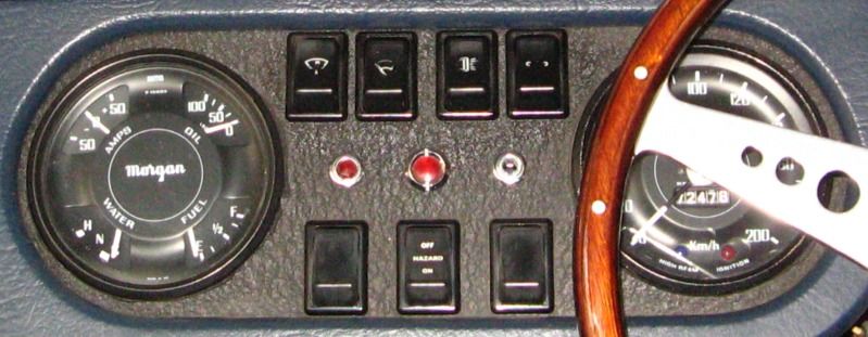

Will be starting the dashboard replacement soon and it has ocurred to me that I have never seen the centre warning light on the dash light up and I haven't a clue what it is for. frown2
Also the two unmarked lower switches which don't appear to be connected ooo
Car is '75 4/4 4 seater. Can anyone shed some light? Thanks.

Centre warning light is handbrake warning light on my '76 (I'll have to double check that smile ).
Switch layouts vary, but I have the same 7 switches with the Hazard lights and heater fan in the same position.
The two unused switches: one would be wired for additional drive (spot) lamps and the other? Was going to use my 7th for rear fog lamp, but I would have to find somewhere to mount a warning light...
Cheers,
Thanks Graham,
in mine the left one of the three is the handbrake warning light!........so many variations!!!!

Not sure but does one of the switches turn on some sort of immobizier? I used to own a 1975 Plus 8 with a similar dash layout to yours and can remember going to France and switching this on overnight and then forgeting about it the next morning. I tried to start the car with no success, the engine turned but would't start until at the point of the battery finally giving up I looked at the dash and wondered why one of the switches was pressed down. And then it dawned on me! Worth a try.

That's an aftermarket fit Paul.
Sensible to put it with the other switches - the first place a tea leaf would look is for one tucked up under the dash...
Neil, I doubt that they all came out of the factory wired the same - and after the cars have been through several caretakers over 30 years or so, who knows how things have been modified!
