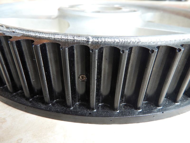

On my way to Thrill on the Hill 2014, I heard noise from the driving belt at low speed. The next day, at the celebration of the 100th birthday of the Pickersleigh Road Factory party, I had the opportunity to discuss about that with some other owners of Three Wheeler. The wear of the rear wheel aluminum sprocket seemed responsible of the noise.
On my way back to Belgium, I took an appointment with my dealer Brands Hatch Morgans to have the sprocket replaced in September. They had to cancel it, because the part was unavailable at that time.
I try my chance by sending a letter to the factory to claim a warranty replacement. Its now an open secret that some have got some and even for happy few steel ones. Thats incredible how the post services are bad in England. My letter must have been lost, because I didnt receive any reply from the factory.
I was again being left alone with the problem. Till the day I met with a friend who is engineer. He told me that one can be done in far better quality materials. With the help of sophisticated computer programs, the design and all the calculations for strength were done. He opted for top grade of steel with an additional finish treatment to increase strength and smoothness. By the same way he decided to lighten it as much as possible to almost match the weight of the aluminum standard sprocket.
It took time but the final product seemed to me outstanding by the incredibly high level of quality and finish. I put it back to my Three Wheeler. I went to Brands Hatch Morgans Breakfast Club of 18th of July by doing five hundred happy miles in one day. The sprocket looked as I hadnt done any mile with it and as it would last forever in silence.

As the construction calculations have been done and the sprocket has been used successfully: any possibility for others to purchse one?
I hate the squeeking noise from the rear and would spend a couple of to solve the problem

Im pleased that you like the sprocket designed by my friend. The choice to reproduce it or not belongs exclusively to him. I know he is still working on it to improve the design a little further and to save more weight as well. So if there are other ones, theyll be even better than mine. But all is linked to the time needed to manufacture them and to the price. Anyway, I guess it cant be more expensive than the standard product.
Before we decided to have one produced, we had a close look to what was needed and what was available. By reading TM quite often, I knew that there were some options: trying to adapt a HD 1.5 rear sprocket or to choose to have an aluminum sprocket converted to polyurethane by Super Max. In both cases it was a question of number of teeth, 65 instead of 66 and for polyurethane, it has no flange on one side. With the NVH system, the belt is always moving from one side to the other. We even investigated for stronger grade of aluminum. But in the end, steel was the best choice. The front pulley in steel didnt wear on any Three Wheeler. And it saw the belt more often than the big one. Moneywise steel is finally a lot cheaper because it last longer. I cant say how long. I have been stopped in my attempt to do a lot of miles by a big electrical short circuit. The 50A fuse and a 15A have melted down. The Three Wheeler refuses to start anymore and will be brought to BHM in September for repair.

Interesting comparison to the new standard steel sprocket

The target was to match Morgan price for steel, which is +/- 750.00. The margins are very scarce for a higher level of weight, quality and better finished product.

The special steel sprocket in its last reworked version should only be 1lb heavier than an aluminium one. For 2012 versions, the sprocket come exactly at the same place than the original. But it can be wise for a question of tyre clearance to upgrade to the later black model of hub. The report of Calum (RedThree) can help somewhat to understand everything.

MMC Steel : 13.2 lb = 6 Kg
MMC Alloy : 6 lb = 2.7 Kg
Light Steel : 7 lb = 3.2 Kg

That's right. When I sent the pulley to Super Max, it came back weighing in at 4 lbs 12 oz. with a built in wheel side flange.

The mass is not the most crucial paramter, it is the moment of inertia that is most important for a wheel.
The further the mass is from the centre of the wheel, the more influential it is. This is governed by a square rule. There is therefore much more interest to me in reducing the amount of material near the rim than ornately removing material from the spokes near the axle.
In this sense the plastic refurb jobs become more appealing. As the outer material is less dense
back of the envelope calculations tell me that for a uniform sprocket, it has half as much energy in the form of rotational energy over and above what it had from its travel in a straight line.
The fact that these sprockets have most of their mass on the outside means the figure is likely to be greater. But its hard to tell without the cad file.
Anyone who is into pedal bikes knows that the shape of aluminium items are very different to steel even though they do the same thing. I see these steel sprockets have thin spokes and there fore must have a higher proportion of their mass on the outside.
hence the added weight of steel preludes to a much worse problem of weight distribution.

All that has been taken into account in the design process. The sprocket has been drawn on computer with very sophisticated and accurate programs to avoid any weakness. It can match all the characteristics of the engine through the gearbox ratio. It's still possible to go further in the weight reduction and kinetic efficiency, but at what cost? You have to opt for a good balance!

Re: High grade of steel specialy made rear sprocket - 01/11/15 04:00 PM
Well SORNED it yesterday and ripped it to bits today for the big winter clean and service.
Rear pulley off so it can be shipped to Supermax in the near future.
7500 miles and the teeth are almost 50% worn out.
Posted By: planenut
Re: High grade of steel specialy made rear sprocket - 01/11/15 08:54 PM
Agreed, pretty worn. A new pulley will work wonders. I bet the belt still looks like new.
Posted By: Dab of oppo
Re: High grade of steel specialy made rear sprocket - 01/11/15 08:57 PM
Sure is, it's like new.
Re: High grade of steel specialy made rear sprocket - 07/12/15 05:57 PM
From this:
Description: to this:

Posted By: Fabi0000
Re: High grade of steel specialy made rear sprocket - 16/09/20 08:14 AM
Hello Everybody,
Here some pictures of the 4th first sprockets sent today morning (these made before the machine failure).
Here you can see one after machining
And here the packaging
The 4 last ones are in manufacturing, after that they will go to the treatment. I expect to receive it in 10 days.
Posted By: R1NGA
Re: High grade of steel specialy made rear sprocket - 16/09/20 08:32 AM
Great pictures Fabian - as I said in one of my original posts, I was close to mounting the sprocket on the wall to look at instead of to the Morgan to make it drive, so lovely are they to touch and feel :-).
Posted By: WilsonLaidlaw
Re: High grade of steel specialy made rear sprocket - 16/09/20 09:05 AM
I hope nobody shoots at the boxes en route as happened to my first one from Fabian. It arrived with a number of bullet scars on it. You can see the rim actually melted and distorted, where the bullet struck and there are shock cracks radiating out from the strike point. A number of teeth were also struck and Fabian feared that they could have stress cracks in them so replaced the whole sprocket.
Wilson
