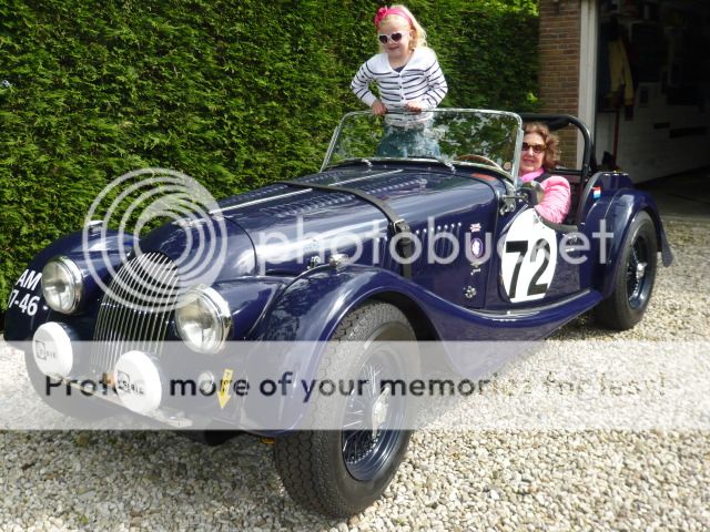

I run Vredestein 185/80R15 on my '59 +4
Clearance under the finned sump 12 cm ! and under the Mossbox
13cm ..............perfect !

Very nice I like that blue, and really like the Bumper/ light bar is it fitted to the chassis and could it be used as a tow point?

Nice car Ruud.
The 185/80R15, according to the tyre size calculator, has a radius of 13.32in or 338.32mm. That is 31mm more than the radius of the tyres currently fitted to the Plus 4. No wonder you have 13 cm clearance by comparison to my 9.5cm (measured under the cross brace under the rear of the gearbox)
