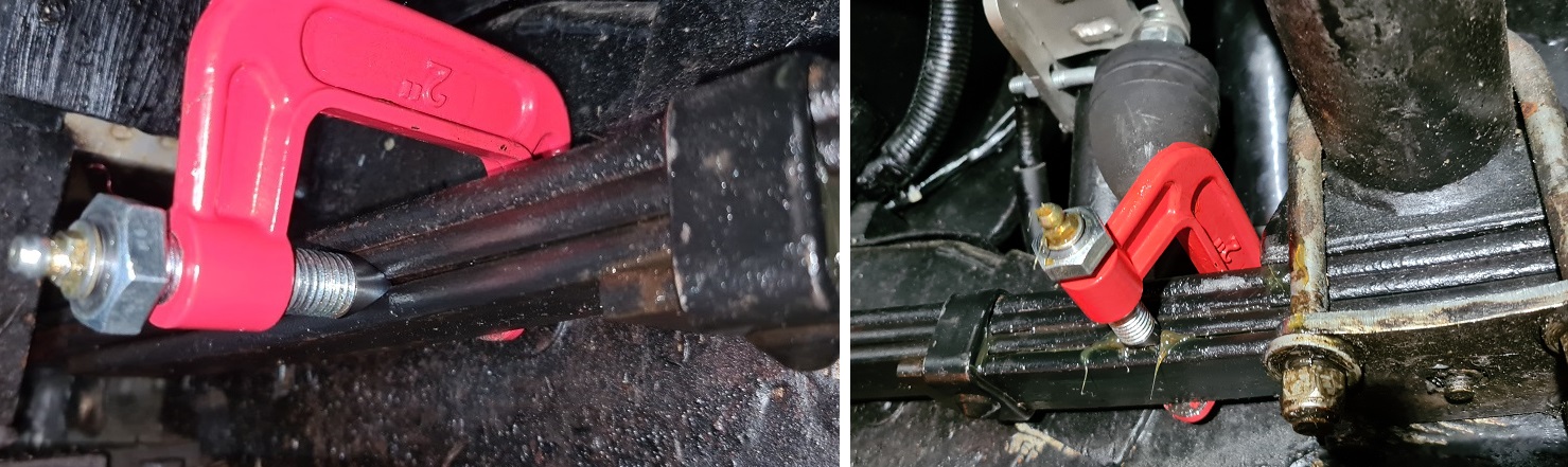

Despite having well oiled rear springs they both squeak. The squeak or creak comes from the tightly clamped leafs right next to the u-bolts where any lube seem reluctant to penetrate. Backing off the u-bolt torque will stop it but obviously that’s not a solution so today I’ve knocked up a greaser.

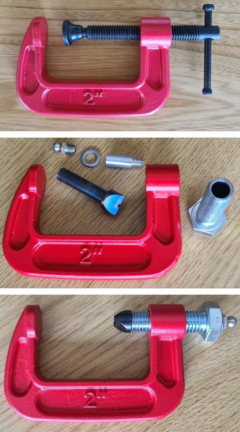

I’ve seen antique leaf spring greasers before but they are usually too big for the tight space in a mog. This one is bodged up from a butchered g-clamp, a bolt and a hardened tool steel spike.
A quick 2 minute test out this evening but I think a rainy day job to methodically work through both springs.....
