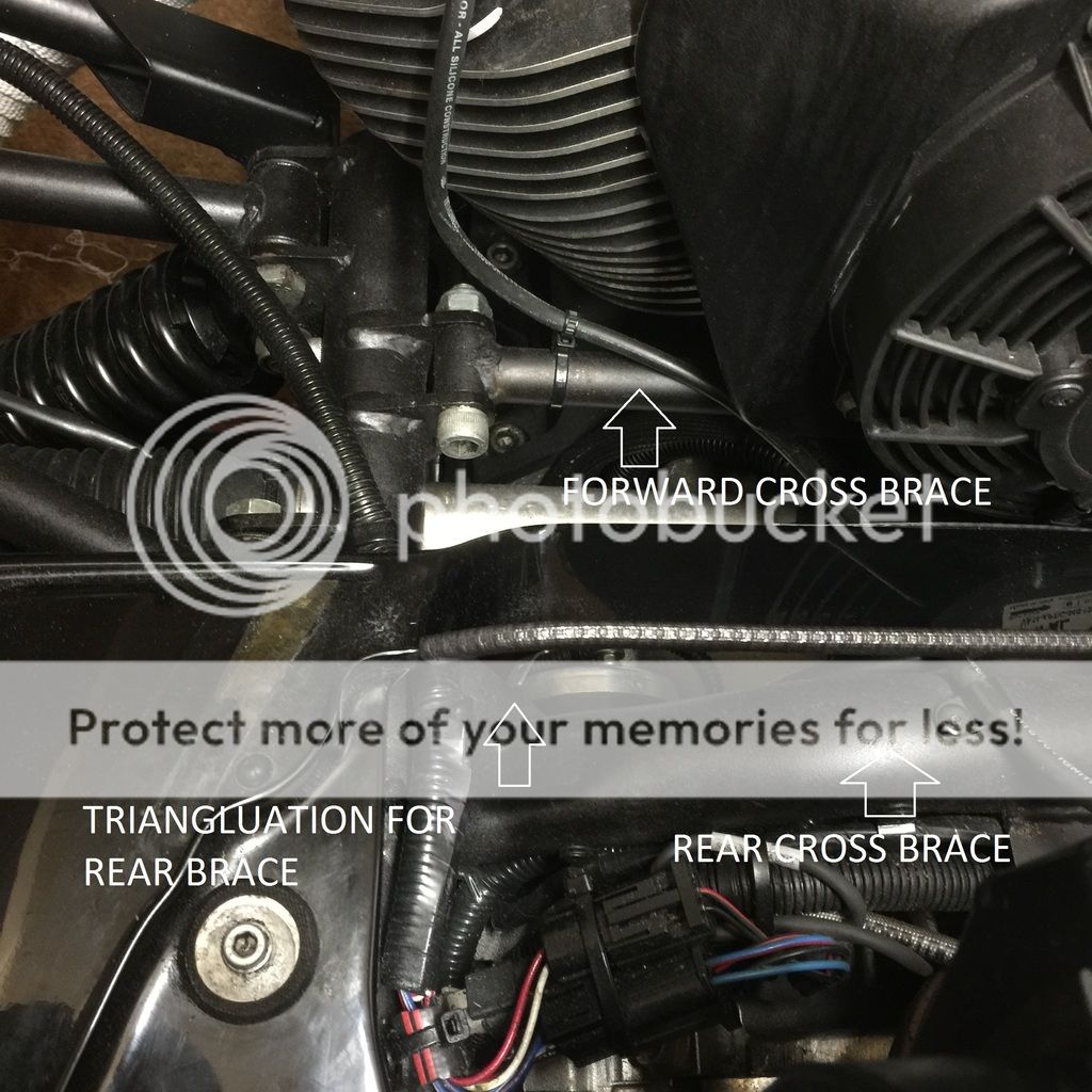

Ah I see now what they are doing. There are two different mods, a welded in version and a bolted in version.
IMHO, a much better mod if you don't want or need to fit the cooling fan would be to retain the side to side bar but add the A frame bars, as that would tie the whole thing together much better. This would be a bit like the strut braces I have on my 911 RSR, which as well as tying the two strut towers together, has separate braces going down to the centre of the front floor pan in the luggage area - see not very good photo below (this was taken on Scottish Malts Trial to show how every cubic inch of the luggage area was full of stuff at the start of the rally.

Hmm I wish I could understand how those bolt joints can effectively transfer the transient forces which start cracks.
About a year ago I demanded for triangulation to be added to my car. Its been working well. As the first retrofit, it has thicker piping than these examples and required some bits to be changed.

This is the arrangement on my late 2013 car - is there any differences between this and 2014 , 2015 cars?
At risk of post drift , I would like to understand what the 'current' arrangement is - any pictures from owners of recent models please ?
