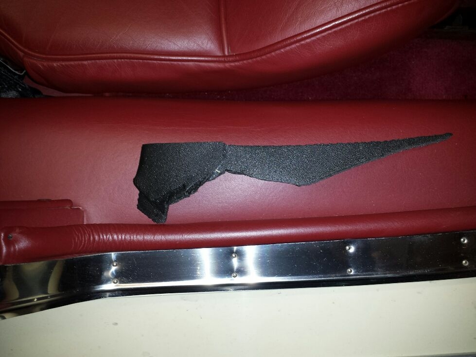

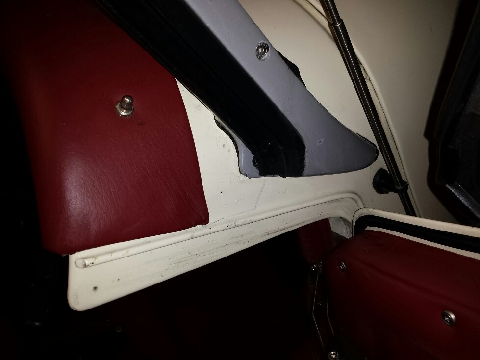

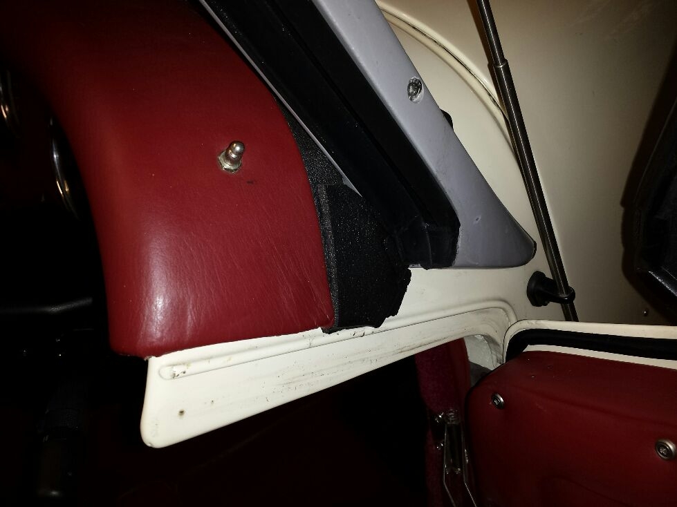

Re water spouts
The daft gap above the door is the culprit I have shaped neoprene inserts that plug the gap between panel and sidescreen

No the a pillar spout
Easily removable when side screens not in use

I'll have to do something like this on the drivers side. I might leave the pax side as its too much fun to watch my wife getting an intermittent soaking smile
