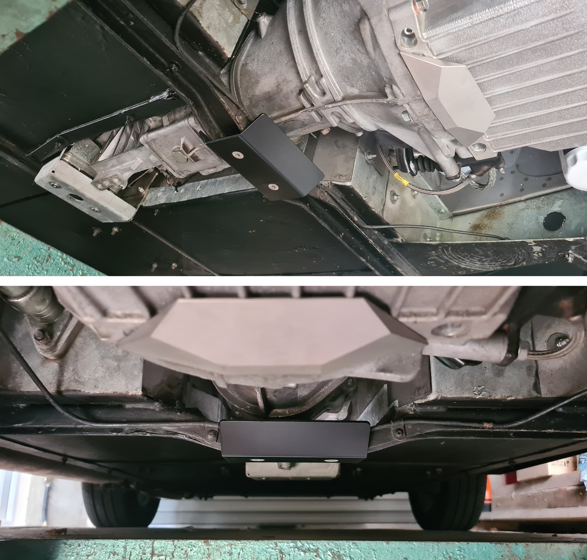

Originally Posted by DaveW
The angle of this shot makes it look rather level, but the bellhousing is slightly below the crossmember.
I fitted a Wolf/BHM skid plate to my Plus 4, but here it wouldn't do much good.
There’s not that much difference Dave but the Mazda box makes that horrible step. Dread to think what the wrong size metal post would do if it were to make contact.
I’m rather hoping the improved aerodynamics will offset the fuel overhead of lugging the deflector around grin2

Looks very neatly engineered Roger thumbs

Thanks Jon smile

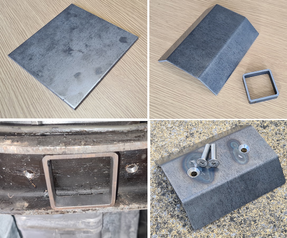

So another bit of undercarriage clutter added that might be better suited to the ‘what have you bodged today’ thread. Contrary to this thread’s title I’ve now joined the skid plate club and reduced my ground clearance, just a little.. I’ve become a convert as bolting a thin skid hard up against the cross member only actually loses 4mm clearance and it’s really not that heavy to lug around. It might just save the car from a bit of damage one day or even stop some random debris bouncing up and damaging that exposed brake pipe.
Bashed into shape form a 150x150x4 piece of steel plate off ebay for 6 quid and a little slither of 2” square section from my scrap box tacked on the back. Fortuitously the section fitted snugly inside the folded cross member, hopefully it will help take any impact off the fixing screws.

Nice work Roger
I have approx 100mm clearance to the skid plate

Thanks Craig. I’m around 95mm. You probably have a bit more than that on the road. I bet those wheels would have sunken into that sumptuous garage shag pile smile
