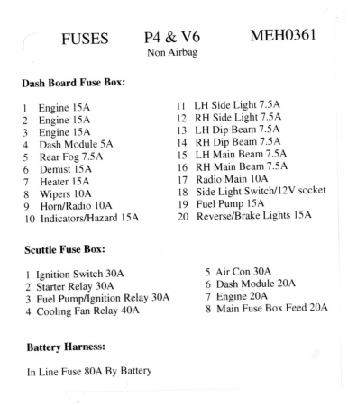

Fuse box card 2008 for Plus 4 and Roadster
Here is the fuse box card for 2008 Morgan Plus 4 and Roadster.

Soleg,
thanks for your post.
I have a 2004 +4 is the fuse layout the same?
Perhaps you could let us know where you got the information and then I could make a copy.
It is very useful information.
All the best
Tony

Hi Tony,
The fuse box card came with the car when new. It is a small laminated card onto which a fuse removal tool was fixed with gaffer tape. I don't know if the fuses are the same on a 2004 +4. My car was produced in December 2007 and rolled out of the factory gate on January 3rd 2008.

Hi Soleng,
Thanks for your reply, I think that the fuse layout is the same, anyway the card is better than nothing on the occasion that one might need to refer to it!
I have copied it and will laminate.

On my dads 2007 4 seater I have noticed the screen wash function doesn't work. I take it from the above it would maybe share the wipers fuse and dosent have a separate fuse? The wipers do work.
I expect it might be the connection to the little pump on the bottle or the pump it self.
Anyone know the part number for the pump?
Yes the wiper feed operates the washers as well via same fuse 8.
Likely problem areas are wash function on wiper switch, connectors, wash pump or bad ground connection on same.
Washer pump looks like Land Rover Defender one.

Try taking the pump off . It is a centrifugal pump and if not used can be blocked by gunk & algae growing in the wash washer.
