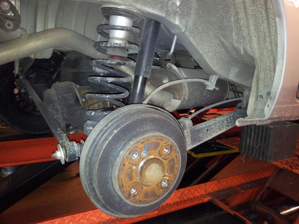

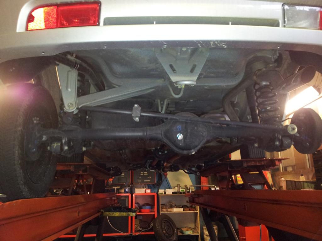

I took shopping trolley (Subaru Justy 4x4)to have winter tyres fitted and was struck by the suspension system used on the rear axle.
The Justy has a rear differential and drum brakes, similar to the Morgan, but uses a coil suspension system on trailing arms with a panhard rod.
It made me wonder how such a system might work on a Morgan.

I don't think the current chassis could take a trailing arm mounting without some strengthening. The Mulberry version I saw a couple of years ago had leading arms pivoted at the end of the chassis. Then there's no room for a coil spring of that size (above)or a damper of that length. I think there's a greater threat from the supply of a solid rear axle. We must be getting close to a point where a suitable live axle is no longer available. But a simple independant system bolted to the current chassis would be an 'untested' solution which might not bring much improvement. If we are prepared to stomach a price rise, there's no reason why an aluminium tub couldn't be made for the trads with a modern suspension system.
