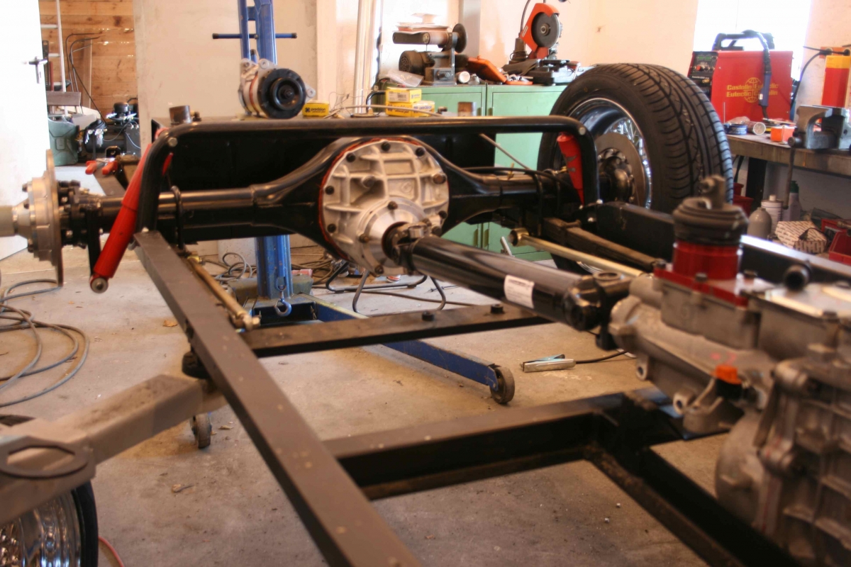

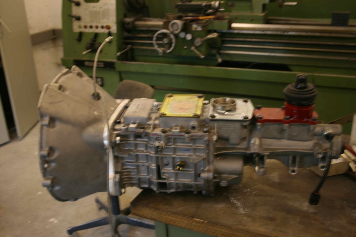

What is the hose going into the Bell housing ?
has it got an internal slave cylinder ?

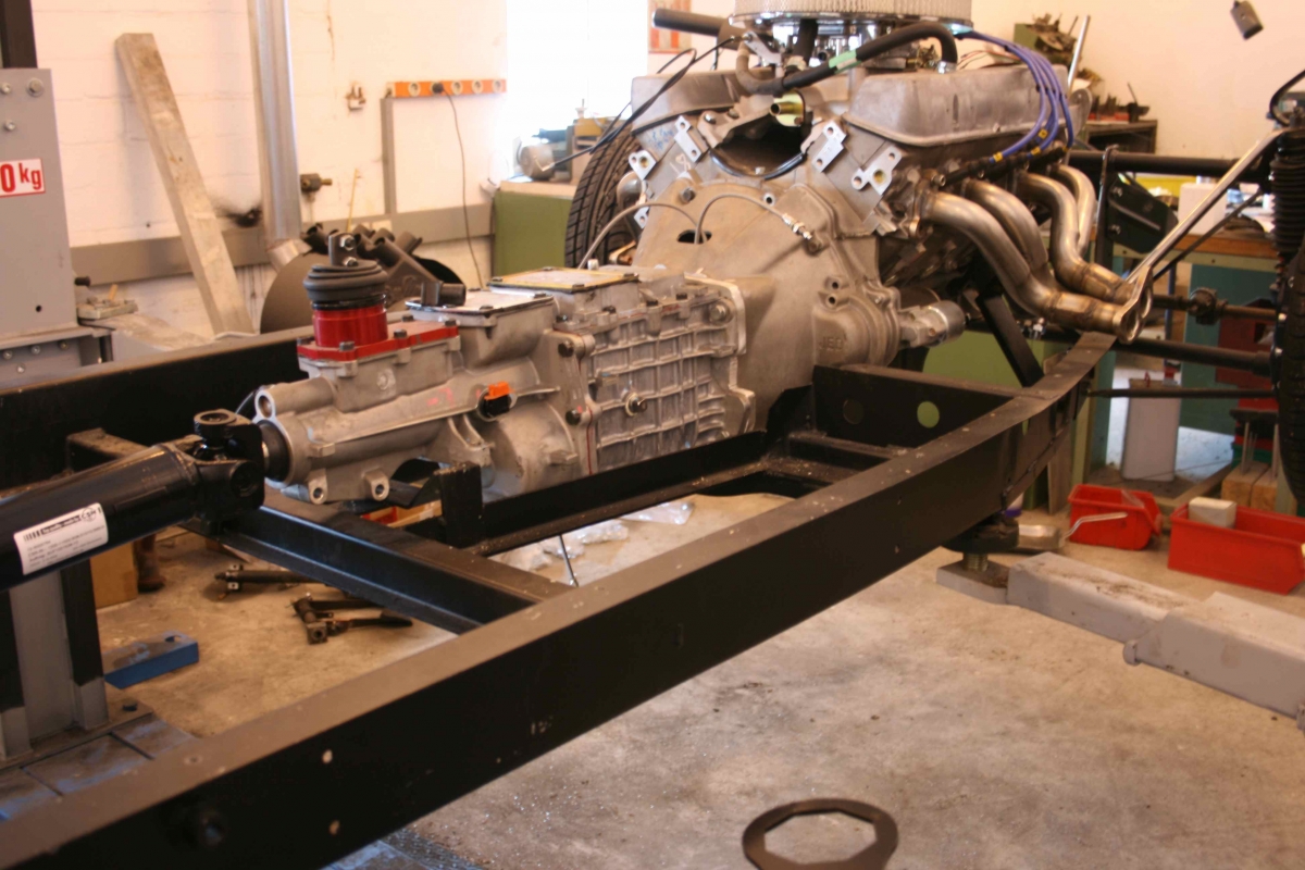

It has an internal slave cylinder, the bell housing is from JDS with a flange plate.
The ratio is very close (0,23%) to the old gear box, the 5th is 0,68 as an overdrive.
The rear axle is a Ford 9" with the original ratio and a locker.

That's certainly an interesting looking back axle!

That looks interesting why the application, racing? How easy was it to fit the Tremec gear box?

Nice lathe!

the old gear box and axle is to week for the 4.6 engine.
I must short the bell housing 20 mm to use the flange plate, make a new rear cross plate to install the gear box. It fit under the original Cover.
The handbrake is still on the side of the gear box.
The Shifter is 15 mm in a other position. It was not to difficult to install it, i dit all by myself. The gear box is very quite, and a dream to shift.
here a link to the gear box.
http://www.tremec.com/menu.php?m=103
The rear end is build to my spec. Importend is to see the offset of the drive shaft 2" to the left side and draw it in.
Here is the order form
http://www.moserengineering.com/moser/wp-content/uploads/2011/12/New-Orderform-w4-link.pdf
and here you can find all about this company
I use the Detroit Truetrac
The axle cost 3000 $
