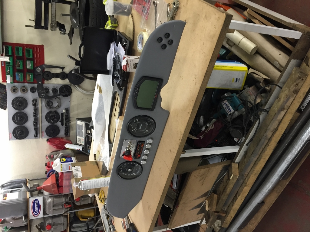

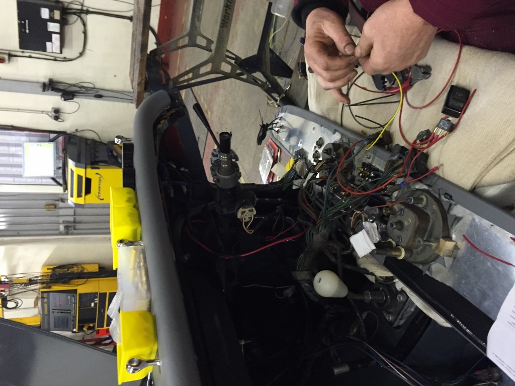

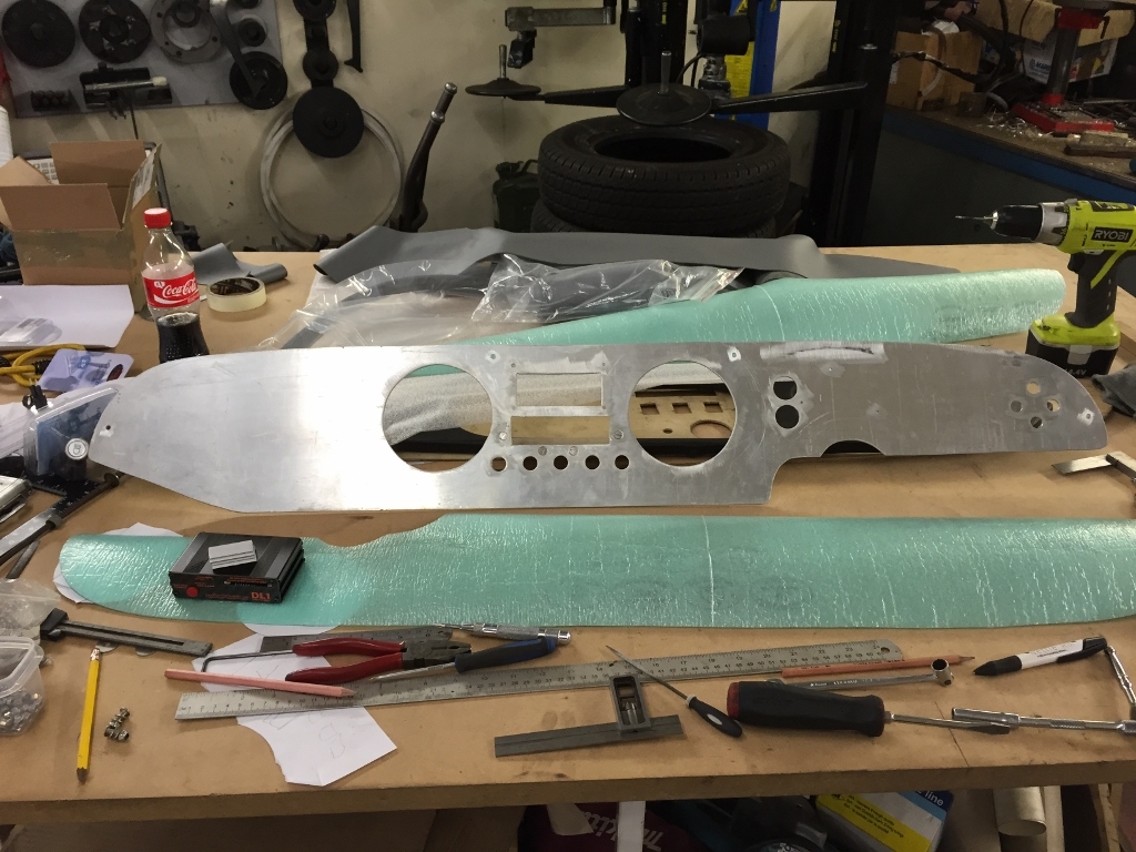

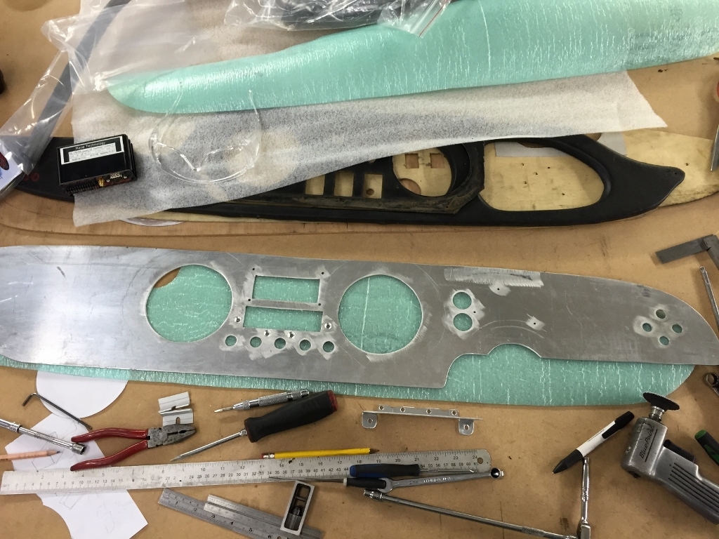

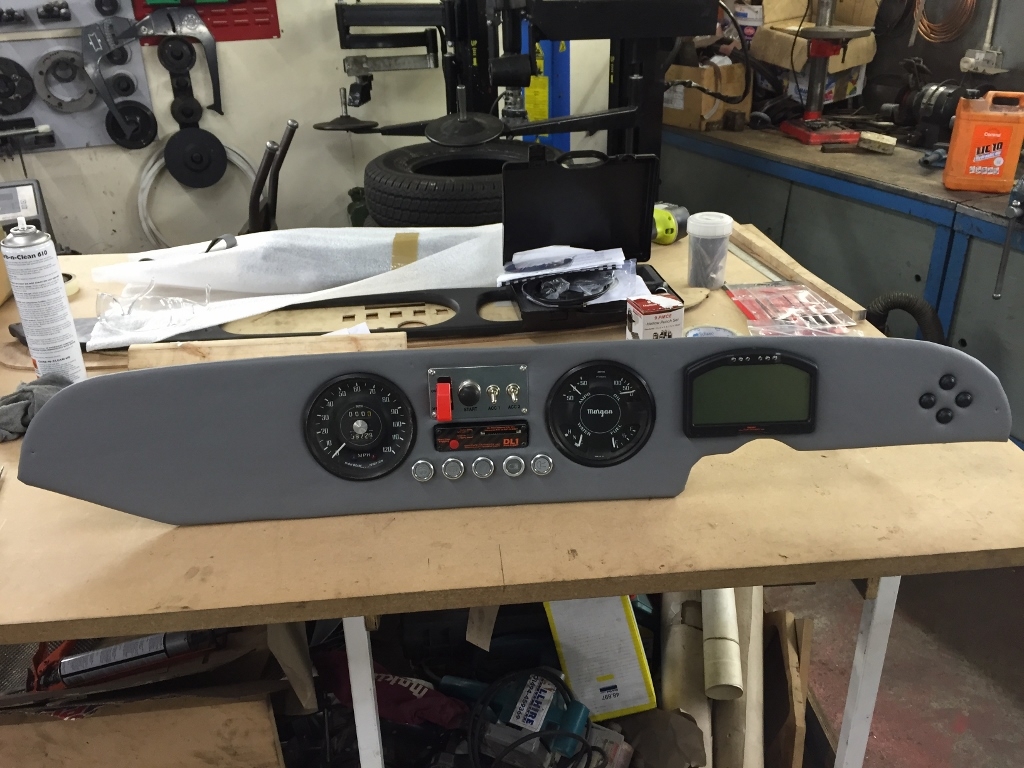

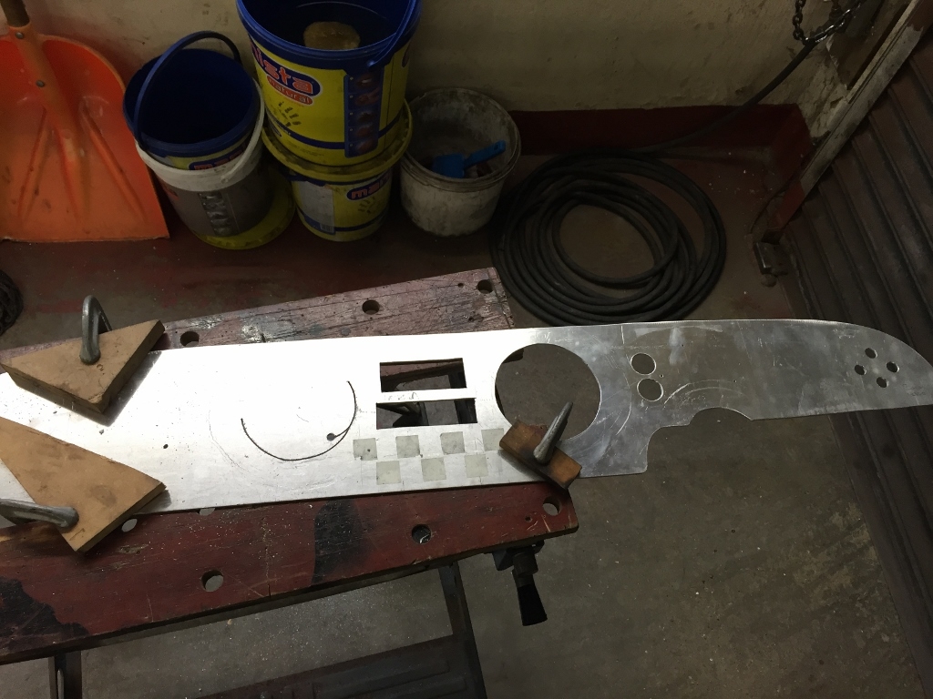

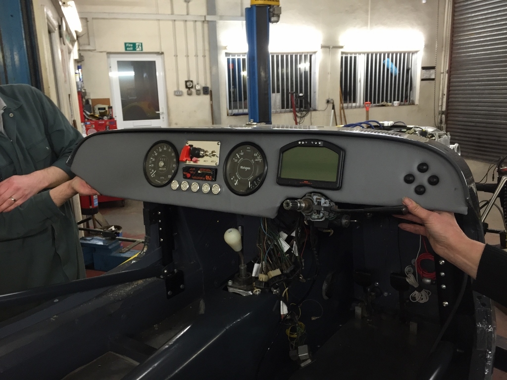

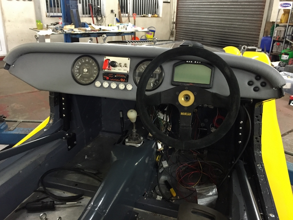

We found Woodstock's dash was snapped when we stripped the car down - it was not not suitable to be used again so I've made a new one.
With Woodstock we've decided to keep the dash more original so the old dials have been used along side the telemetry set up and digital dash display.
Also have used the buttons found on more modern Mogs..

Lovely. How are you going to use the LED/LCD??

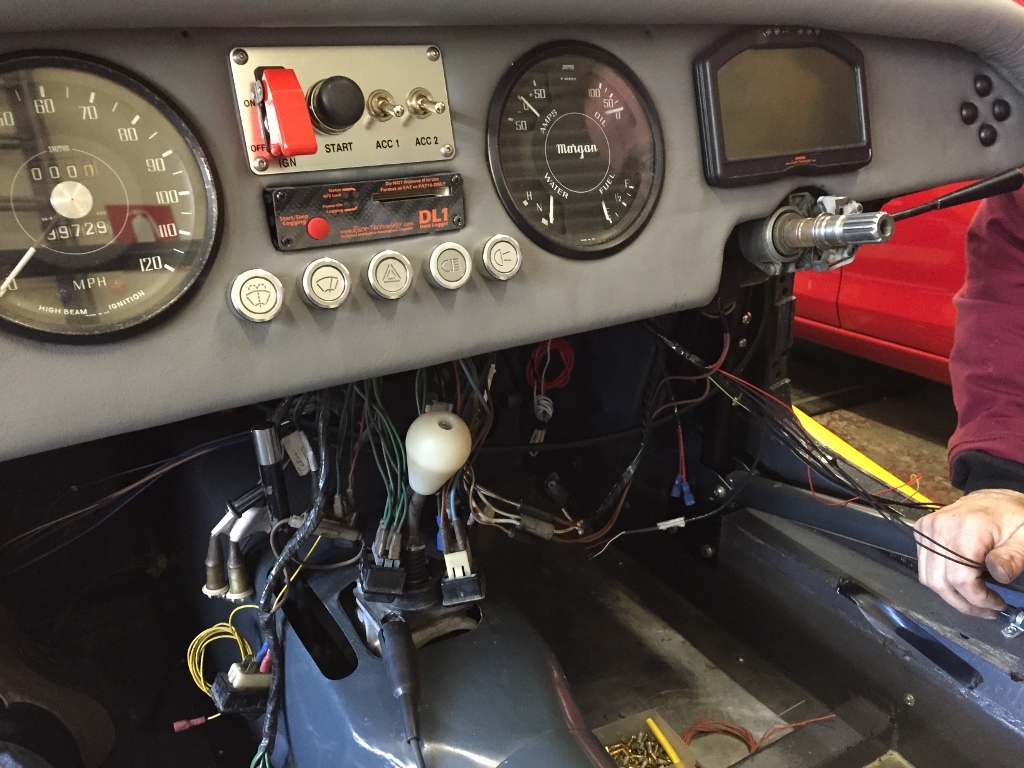

Originally Posted By MarkB
Lovely. How are you going to use the LED??
Cheers,
I'm assuming you mean the LED's in the top of the digital display.
These are programmable and I've set them to sequentially illuminate every 200rpm for the last steps to the red line. At the max RPM they flash all together. If you keep going the Rev limiter cuts in.
It's pretty easy to code up with the management software.
This dash has 4 screens all controlled by the 4 buttons on the RHS. You can display any information that the Telemetary system has (including split times and lap time predictors based on historic lap information) or any info the ECU chucks out.
The digital dash has all the warning lights required to be road legal and uses indeglo to illuminate in the dark when you turn the side lights on.
It's made by RaceTechnology

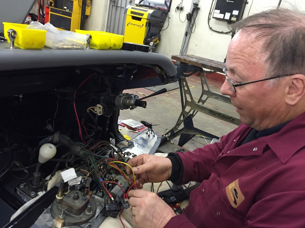

Also good to see Mr Cripps in action.
