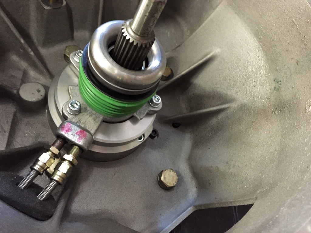

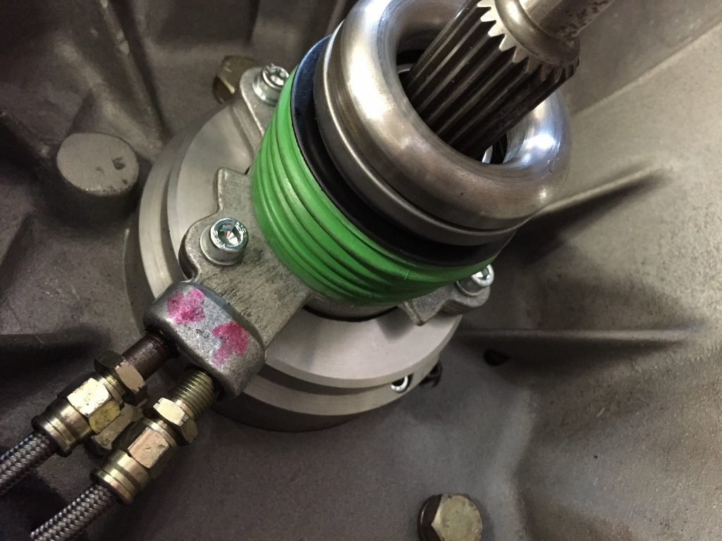

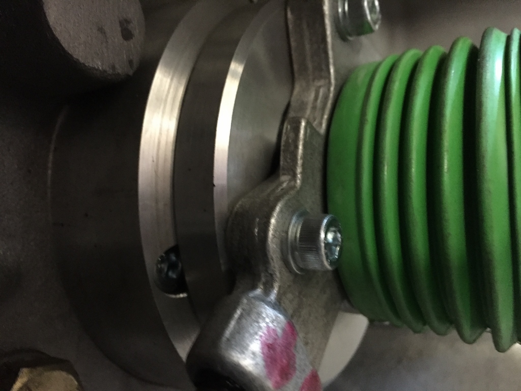

Woodstock has a hydraulic clutch intended to make the twin plate competition clutch slightly lighter for Missprint to operate. This clutch, release bearing and pedal assembly is a combination of several different kits to give us what we need.
We had to make a custom release bearing spacer to put the release bearing in the correct place in relation to the clutch fingers - not before blowing out one release bearing getting it wrong!!

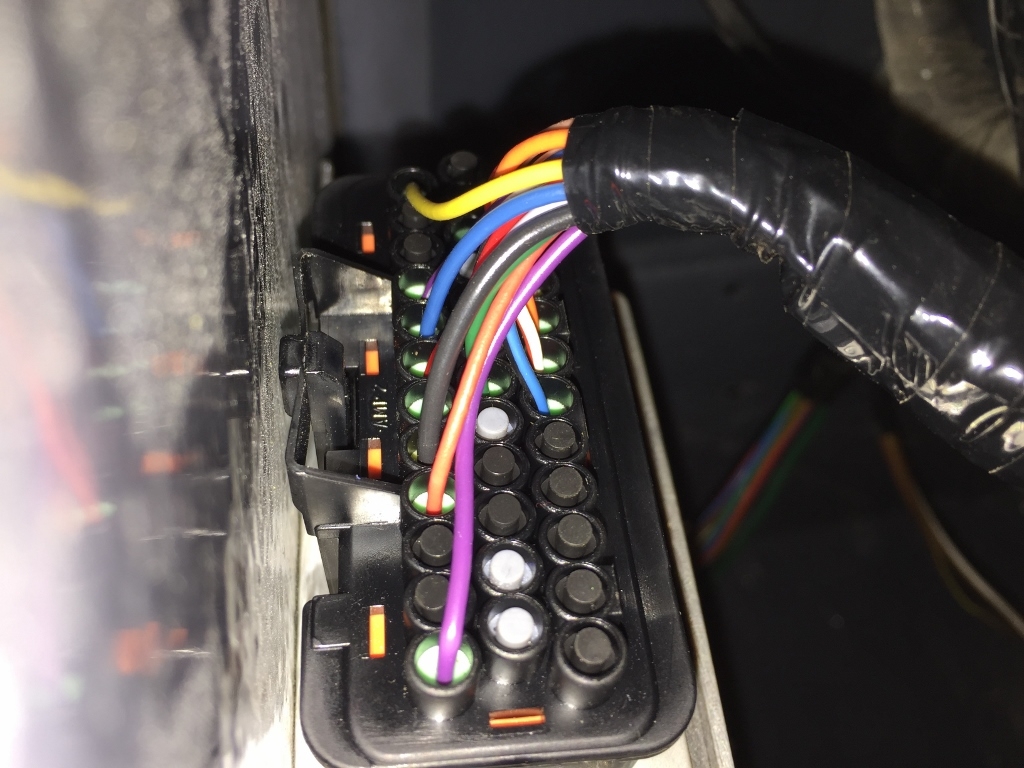

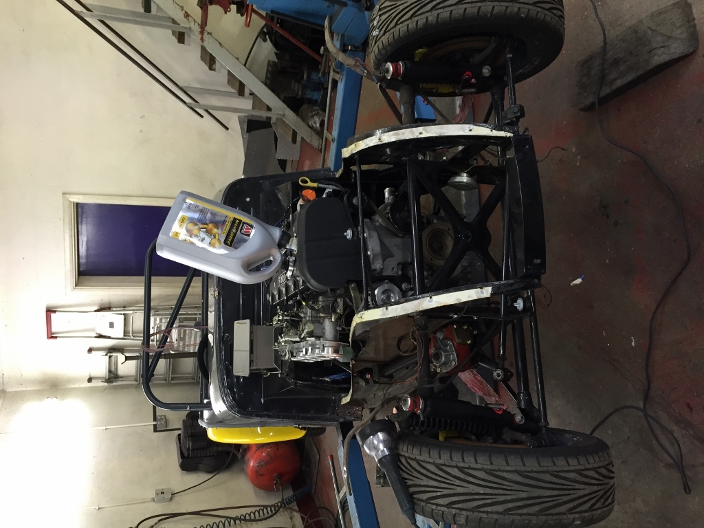

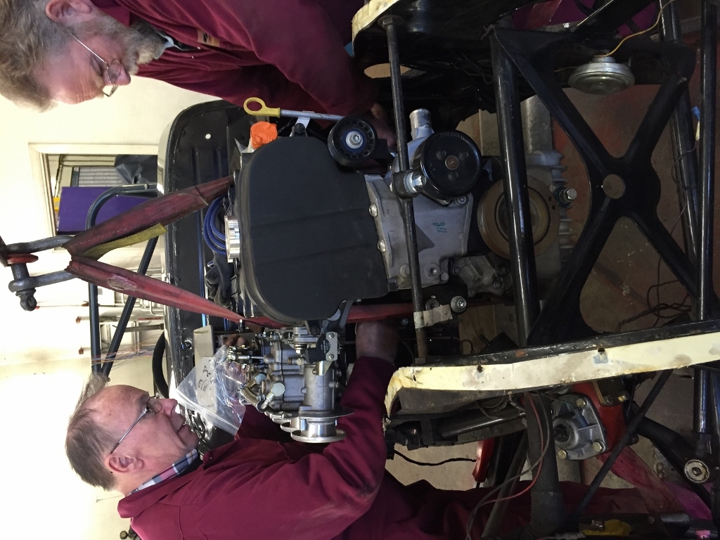

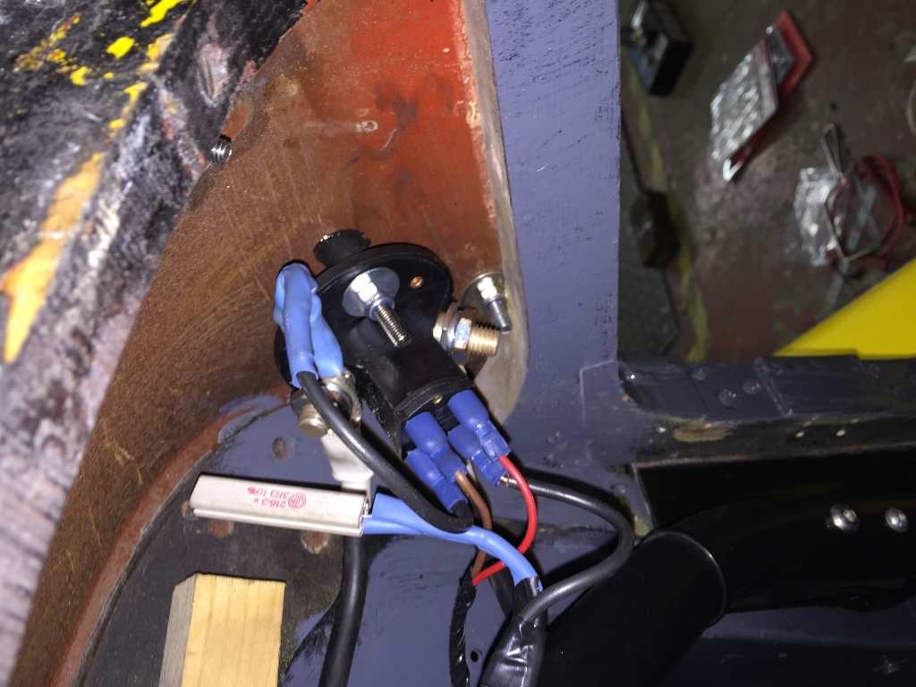

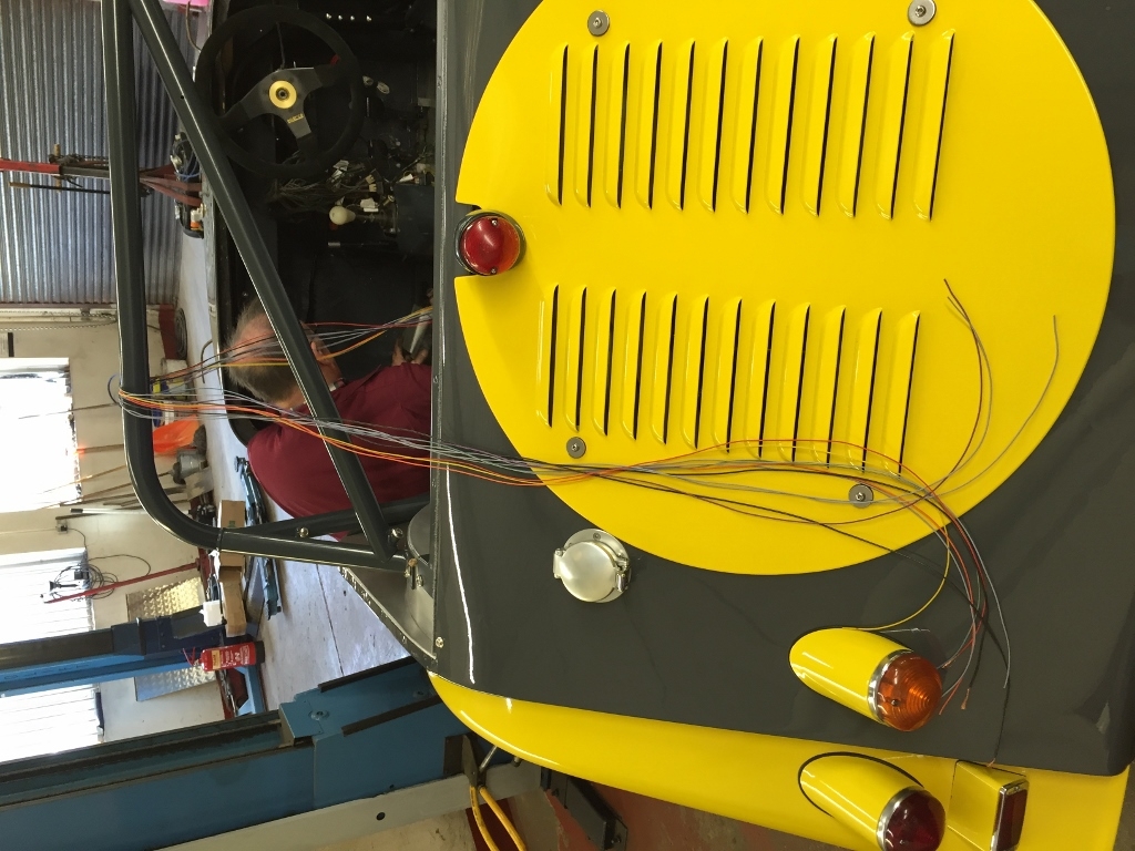

The engine bay wiring loom needed to be run into place... with a digital dash and 3D ignition system the various sensors, Crank Position, Throttle position, oil temp, oil pressure, water temp, coil trigger along with coil power all need running in.

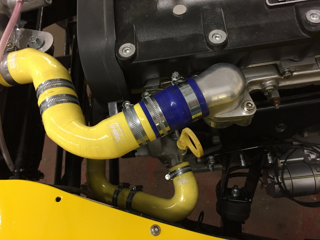

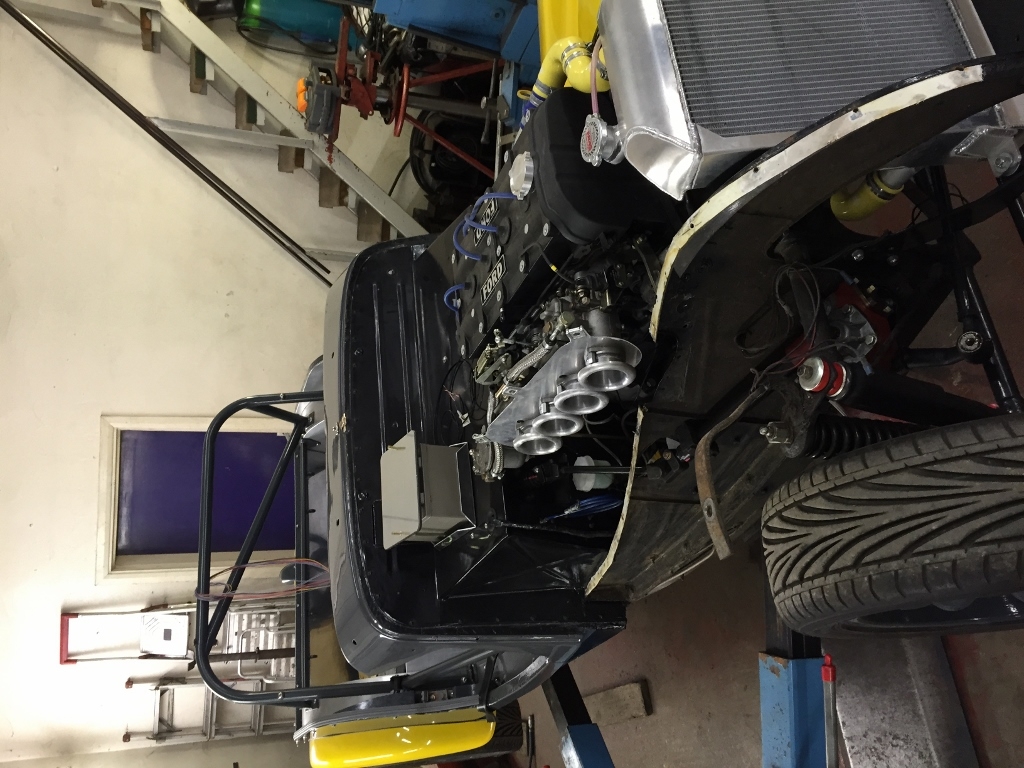

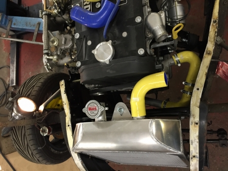

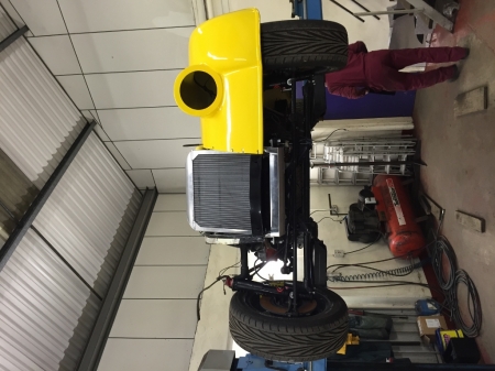

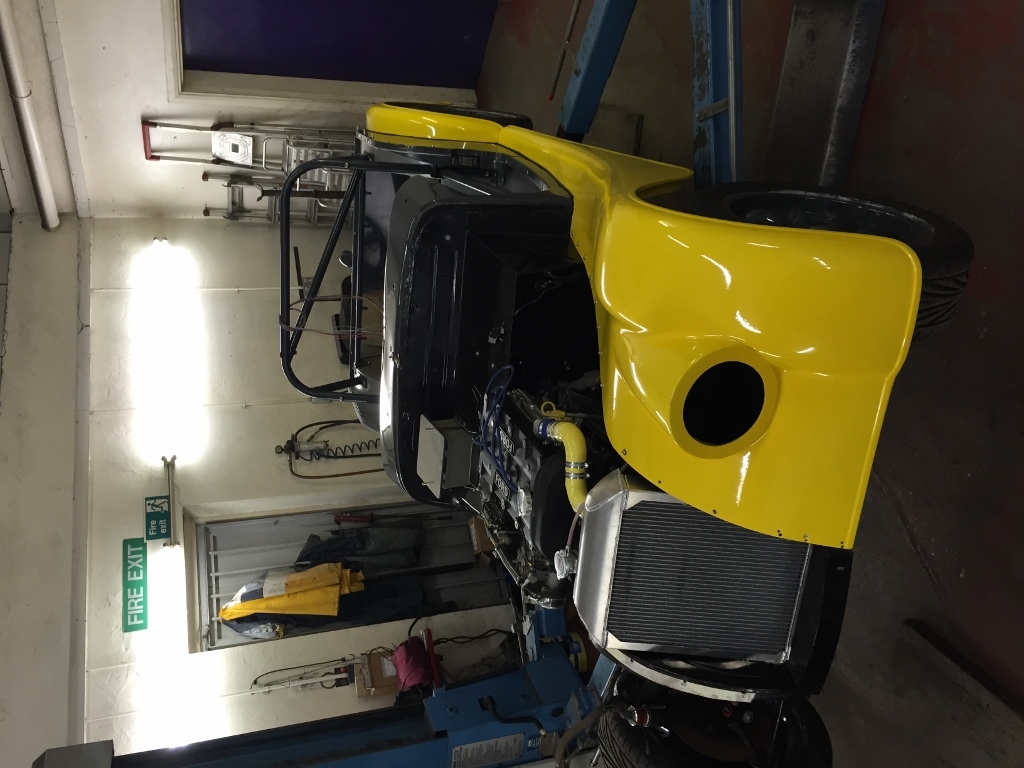

Before final fit of the wings we wanted to get all the engine bay work sorted so we're not working over the finished wings... all the coolant, oil, intake and exhaust need to be connected.

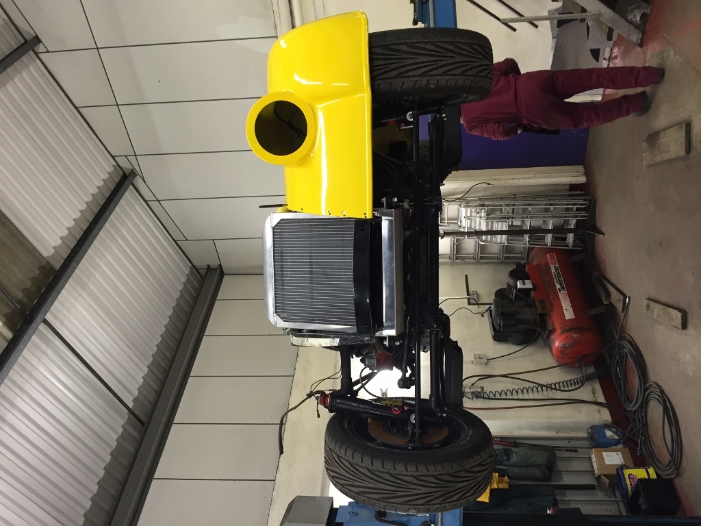

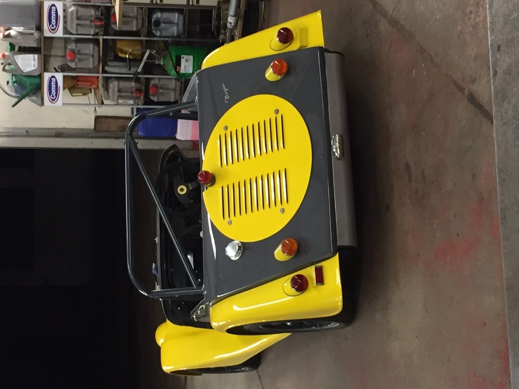

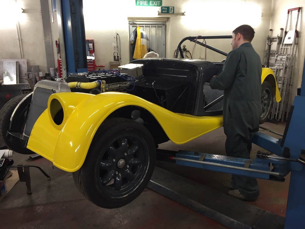

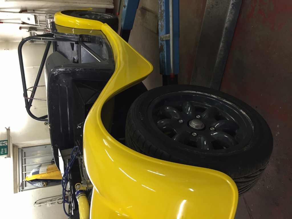

Once all that was finished the wings could be finally fitted - N/S followed by O/S.. the first fit really helped but there was still plenty to do.
