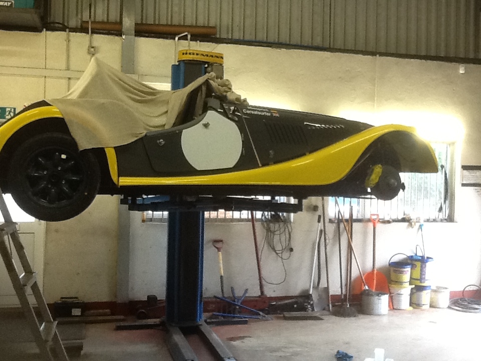

Update 57 - Snagging list Easter weekend

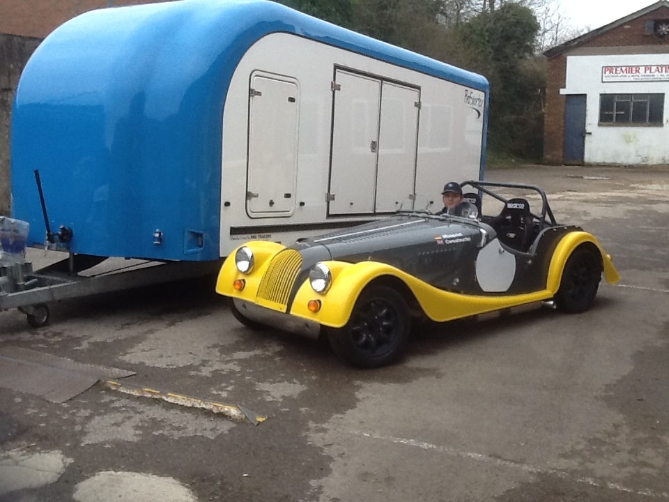

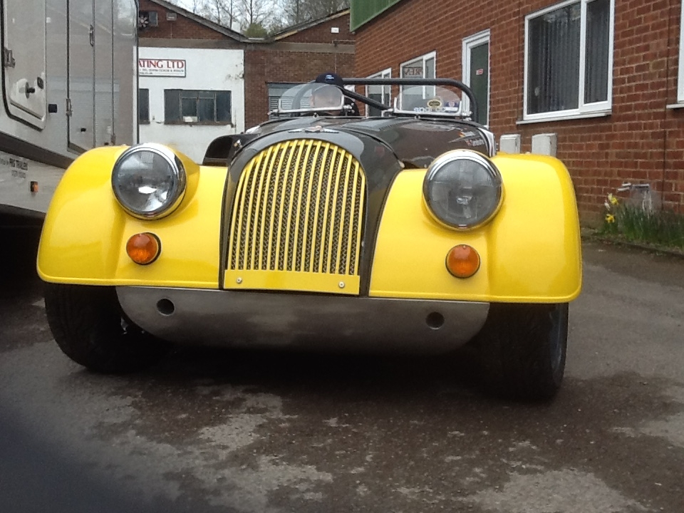

Woodstock's up and running - Easter weekend saw us sorting out some of the final snagging jobs.
The gearbox would not get 1st, 2nd and Reverse.. turned out to be an innocuous saddle bush supposed to be on the selector rod but was instead within the lower part of the shifter fork on the bottom of the stick - found after stripping out the interior, trans tunnel, opening the box up and working back from there. Initially we thought it was a mis-aligned/initialised selector fork on 1st 2nd.

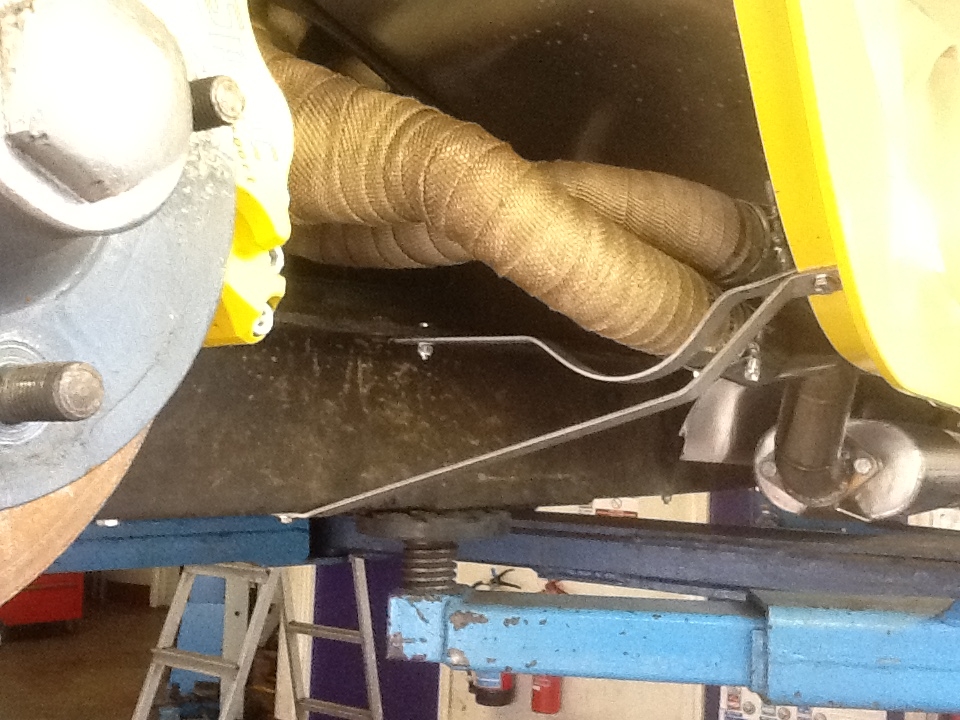

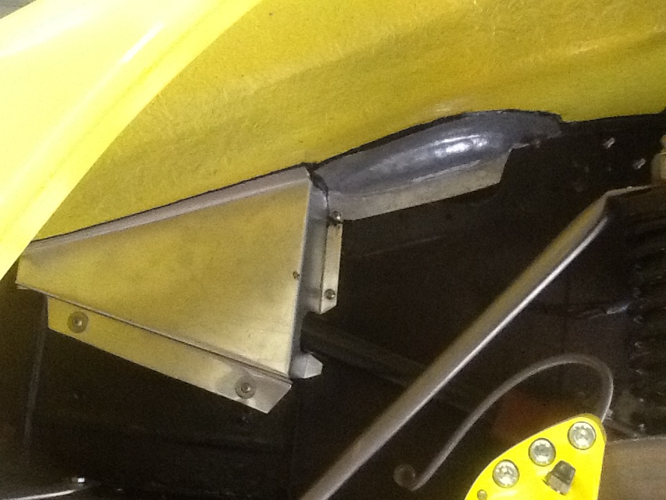

Also getting sorted final wing-stays in Stainless steel, N/S headlight wiring (looks like a broken wire somewhere along the line). Front valance fit post polishing.
