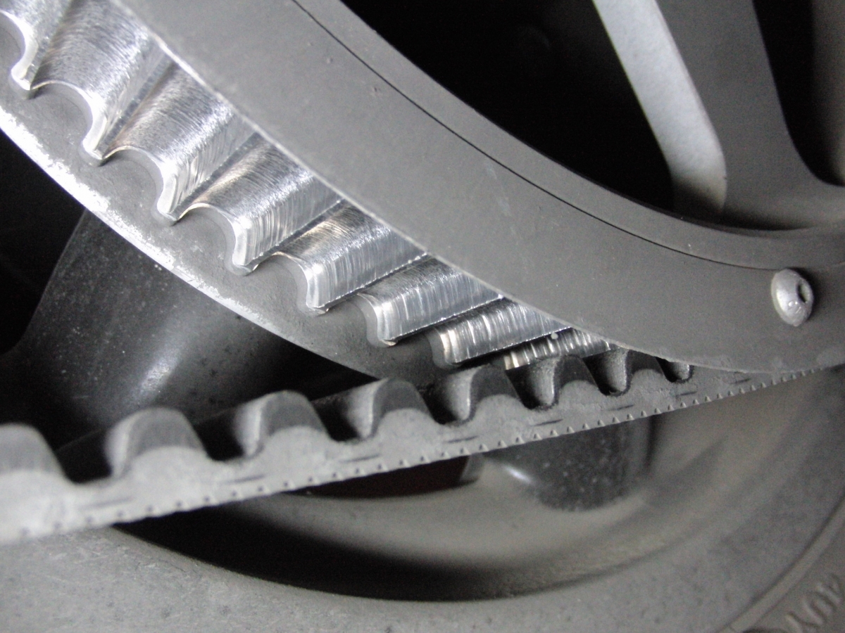

Worn rear sprocket
My rear sprocket at 5400 miles

Get yourself a steel one. They are now available!
The steel pulley weighs maybe 3 times more than the alloy version
Had mine fitted for a few weeks and it seems great

+1 Ouch that looks a bad one .....
You kept that one quiet Warbird !
Had my steel pulley for about 1000 miles now , and while I do occasionally get the odd squeek , it soon disappears - bliss.
I wonder in the drive train what the point of least resistance is now ?
Having recently spotted an oil leak in the bevel box front seal I think I have probably answered my own question.

Another +1 for the steel sprocket.
As Nippymog says, it squeaks (rather than squeals) from cold but soon quietens down.
I don't know if Morgan have these on general release yet - but they should thumbs

I have done thousands of miles on a Harley and never seen wear like that, I know the M3W is heavier but that's an awful lot of wear. Worth investing in a steel one.
