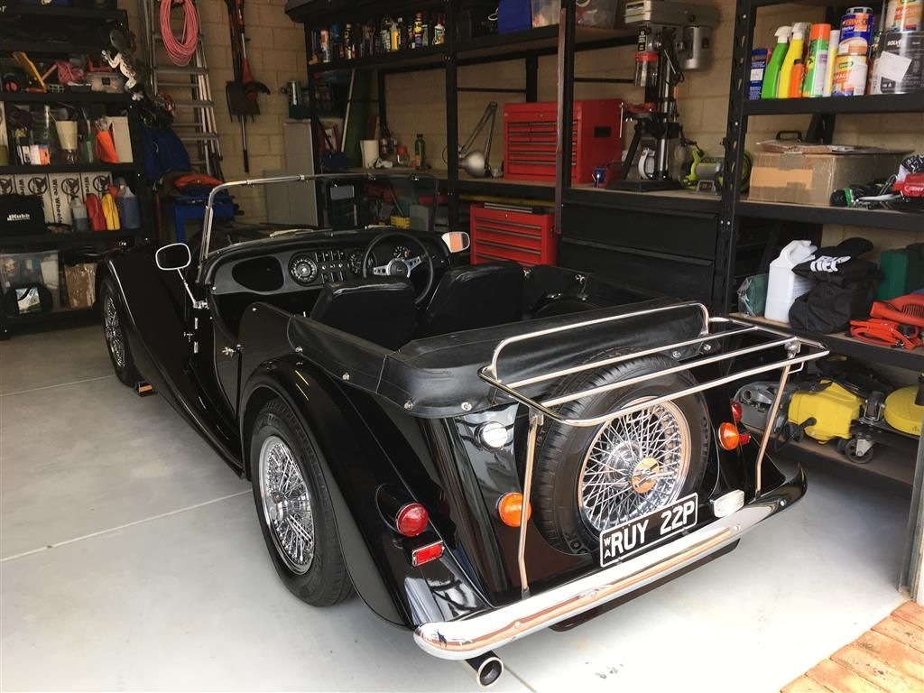

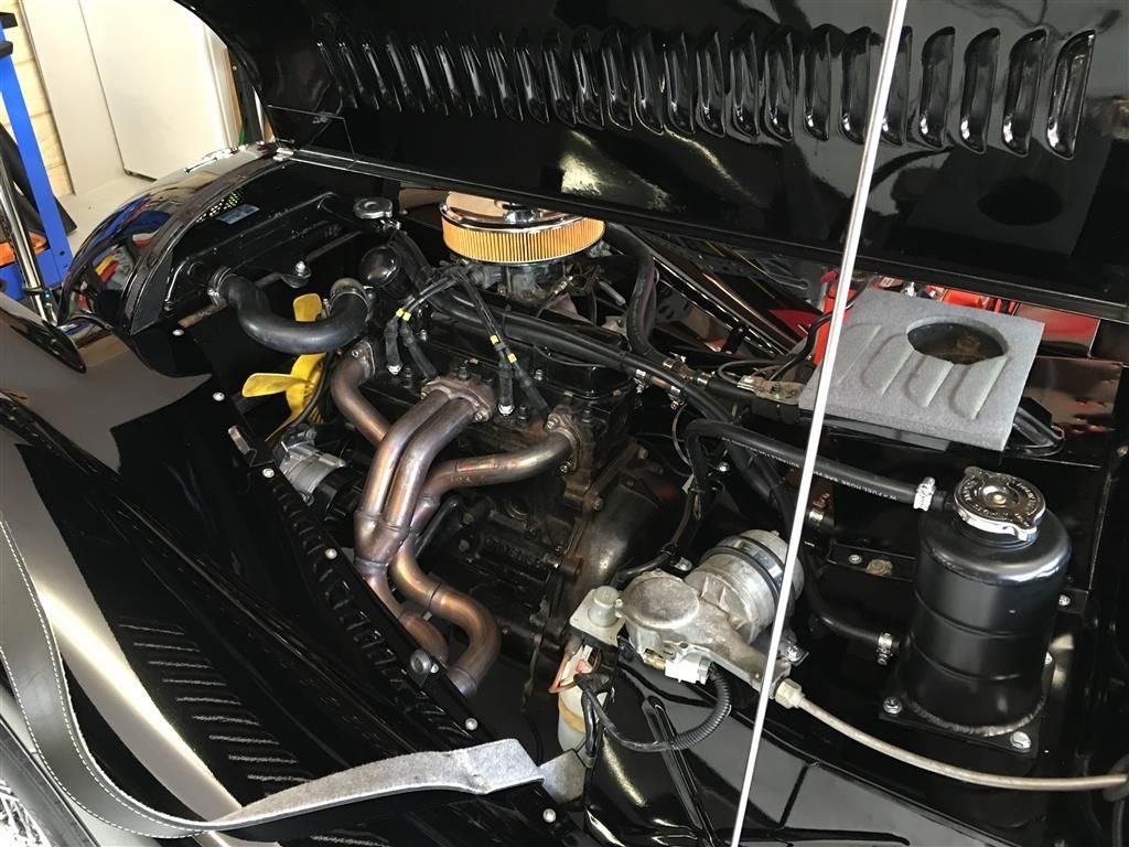

I've now compelted (*) the full service ( see here for the original post with the list.).
I changed the a little as I went on and the completed (typed) list is here. I have the hand written one in my file, but its marked with oil etc.!
I am pleased with the end result, everything feels tighter (it should I tightened everything!) and sorted the timing, gave the car a tune up etc.

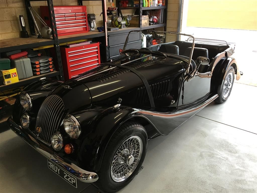

Today the run to the winery for lunch was cancelled and as it was threatening rain I washed the car (first time properly in nearly three years!).
Off for a run this evening around Kings Park.

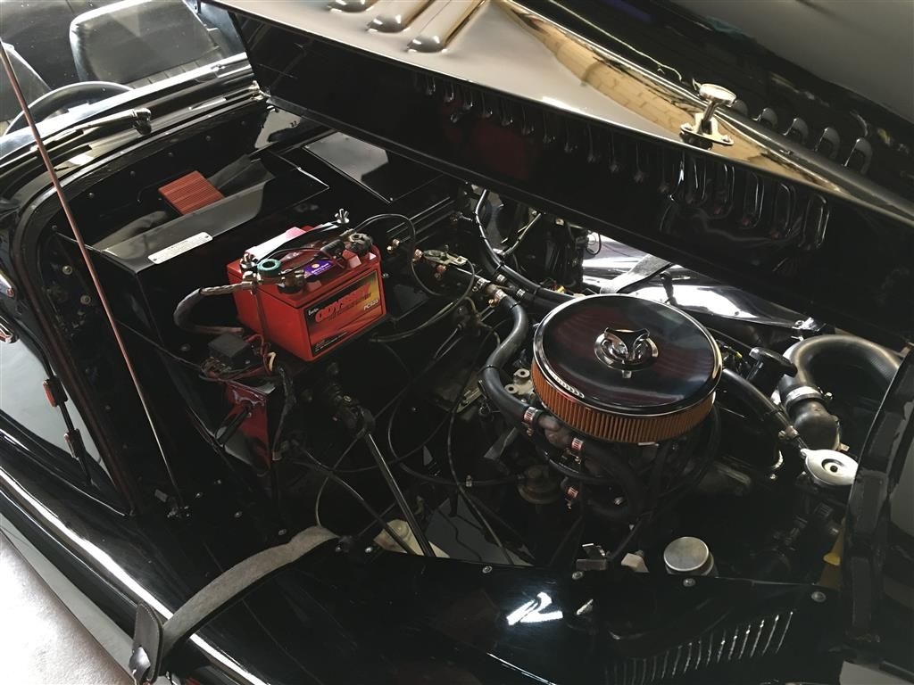

[* - new K&N air filter and housing awaiting delivery)

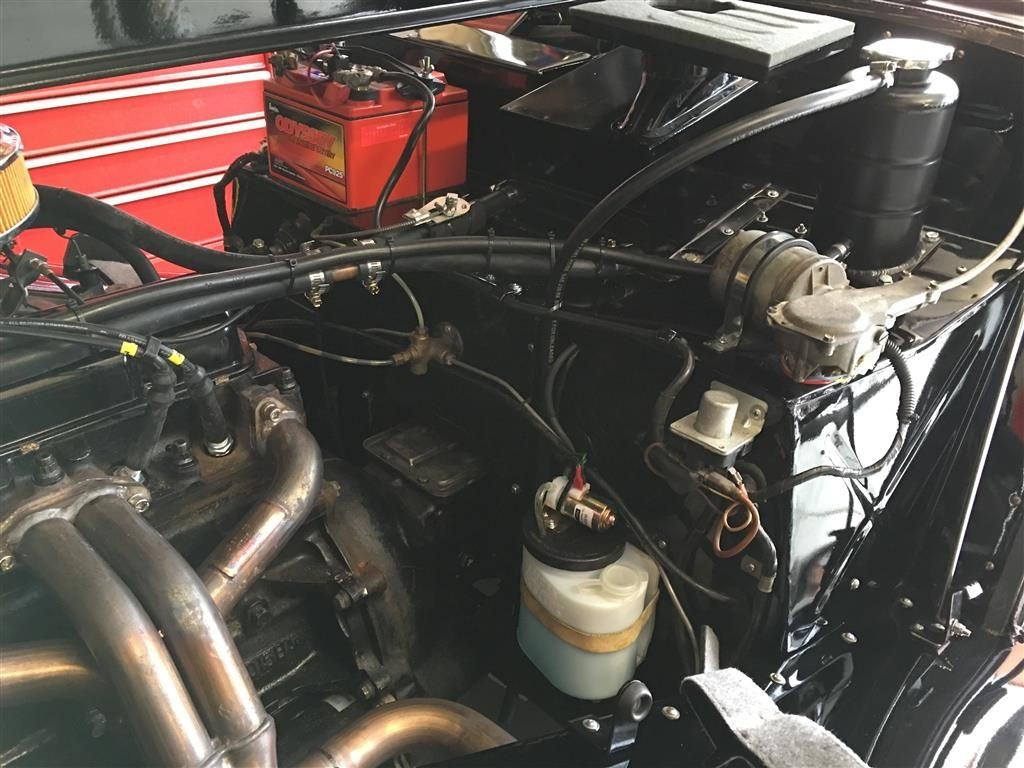

There are some vey nice details on your car Richard.
Agree the current air filter looks a bit "blingy" but I am sure the K&N will deal with that.
Have you thought about using a smaller gel battery on the bulkhead rather than risk acid escape and corrosion (or worse) over the driver's feet?

Looks very well loved.
I will go for a gel battery next Andy - but keep a close eye on this one for now.

A cracking job Richard - that manifold is a thing of form and function in harmony.
As you suggested the air cleaner is more hot rod Hemi than Morgan, the K & N will perfect the engine bay.
Nice to see a proper starter solenoid under there.
With your excessive ambients a dryfit wouldn't last five minutes, temperature kills them rapidly as it accelerates the chemical reforming process prematurely. Every 10C above 20C halves the useful life of a chemical mat (dryfit) cell, I suspect you could easily reach 40C ambient sunny.
Witness Neilda's new +8 failed within the year with very spirited driving.
Thanks.
Good point re the temps. 40 degs is a warm day in the summer - typically mid thirties in the summer....
