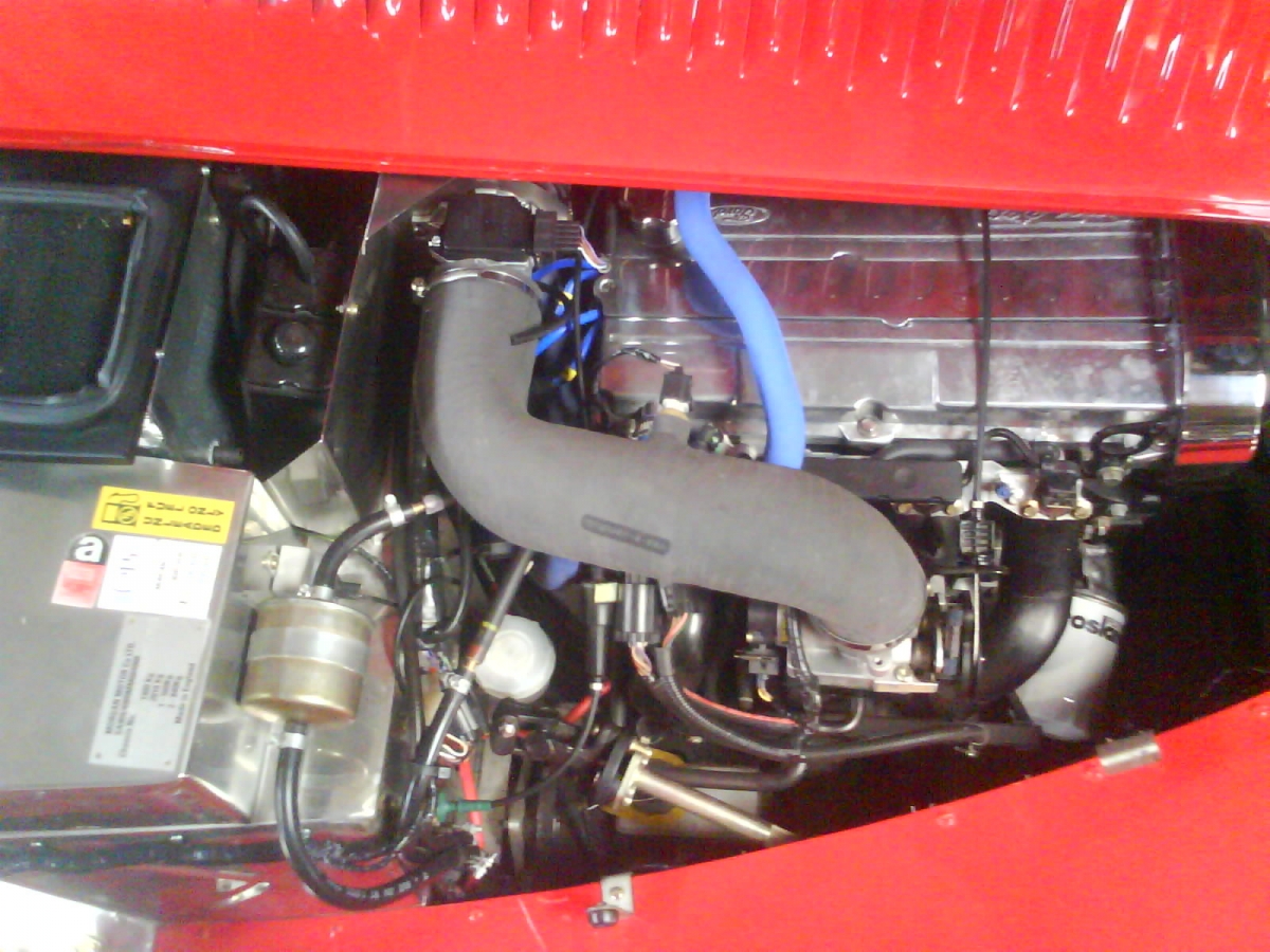

Just been looking at the engine bay again. There must surely be a better way of connecting the MAF sensor to the throttle body than this load o sh*te? All suggestions
(not being obscene nor frivolous) gratefully accepted!!

I agree, but as an aside I like the cam covers and stainless steel engine components. Where did you get these from?

Hi Keith,
Cam belt cover and stainless steel heatshield from Burton (www.burtonpower.com) Also swapped the black plastic oil filler cap for a chrome one from the same source
The cam cover itself is the original horrible Zetec E alloy one but we took it off and had it polished
The cam cover insert came from Raceline (www.racelineonline.co.uk) but you can also get these from Burton. Not cheap though!
Most of the Raceline cam cover inserts are finished in a crackle black with " Raceline" embossed on them but we got an unpainted one and had it poished and also the logo taken off
I also replaced the radiator expansion tank with a Mulberry alloy one and put Aeroquip braided hose on the 'run' from the tank to the rad- Looks really good ( well IMHO anyway) if you send me a PM I can let you have some detailed pictures of it.
Think that's all!
Cheers
GLLHG

Haven't a clue about the MAF Sensor but a lovely looking engine. Will have a look at the links you have provided

Mass Airflow Meter sensor. Unlike carbs which mix fuel/air at point of entry into cylinder, Injection systems 'split it up'
Unlike a carb, the throttle body does not regulate any fuel flow - this function being performed by the fuel injectors in the plenum. So the so-called 'throttle' pedal isn't controlling fuel but air.
You floor the throttle, the MAF sensor tells the EMU how much air is going in and it( the EMU) then sends a message to the fuel injectors which make sure there is enough fuel let loose to give the correct mixture. On the other, ie exhaust side, of things, the Lamda sensor located in the exhaust pipe then sends messages to the EMU telling it whether the exhaust side has too many emissions
Well, that's how my tiny lawyer's brain understands it. See http://auto.howstuffworks.com/fuel-injection.htm - It must be easy- because I managed to work it out!)
I'm sure Dave W could put it much better but that's my best effort
On a less pompous note. yeh, the chrome bits look OK I think, but I've still got to sort that hose. There is a guy Paul Roose in Lincoln
(www.roosemotorsport.co.uk) who says he can make any silicone hose, even a one off, so I think he may be my next port of call- after my bank manager!
