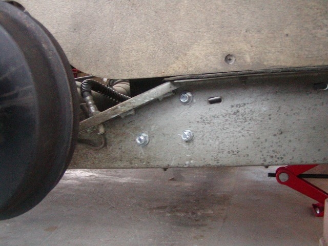

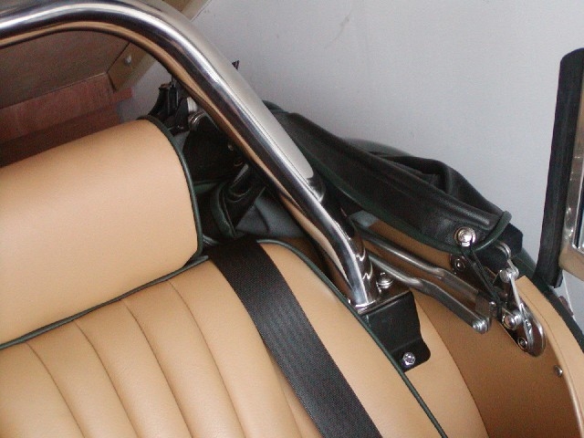

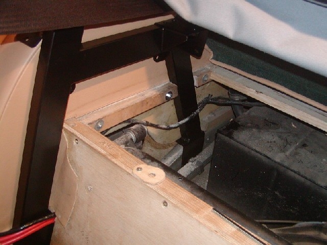

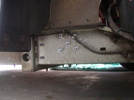

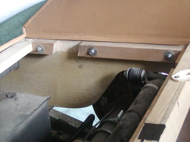

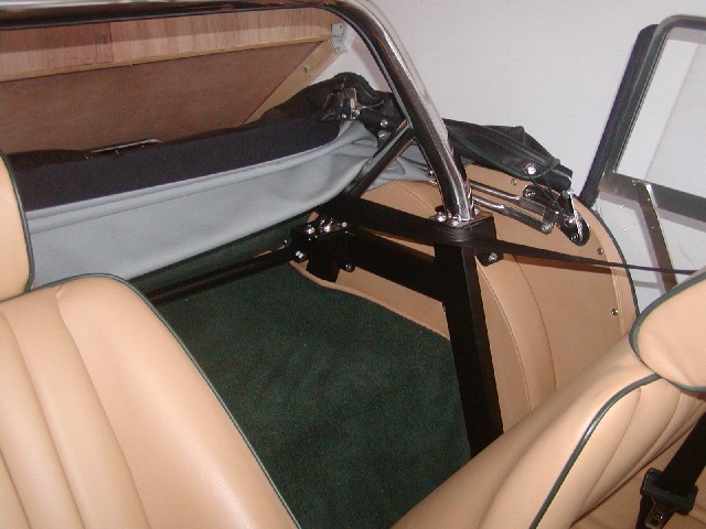

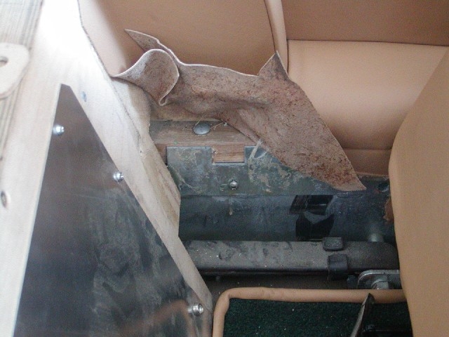

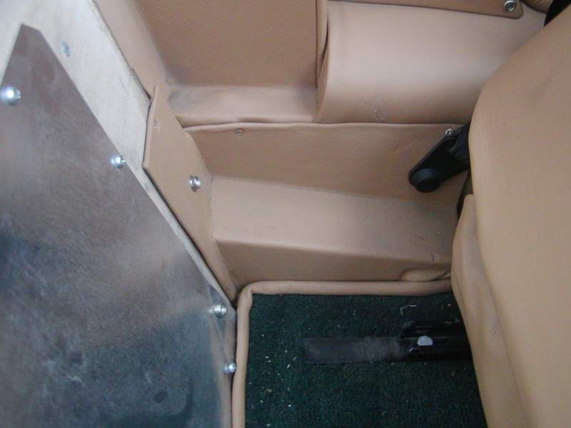

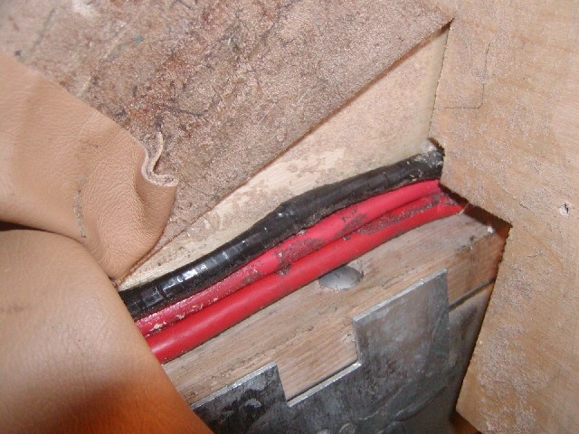

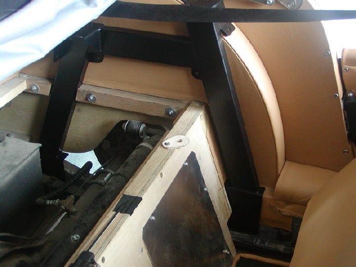

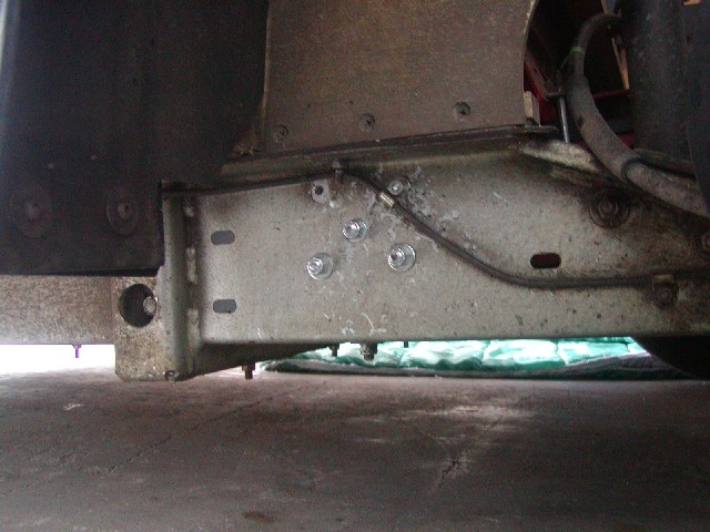

Some pictures for roll-bar DIY fans.

Fascinating - I am interested in one of these and it looks far easier than I had imagined after talking to Rob Wells at Librands.

That's very illuminating, especially showing access to the front leaf spring bolt, and the route of the wiring loom. Which Roll-Bar is this??
Ahh - just seen the other post. So Librands eh?
I've been wondering about doing this mod........

An excellent set of picks and descriptions
What is the situation regarding 'declaration' for insurance and 'modifications to car' issue?
