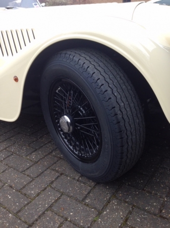

175/70/R15 Tyre on 4/4
Gives an idea of Tyre fit.

Looks great!
Having had a 'ride' in Cain's 'Cafe Racer' the other day, I can certainly confirm that those Avon's stick like the proverbial!!!
And Cain has 175's on the front and 185's on the rear :>)

Interesting, you only loose 3.5mm ride height with that size too, so not to big a difference and speedo will only be out by 2.96% ie it will read 1.77kph high ( you will be doing 58.2kph when it reads 60kph) - if my calls are correct. So an added safety camera margin 👍🏻
