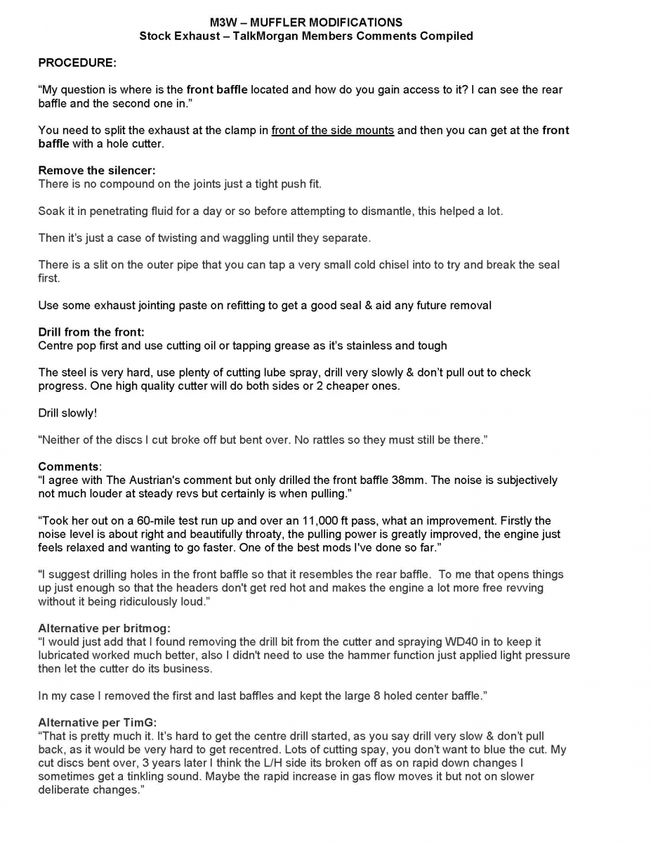

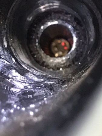

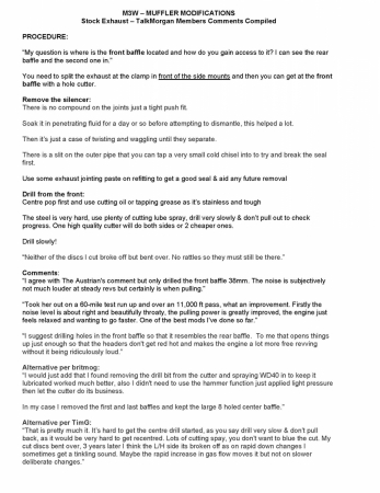

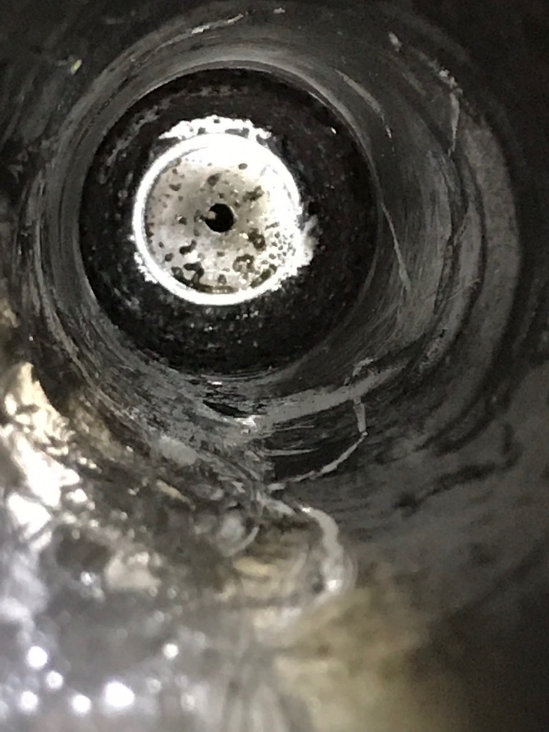

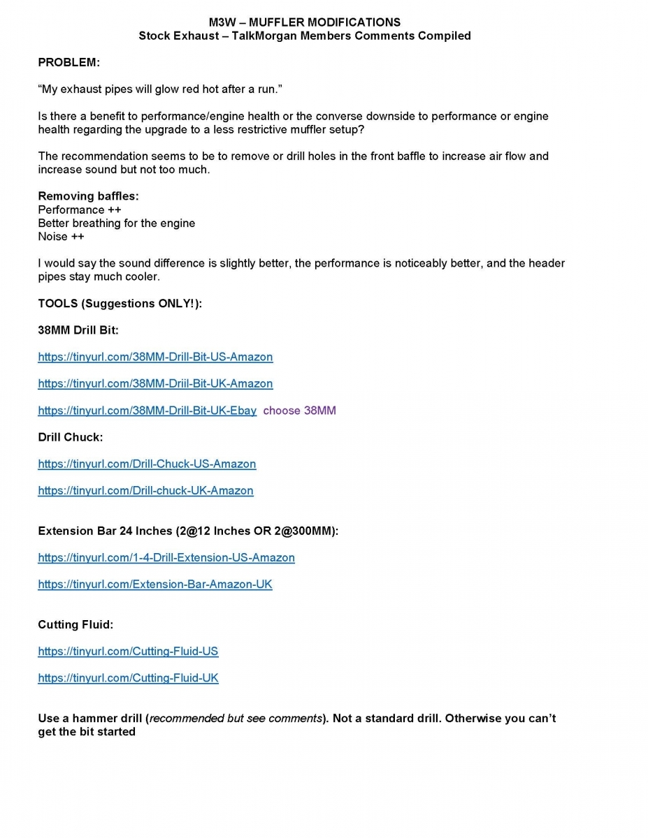

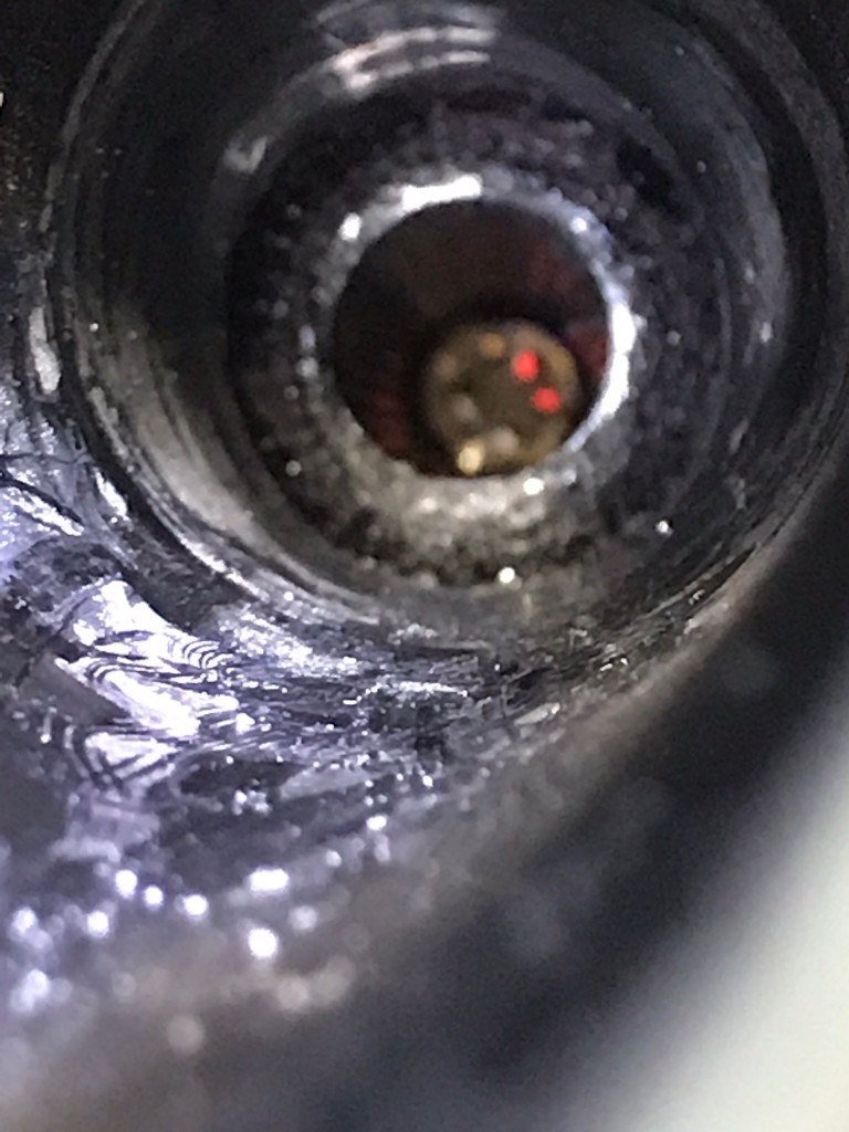

Updated-Bafflectomy Procedure
Added all Comments. Sorry about new post as there doesn't not seem to be a way to delete a prior pic post. Please note that this is a compilation of notes from other great members who have shared their experiences and pictures. I wish there was a way to save Procedures like this, Members may want to create, in a single folder.
