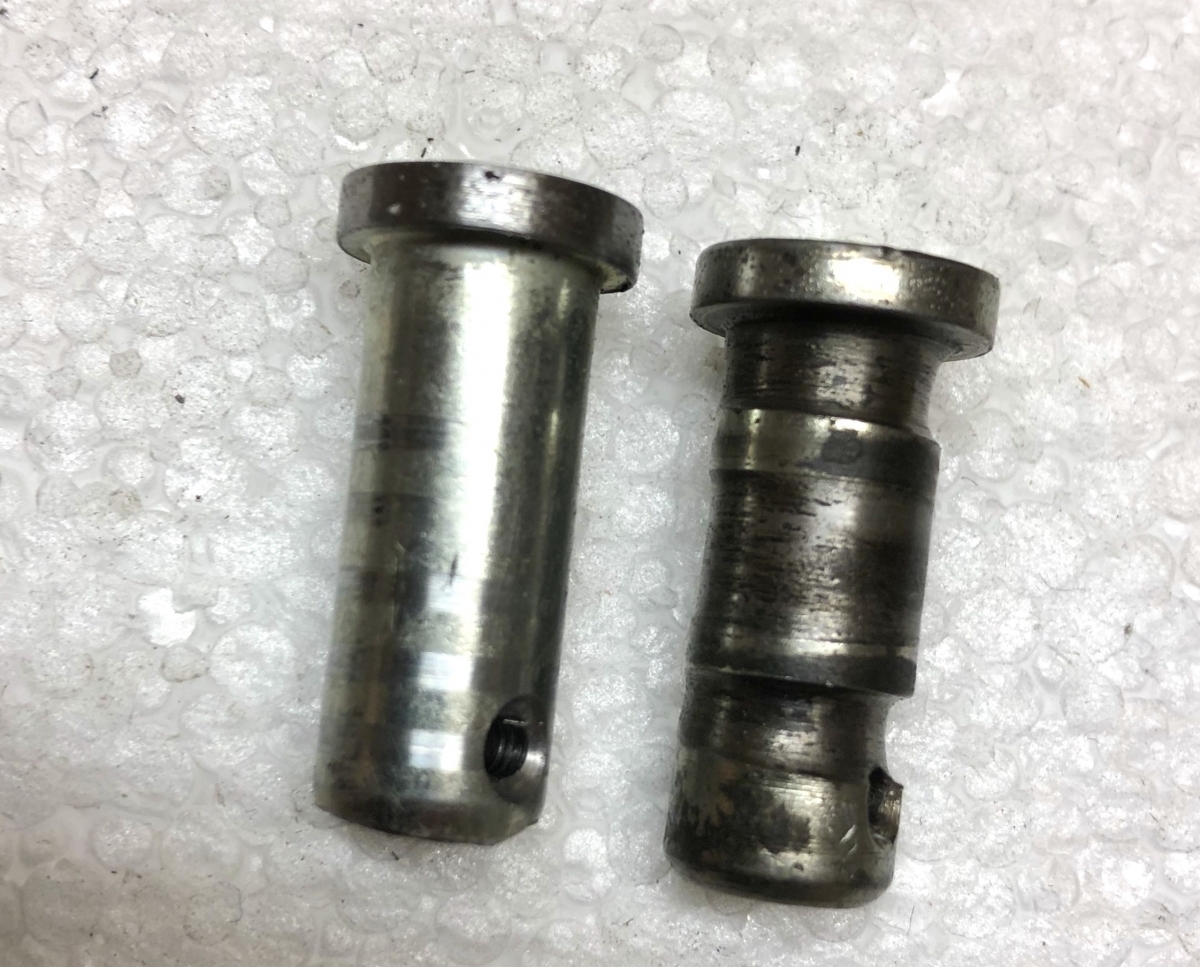

Wear and tear
To the right is how my Roadsters clutch pedal clevis pin looks like after 56000kms on the road shocked2

I'd settle for a new Clevis pin myself grin2

This is exactly the reason why every Morgan owner needs a lathe. It would be a complete doddle to make up a replacement in silver steel and harden it rather than just replacing it with another mild steel pin that's going to wear again.

Periodic lubrication of these is on the servicing schedule, but I suspect is often missed, if the pin is dry & not rotating that's the classic photo of the wear you get
So, a little job for the weekend chaps ?
