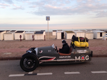

MMC luggage rack - 2000 miles - It works.
