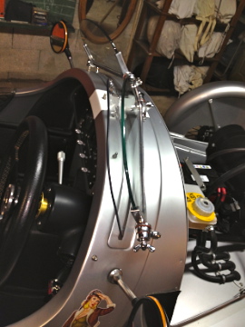

my windsreen in plexi was broken
the brooklands are great
Posts: 2,356
Posts: 2,356
Fits the car well.
Posts: 374
Posts: 374
Looks great but have to admit I'm a bit confused, I hadn't noticed a different windscreen on the Brooklands 3W. Am I being dumb?
Posts: 2,356
Posts: 2,356
No the brookland mtw doesńt have brookland aéro screen
Its a mistake , itvs very smart with it

Agree that the Brookland's look fantastic on the M3W.
I have a question for anyone who has installed them...what do you do with the defects left behind by removing the plexiglas screens? It seems that a new "blanking plate" could be fabricated easily to fill the old mounts...a less satisfying option would seems to be to just leave the open slits below the new screens...

I've made a little pièce in aluminium
Put in place of windscreen And finishing with silicon
You could do it with Plexiglas but you must warn it for putting it
I send photos after

Hi atlante83,
That looks superb, very well done!
A few questions please.
How did you remove the original plexiglass screens?
Regarding the small aluminium pieces you made, where do the tabs with screw holes fit, and are these visible? Do you have a photo with these pieces in place?
I am guessing the new pillars which hold the new windscreens have nuts on the underside , how did you get access to the underside to fit these?
Many thanks
Posts: 2,356
Posts: 2,356
you do the job by this way
the original windscreen, there are four bolts for each windsreen
silicone must be taking out of the tabs
