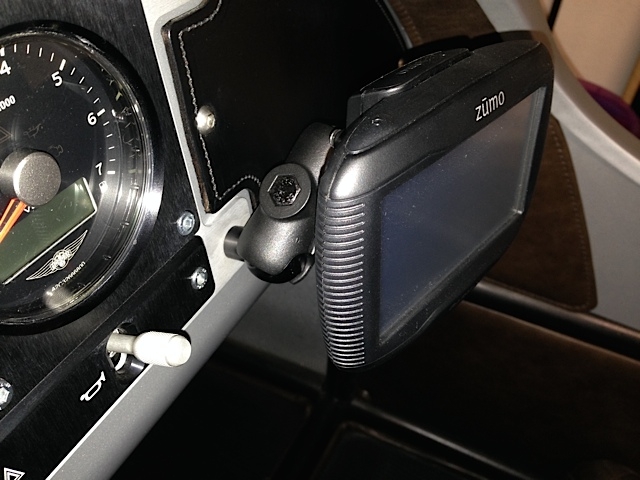

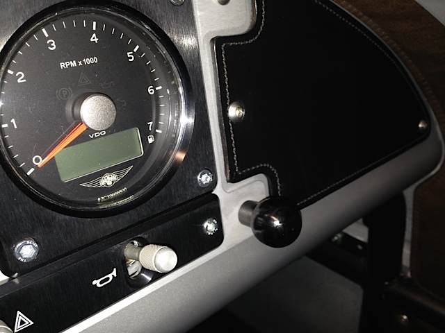

Hi Rob,
just my peppercorn to a discreet Nav mount in the M3W...may be I can help woohoo
I bought the Motocycle Kit with the Garmin Zumo and also a RAM Ballmount where you can remove the 4screw Foot (bought mine at www.Louis.de) Found out that the screw fitted in the armature Tablet from the M3W is the same than the one in the Ballmount. So I could use a longer Screw, sawing the head off and fitted the screwfillet with locktide in the Ballmount, same lenght as the original screw from the armature Tablet. Screwed the Ballmount in the Tablet...et voila joy
As I only use my Nav occasionally, I found this a 'non disturbing' solution for the look on my armature Tablet, which can ,on need, be removed without a trace. I didn't put on the charging cable, as I have more autonomy on the Garmin battery than I need.
And as a bonus it makes a nice hanger button for my sunglasses doh

I really like your solution, Smaug! I will definitely look into this. What size is the screw that goes into the ball?
Thank you!

Hi DocNik,
The screw which goes in the Ball mount is the same as in the armature tablet,
which is an M6 with a lenght of 20mm. The screw for the ballmount should have at least
around 45mm in lenght. You need to saw the screwhead off and turn it completely in the Ball mount fixed with locktide... done! Just need to swap it with the original screw by tighten it firmly by hand. thumbs
