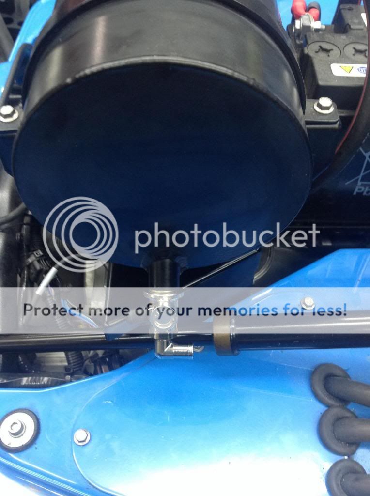

A few of us have fitted a small purpose built tap that replaces the nut on the oil tank making this job very easy. I will post a link later when I get home

http://ezoildrainvalve.com
But use a washer so the valve gets centered

Q8, do you happen to have the part number of the oil drain valve that you installed?

Q8, I found your post - thanks.
Ez oil drain
Part #ez-107
Thread size 12mm-1.75
