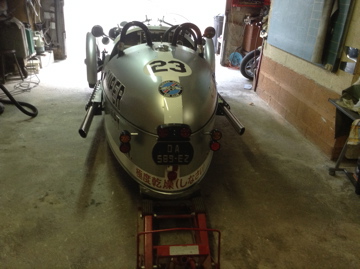

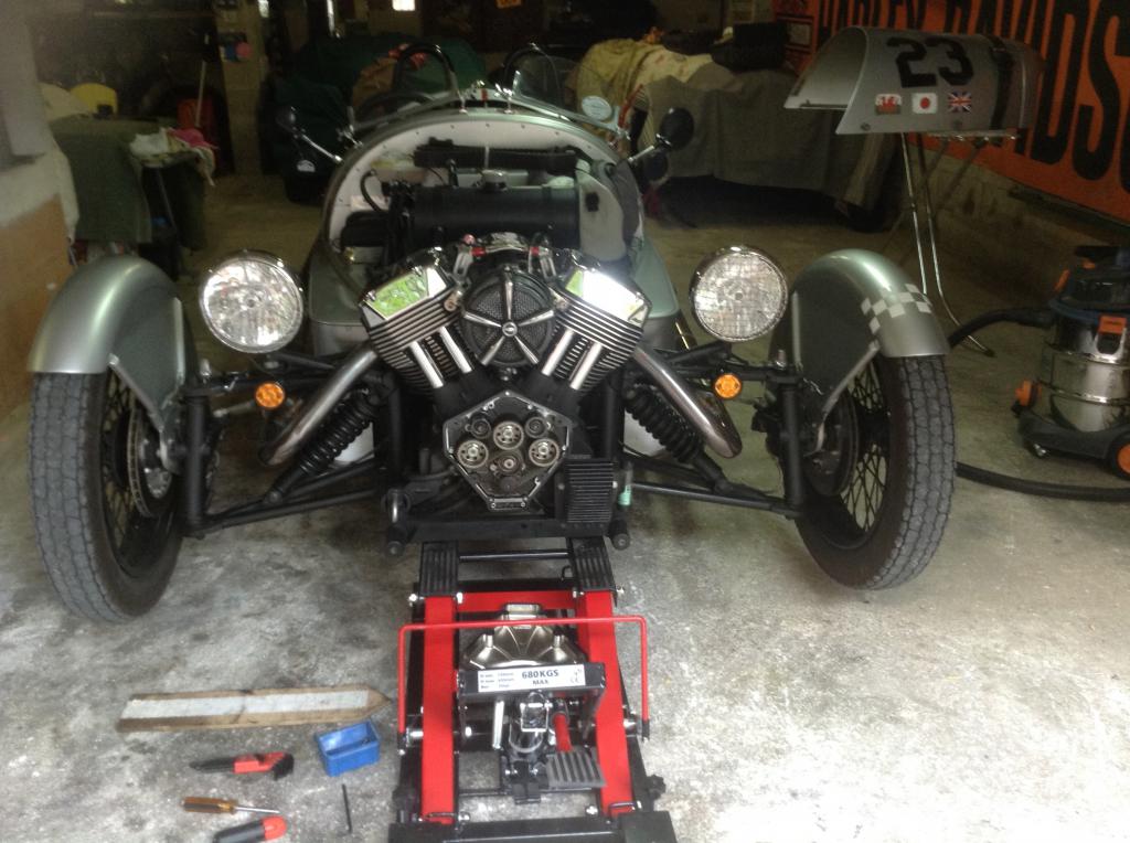

I am using two little lift for Quad (695kg)

I'd be keen to see the twin ATV setup up mentioned by atalante83. Can you post a pic?

Matty #256381 01/03/15 06:36 PM
Posts: 2,360
Posts: 2,360
Matty #256382 01/03/15 06:39 PM
Posts: 2,360
Posts: 2,360
Matty #256445 02/03/15 06:43 AM
Posts: 797
Matty Offline OP
Posts: 797
Thanks for the shots. However I don't think you should jack the rear end on the ash subframe!!!!
