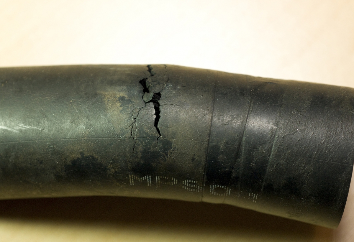

In 2010, five years after buying my S1 Roadster, the fuel hose from the filler cap to the tank split and dispensed several pints of the 100 octane I had just bought onto a very hot exhaust pipe. I was lucky not to have been incinerated but embarrassingly I was stranded outside the Ferrari factory in Maranello. I was able to get a replacement Morgan pipe sent by DHL, but at no small cost.
On my return I had a word with the factory about their pipe but there was very little interest and a "It's a Morgan Sir, they all do that" attitude. My suggestion that perhaps all Morgans should not do that and that a car costing north of £40K should be made with better quality materials, was met with anger.

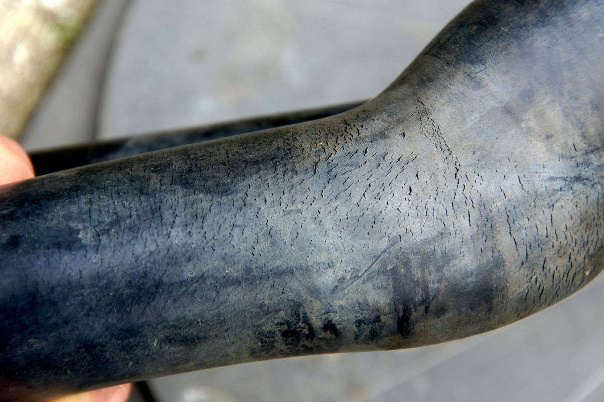

I sent the pipe to a rubber analyst who confirmed that the pipe was made of fuel-resistant NBR rubber, but that NBR rubber is extremely hard and requires to have 10% plastisicer in it. This had been leached out by the alcohol now contained in petrol.

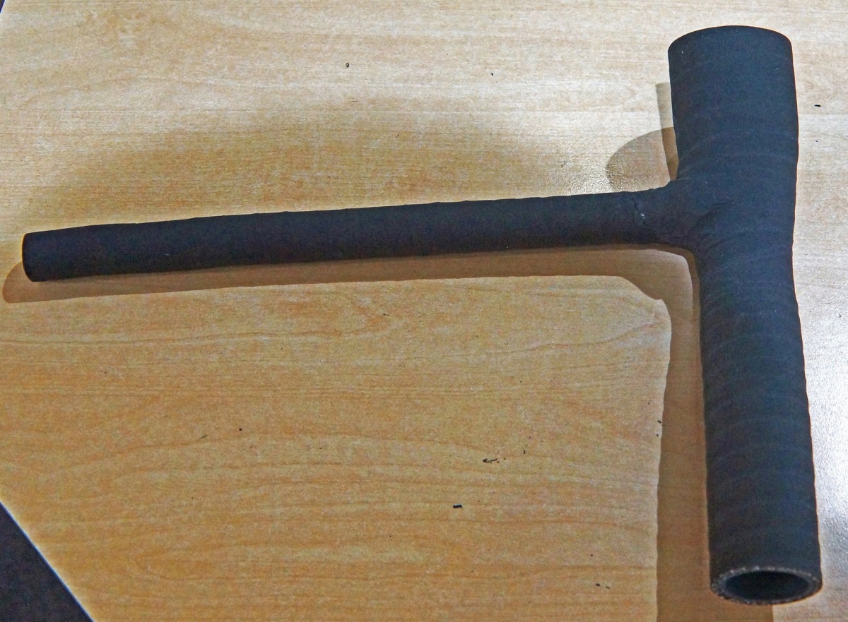

A short internet search found a company that makes seamless silicone fuel pipes. I sent the details to Morgan but there was no interest shown.
Lo and Behold, another five years on, the replacement fuel pipe supplied by Morgan is starting to fail. I contacted the firm that makes the silicone pipes and, with the involvement of Berrybrook Motors, we have had a small number of silicone pipes made. The manufacturer claims they will last the life of the car.
I have had one fitted, and if anyone wants one, Berrybrook have a small number (but could have some more made depending on demand). The fitter said that they might also fit a 4/4 or Plus 4 of the same era as my car. It might also be possible the have pipes made for other models/years if there is enough interest. I have no financial connection with either the manufacturer or Berrybrook Motors.
