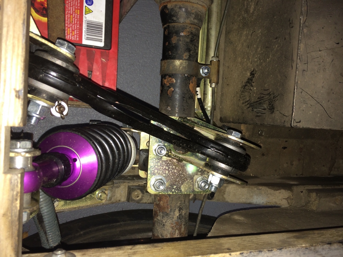

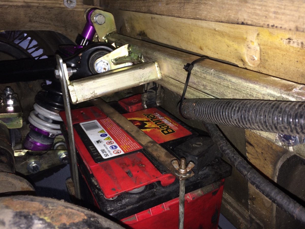

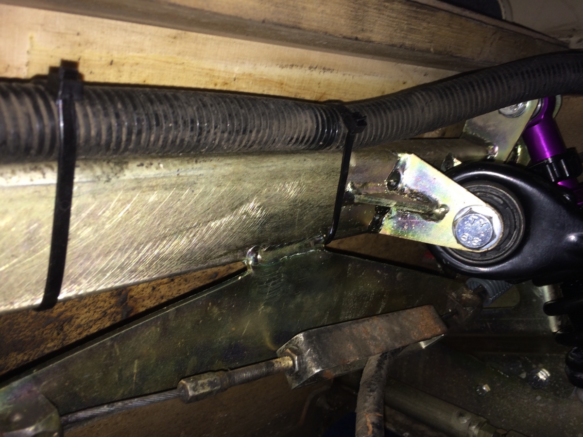

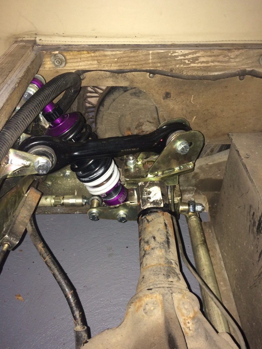

OK, as I reported previously having driven Henry's car for 90 miles I found it a bit harsh on the rear, not quite what I expected, although it did handle and corner very well. So I looked at the Quantum shock absorber settings this morning. The coil over springs are set to what looks about half way, I could not adjust these as I do not have the right tool, the top shock adjustment was set to 11 out of 24 (being hardest). So pushed up and down on the rear and as I expected it was very firm with a lot of resistance. I took the top shock adjustment back down to position 6 making the shocks softer, and bounced the rear, still reasonable resistance but easier to get it to move up and down.

Very interesting read and photos. Thanks for taking the time to post.

And what happened to the inner wings? The wheel is very visible through what should be plywood!
