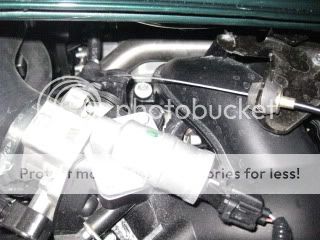

Originally Posted By DaveW
And here is the Roadster 100 equivalent for comparison. The cable, at the right, sweeps nicely down to the bulkhead in a gentle curve.
