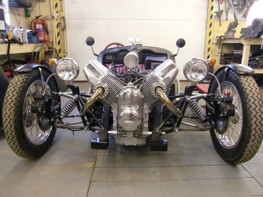

The front-end of the chassis has been altered from Divey's design to a space frame with the engine/gearbox also acting as a stressed member, as it does in the Moto Guzzi bike.
Whilst most of the metal work is done in-house, the bodies (and engines) are bought in:
This is a low-mileage engine out of a Motor Guzzi California, which has torque characteristics that suit the car.

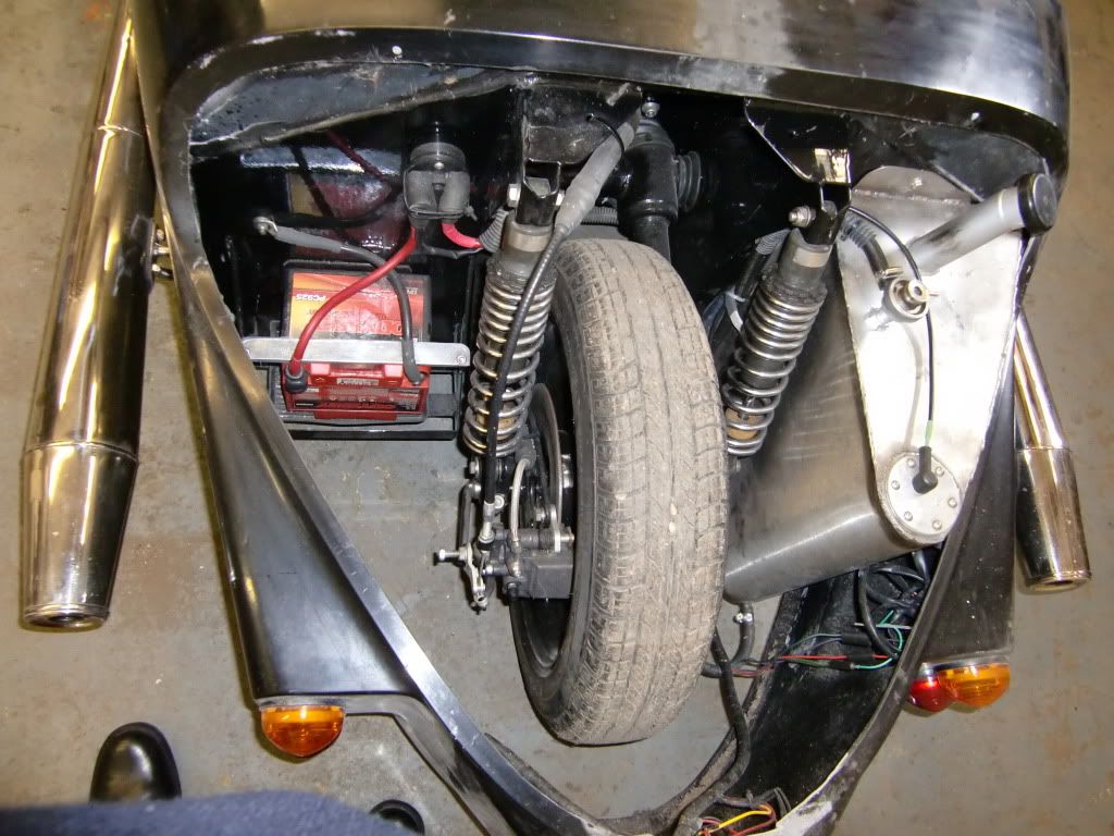

The bike running gear is also used at the back (the wheels/tyres on this car are not the finished articles):

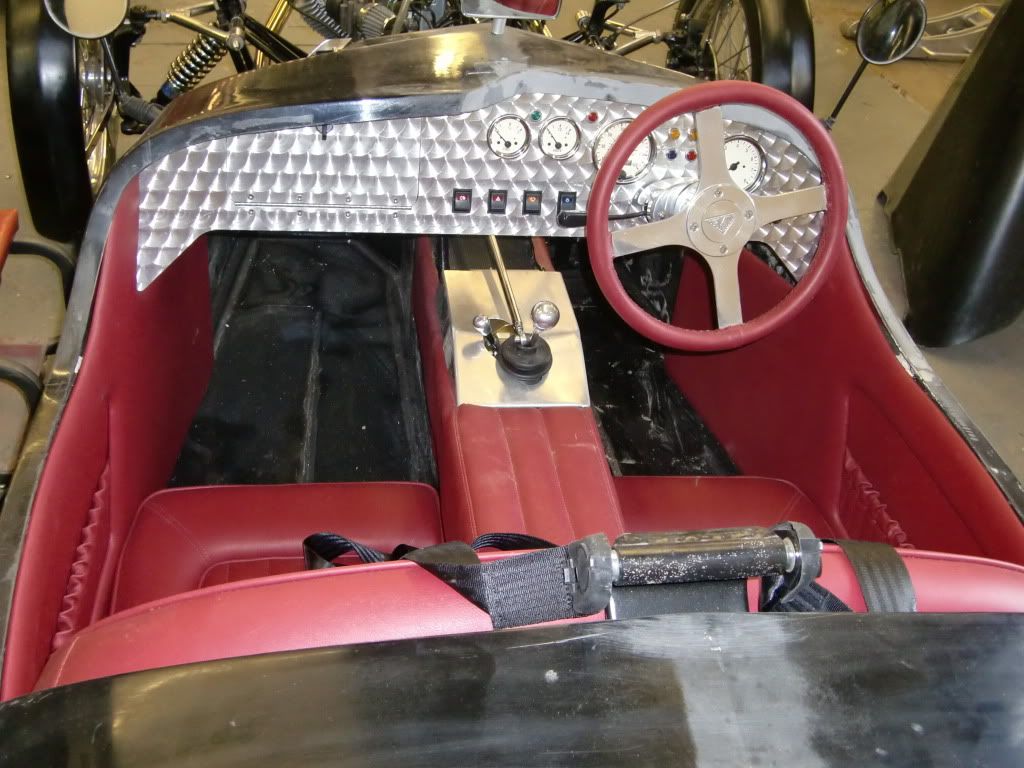

THe turned dashboards, steering wheels (not the leather) etc, are all done in-house:
The upholstery is all done by a local craftsman to customers requirements:
NB: Please ignore the ugly seat belt mountings (and the mirrors) which are fitted for SVA requirements only.

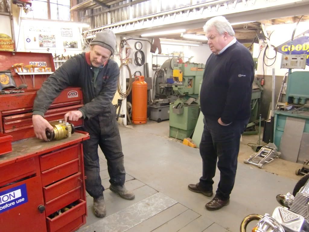

Alan explains the operation of the reverse gearbox to Gerwyn:

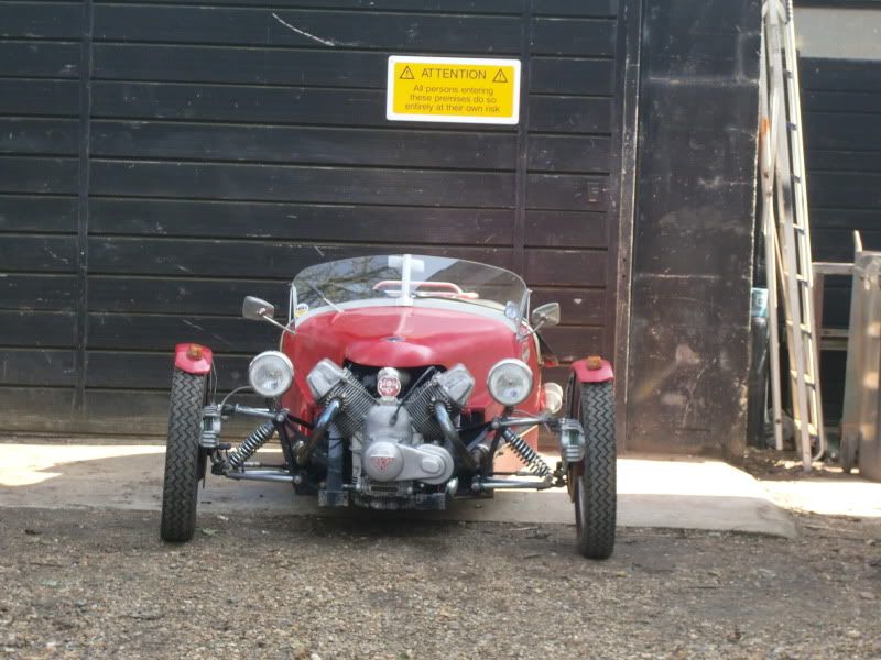

It is not really fair to show this, but it is chassis number 1 after nearly 40-years of trialling and abuse. It really needs a bit of TLC, but Alan is too busy dealing with current orders for cars and parts. One of these days he'll get round to it - the cobblers shoe syndrome methinks!

I think the reason he goes for reverse gear is that it is more maintenance free than a navigator! hide
On a serious note, those 'Nova' boxes are a tremedous bit of kit. I've seen a couple on bike- engined ( usually Hayabusa) cars with sequential gearboxes and they really do perform.
Allan Layzell himself made the point about the Nova advert where they claim the box allows a car to go as fast in reverse as in any forward gear crazy2

Re: grey haired old b*ggger in the pic- that's my( much) older brother! evil
