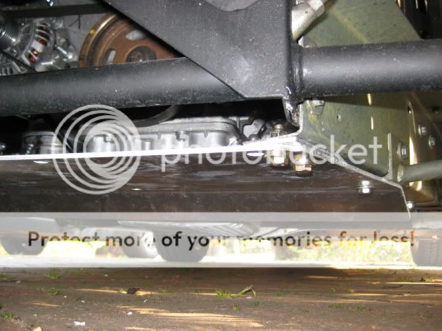

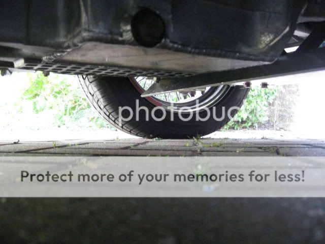

In response to requests for pics of the Peter Mulberry Roadster Sump conversion here are some of my feeble pics. taken from under the car. I believe that this is the first one on the latest sump (Dave W's research indicates that they are all similar in this respect though)

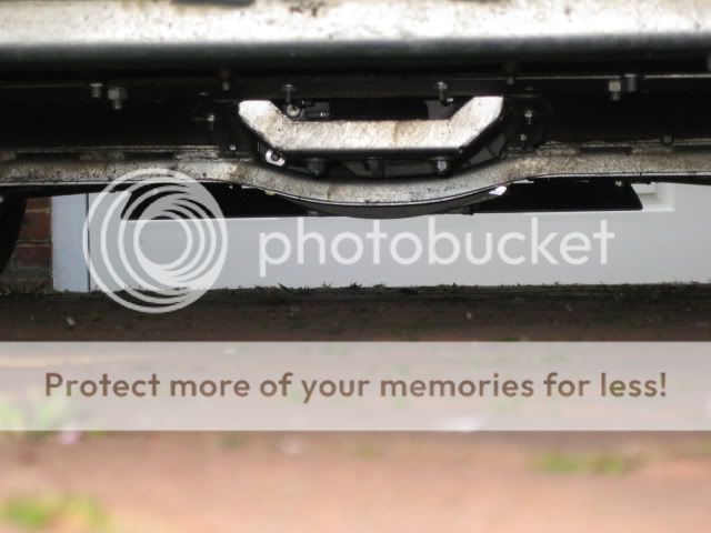

The Tail end Pic. was taken with the lens set 3cm from the drive's surface indicates that the Chassis and Sump Guard are now the lowest parts now. (phew)

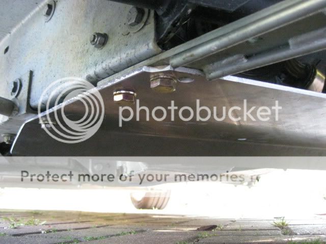

You will notice that I have also had a Sump Guard Fitted (Aero 8 Conversion apparently)in an attempt to allay fears and give SWMBO more confidence.
This looks quite easy to make in 4mm Alloy Sheet for those of you with the skills and tools and IMHO would have gone a long way to helping prevent damage to our no-converted sump. IMHO it should be a standard fitting for Roadsters. innocent
Side View showing the milled away waffle and replacement plate with re located Drain Plug.
A Closer shot of the Welding and the tail of the Sump Guard which is ahead of the Sump so no fouling.
Tail End Shot showing the Gearbox cross member and the Sump guard.
Sump Guard looking towards the Sump from offside front.
Sump Guard looking from Nearside front.
