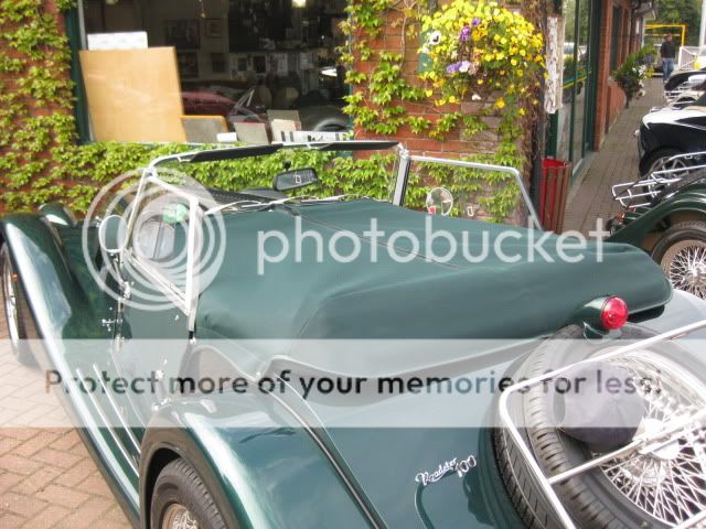

Well Ken, I needed the dealer to show me how to get the Toneau to fit as I was after a replacement. It looks a tighter fit than yours though.
Zip open and Back Latches unpopped.
Fitted the left side Poppers & Tenex first including the front scuttle side & middle fastenings.
Then Heave across the back edge to fit the side back popper (the one I could not do up).
Then do up the right side poppers etc right to the front.
Then do the Zip Up and clamp down the back edge last.

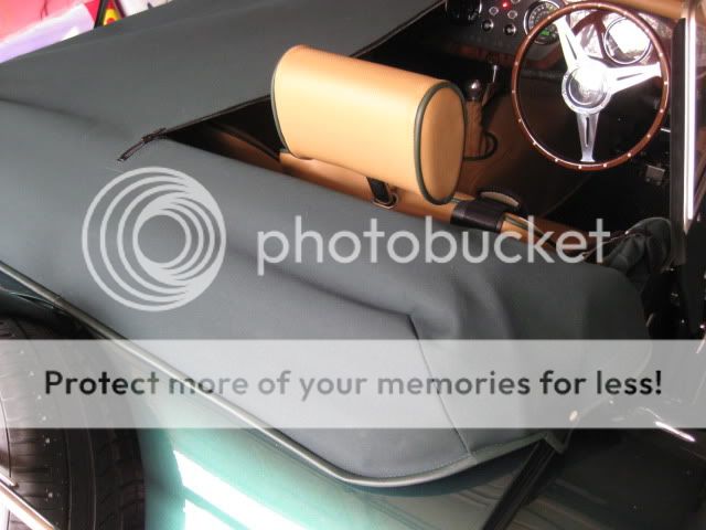

Your folding method - My first attempt. - Rear View.
Front view - First Attempt. - will have to do better. It is well clear of the Seat Belt as you predicted.
I have left the full Toneau zipped up over night to allow it to stretch a bit. I will have another try tomorrow.

Frank. Open the zip fully so you can tuck more of the tonneau on top of the hood. Otherwise the wind will catch the loose bit of tonneau that is forward of the popper.
The secret with the tonneau is to ensure it is properly located at the back and then to pull it forward. Then fix the nearside front first by locating the middle front fastener and then the nearside one. After that the tenax and the stud below it. For the offside, first close the zip and engage the velcro and then pull hard to engage the edge dash top fastener. Finally, engage the tenax fastener and stud below it. As most of my journeys are about 100 miles, I seldom take the sidescreens off so the door studs are not used. If the tonneau is left in the sun it is far easier to stretch it.
