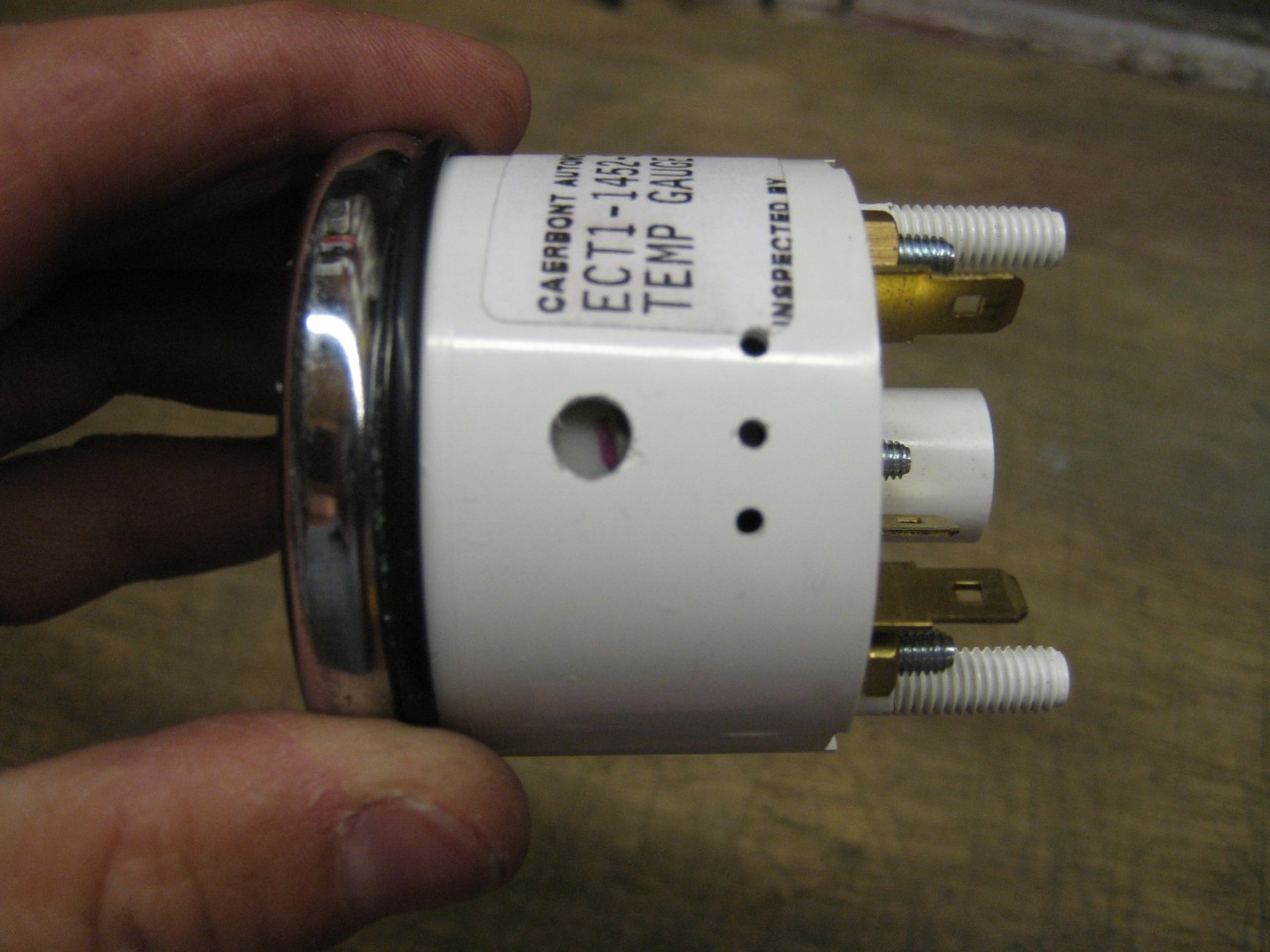

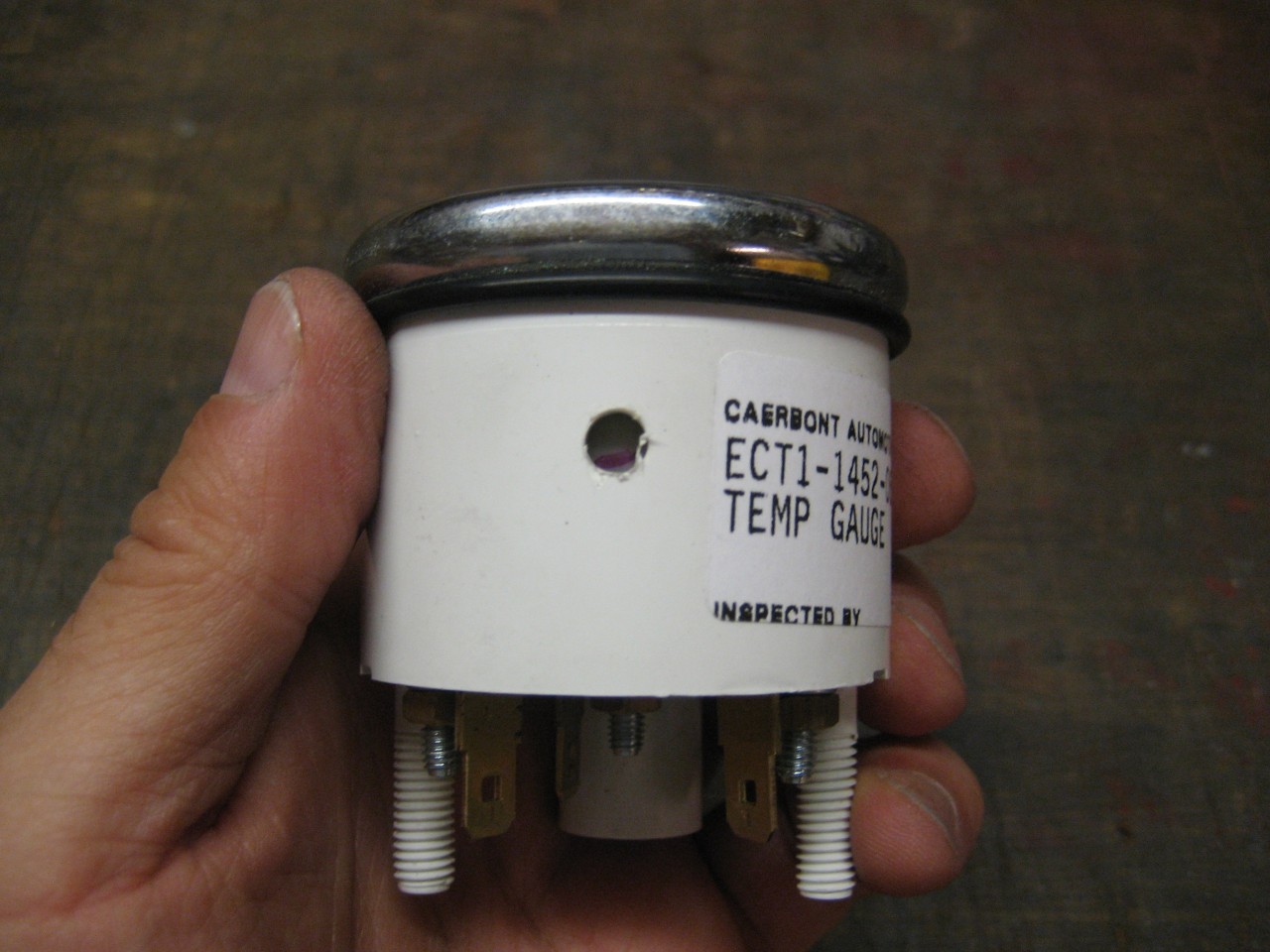

The temp gauge, with visible reference numbers:
At the top is a 5mm hole. But the internals are just below the hole. I've enlarged this by hand to 5.5mm.

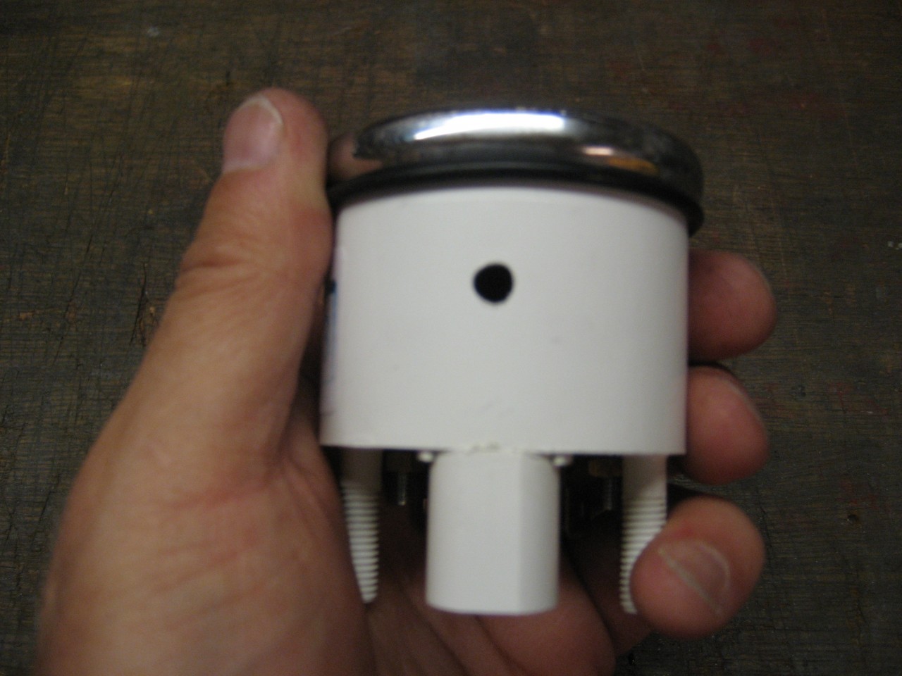

At the bottom is another 5mm hole, also now enlarged to 5.5mm.
I've added three small holes to the top, using a pin-chuck - which is a finger drill.

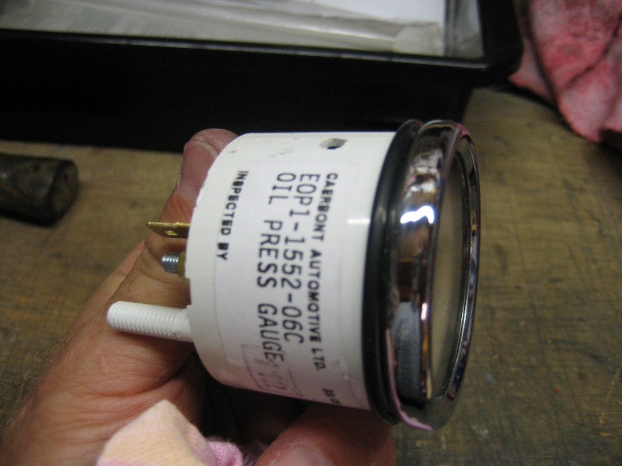

Oil pressure gauge numbers:

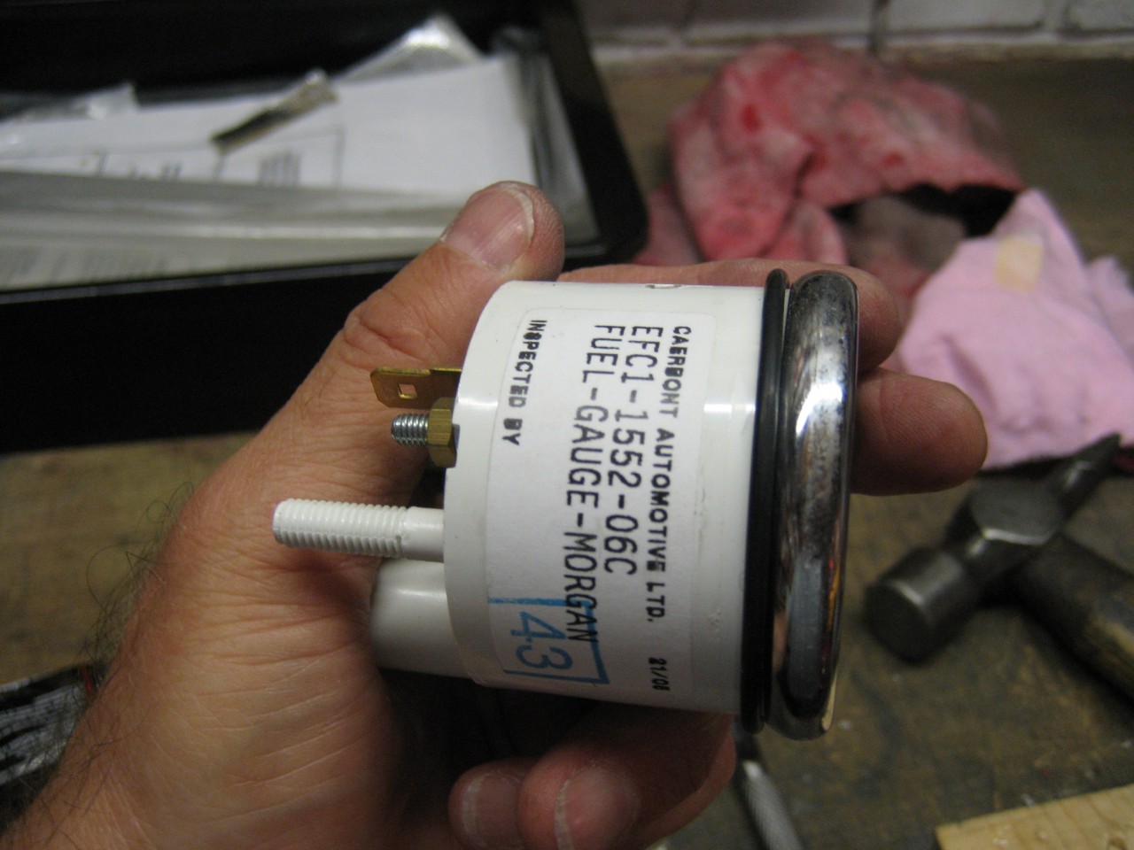

Fuel gauge - this one appears to be Morgan specific:

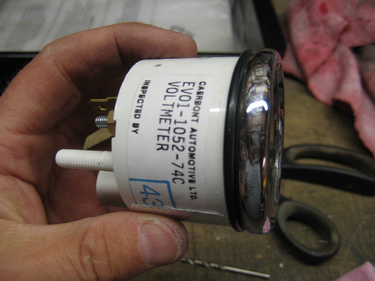

And the Voltmeter:
I've treated then all the same, except the fuel gauge, which is the worst mister. In this case I've enlarged two of the three additional holes on top to about 3mm. I've also added two more holes in the back.

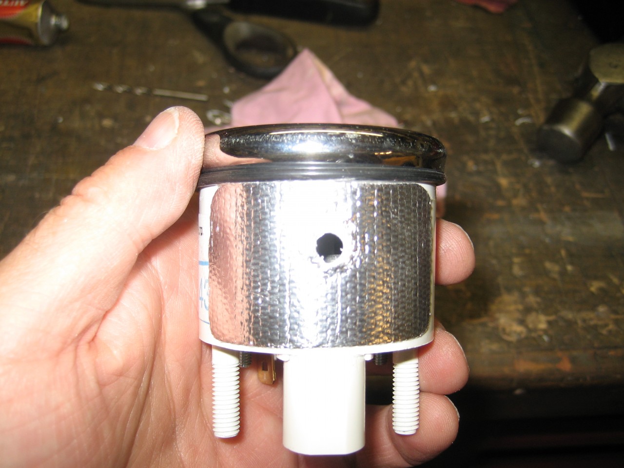

Finally I've added some Reflect-a-cool to the bottom section of each. just in case rising heat is part of the problem.

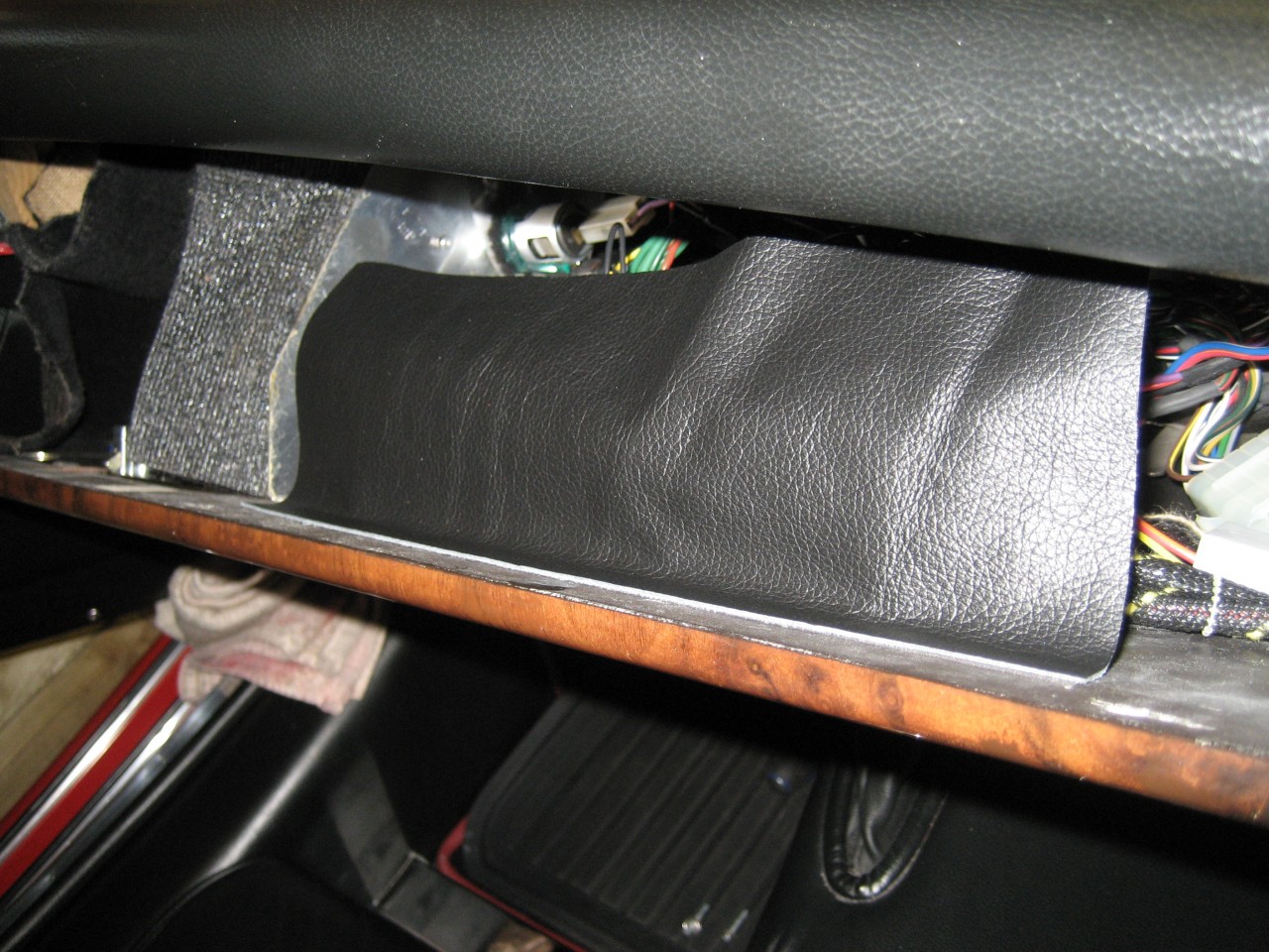

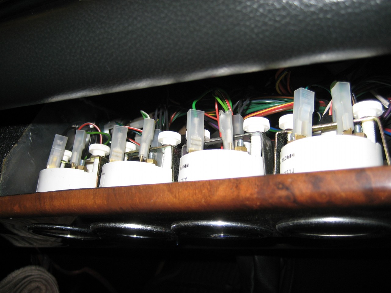

And as a final touch. I've added a leather "water deflector", secured with double sided tape, over the gauges and the circuit board which is fitted just below. This is a bit of a gamble, as it may reduce air flow through the gauges. Only time will tell........................

I would have thought that heating them up to drive out any moisture and then sealing them would be a better bet. Drilling holes will only let in more moist air surely.

Only time will tell Keith, but the panel light hole can't easily be sealed, and so moist air will still be drawn in.
I'm hoping to get more airflow through the interior.............

Brian Miller fitted the leather bit over mine many years ago with the standard holes they still misted. But it protects the PCB which at £500 a go for a new one is well worth it.
