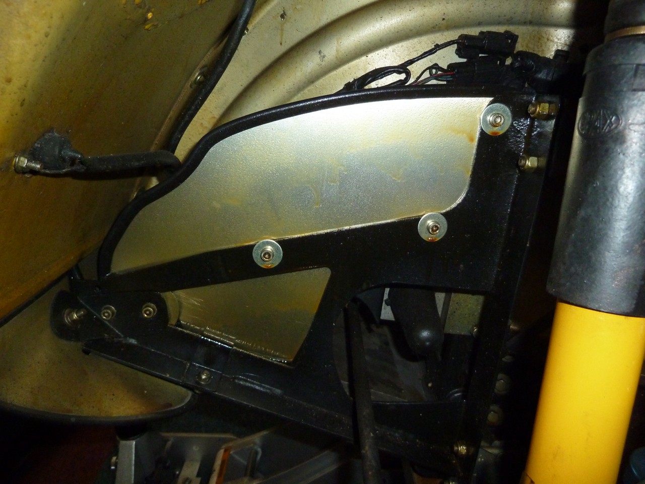

I've been thinking about doing this splash-guard thing for a while.
The over-rider brackets have four pre-drilled holes in exactly the right place to add a vertical aluminium plate, to partially blank off the engine bay.
Here, two of the holes are visible to the left of the damper where the black dust shield and yellow body meet.
So starting with a cardboard template, using three of those holes, and rummaging through my stock of aluminium sheet, I went for 1.5mm thickness...................
I added edging, which finishes it off.......
And this is the result..................
Other side..............

I also added a small piece to the air filter housing.........
And that's it. Minimal cost and a good session in the garage..... thumbs

Meticulous work as usual.
You should write a book !!!
