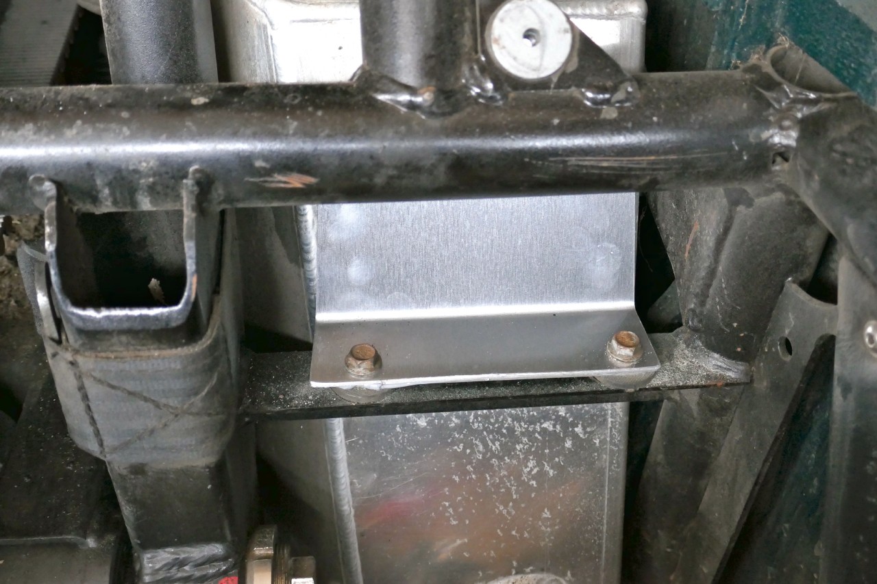

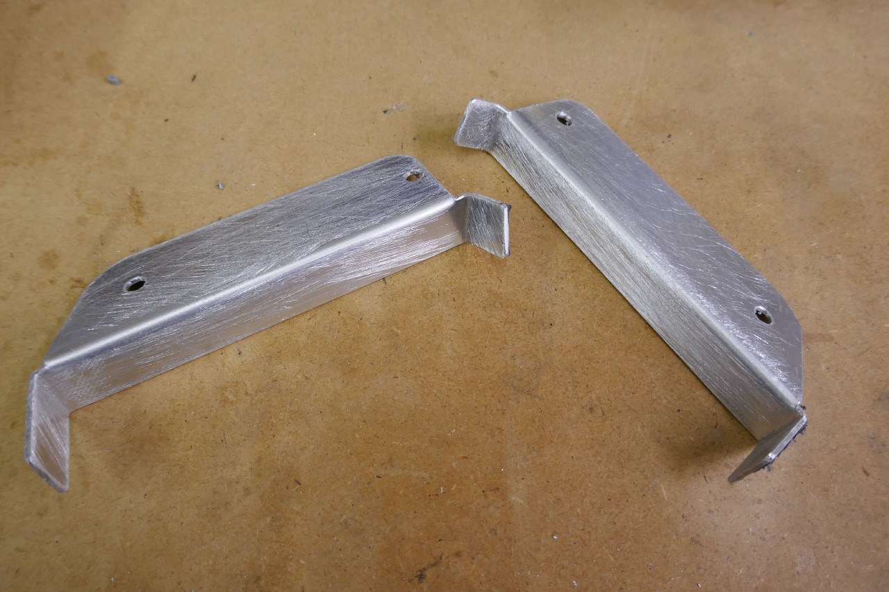

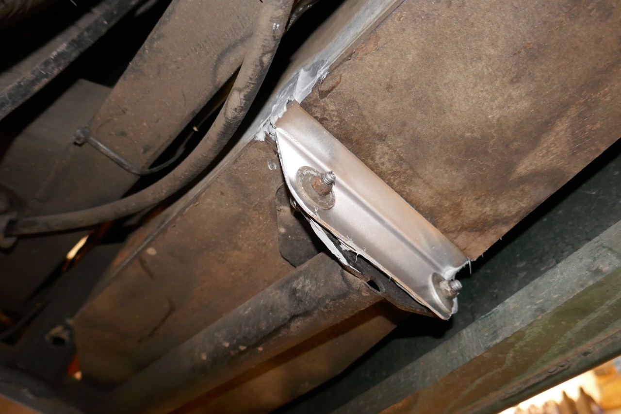

This photo (not mine) shows the strap arrangement well. It's imperative that this strap is kept taut or the tank will be allowed to flex up and down and the front bracket will almost certainly fracture, sometimes resulting in fuel leaks.  As Planenut mentioned, some of us have reinforced the rather flimsy L brackets that are welded to the tank with secondary aluminium brackets bonded over the originals. Front bracket:  Lower bracket:   The take home message is to regularly check that your straps are correctly tensioned!

Mark, thanks for the explanation, and Andy the photos tell a lot about the design.
It appears that the tube frame does not extend to the rear completely and the front mounts and a tube extended part way back to the middle of the tank take the load. You are correct about the straps! If loose they allow the tank to pivot on the front mounts more freely. Box tubing would have less flex than round tube for that center tank support.
It makes one wonder why frame was not taken to the rear to hang thing like the tanks .
