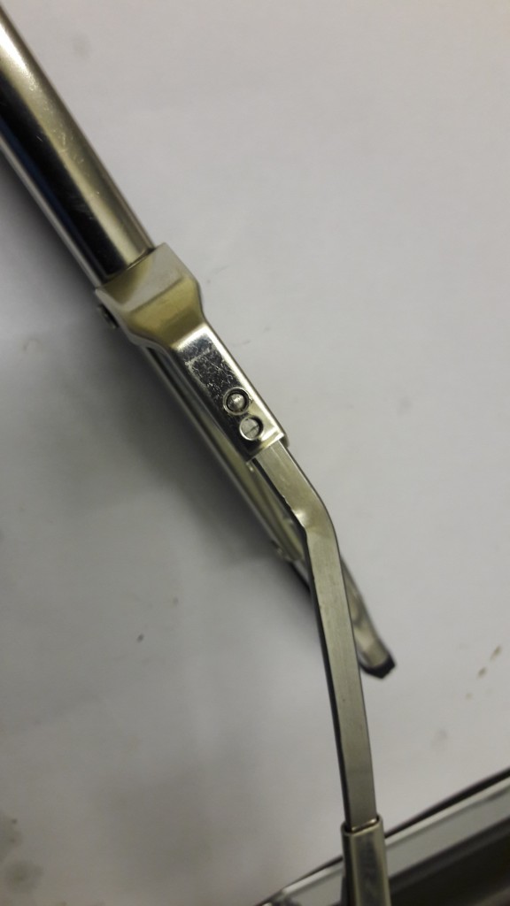

As this weekends weather was so poor I decided to try a wiper upgrade, I'm not keen on most of the alternatives that have been tried on TM as they are usually black and I wanted to stay chrome / stainless
I managed to source these which were pretty close in length & nicely made
Although very slightly longer, most in 'lost' in the inner sweep, mine just touched the 'screen top and needed a little trimming
The centre one worked great but the other two ended up needing an additional tweak to loose I tiny bit of outer sweep, so by drilling an additional hole the arm would push further in & the button would still lock
Overall pretty chuffed with the result, may even take them back off and mirror polish 'em

Jon where did you get them from?

I've been searching on & off for years and tested various without a satisfying result, then by chance dropped on Carbuilder Solutions who I've used lots of times before & never noticed them in their book
They are ref WBS 8

I played around with a similar, but different, set of wipers and couldn't shorten them in a satisfactory way. These look a much better option.
If necessary it would be relatively easy to shorten the main rail and drill new holes to rivet the blade support closer to the centre. This would allow the blade to be cut shorter.
New rubbers could be fitted when necessary because they seem to use a standard type of rubber such as used by Bosch.

Westfield offer a similar sprung blade in black. Although I have the plain Caterham ones, which work fine given stronger arm spring, these should fit at 204mm in length.
