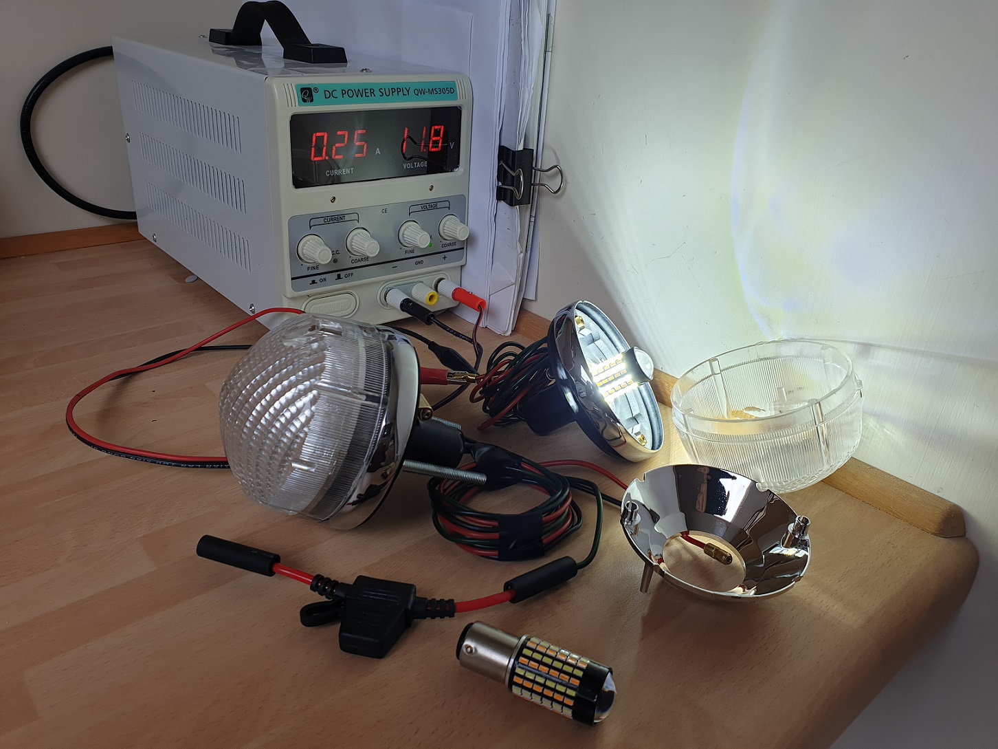

So now that I have an ultra-low visibility marmite coloured car I thought it time to raise my survival odds and try some DRL’s. I’ve seen the ones in the headlights but was curious as to how some of those clever DRL switchback bulbs might work in the winkers. Switchback bulbs are dual white amber LED bulbs with a bit of circuitry on board to disable the white DRl whilst the amber turn signal flashes on/off. When the turn signal is cancelled the DRL slowly comes back to life a few seconds later. Also being quite bright they are disabled when the main lights come on.
I will live with them for a while and see how they go. As far as I can tell they are UK legal…. innocent

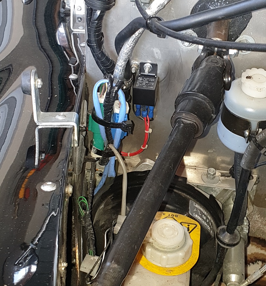

Mine are wired so they monetarily go off as the start key is turned. I haven’t put them on a switch yet more so as to force me to use them all of the time however I only need to pull a spade connector if I need them off for some reason. Like maybe an MOT….

Hi Richard. My understanding is that the regs say DRL’s have to be dimmed or switched off when the main lights come on. I didn’t bother with a control unit I just used a simple auto relay I had kicking around. Its wired with a tap off the parking lights to switch the DRL’s off when the main lights are switched on.
Yes the stop/tail holder is connected to the indicator wire and the DRL to the other. And yes the clever circuitry inside the bulb switches off/manages the DRL when needed. Before I stumbled on these bulbs I worked out a way of doing it with a 555 timer and regular amber/white bulbs but these switchbacks are so simple. They are designed for the job and just as bright as the DRL’s on my tintop.
Yes again I have 8 ohm resistors mounted behind each bulb holder.
