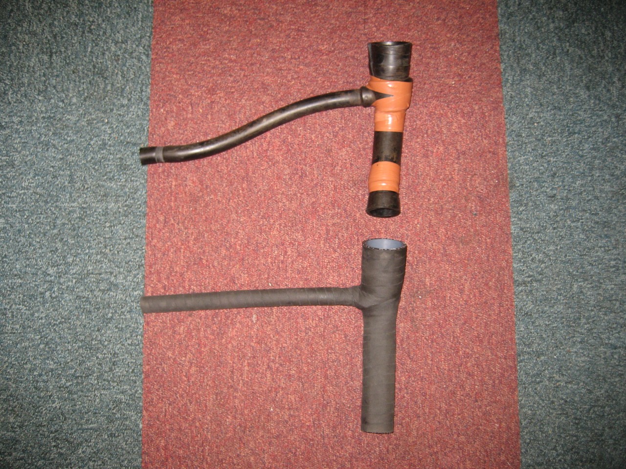

The one piece hose has a reputation for ageing and perishing. It is also said to be unobtainable. However Librands do sell a replacement which is better than the simple rubber original, being fabric wrapped. More of this later.

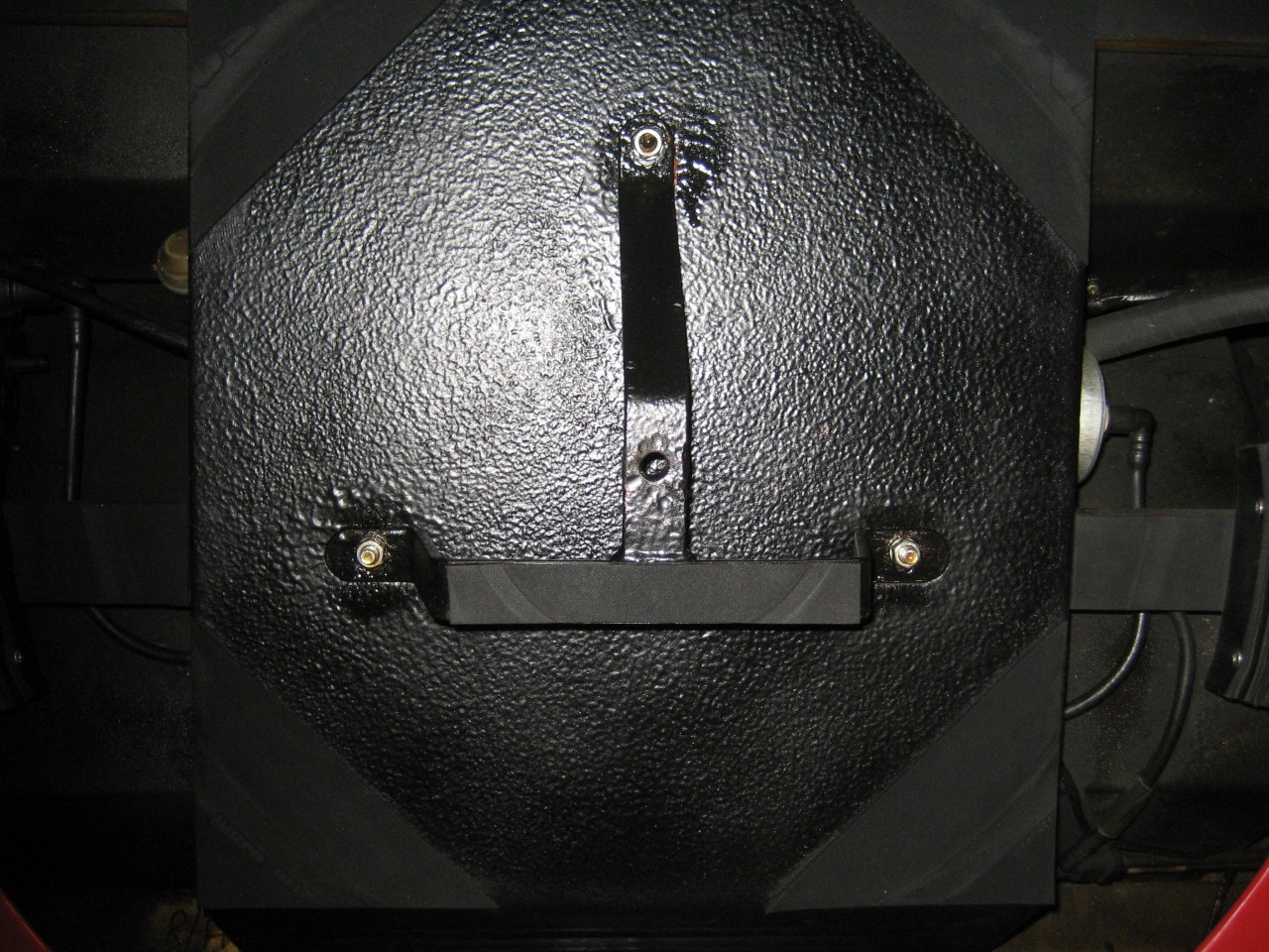

First job was to remove the spare wheel carrier. I took the opportinity later to treat the timber with Tectyl 506.

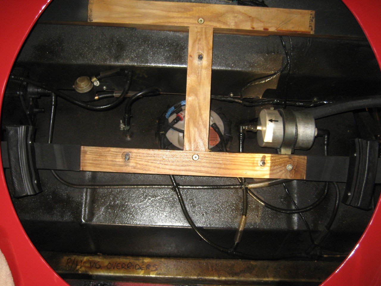

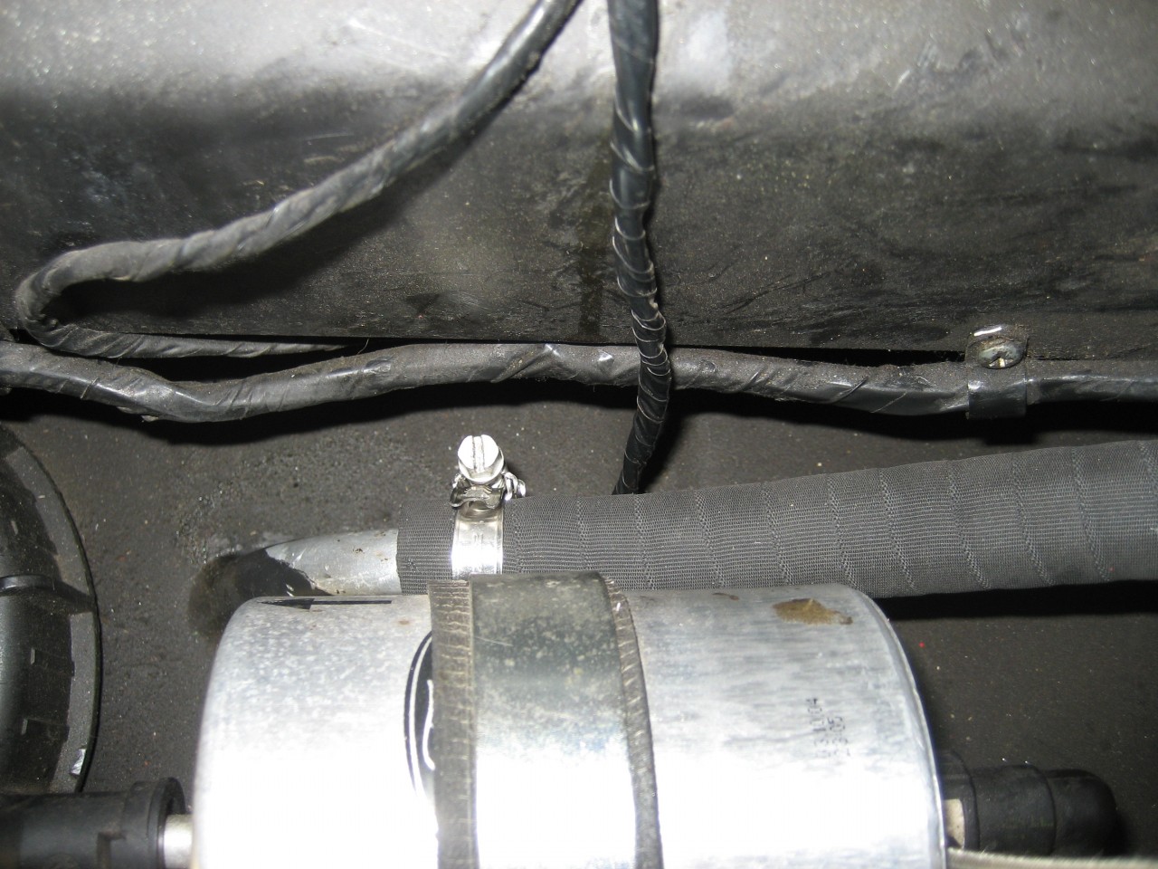

The fuel pump is central in this image, with twin take off pipes. The take off on the right loops round into the silver fuel filter canister, which then joins the other take off pipe at a T piece. To the left just out of shot is the charcoal canister on the return feed, and the circular grey item is the roll over valve. From this, the return fuel enters the top of the tank.

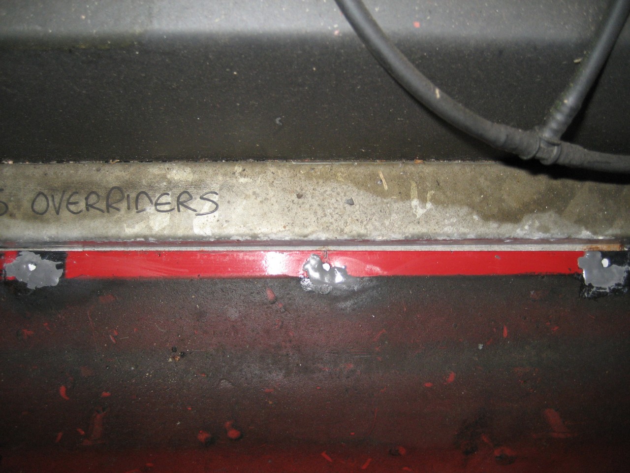

The rear valance was originally fitted slightly offset, and the holes had been badly treated.......

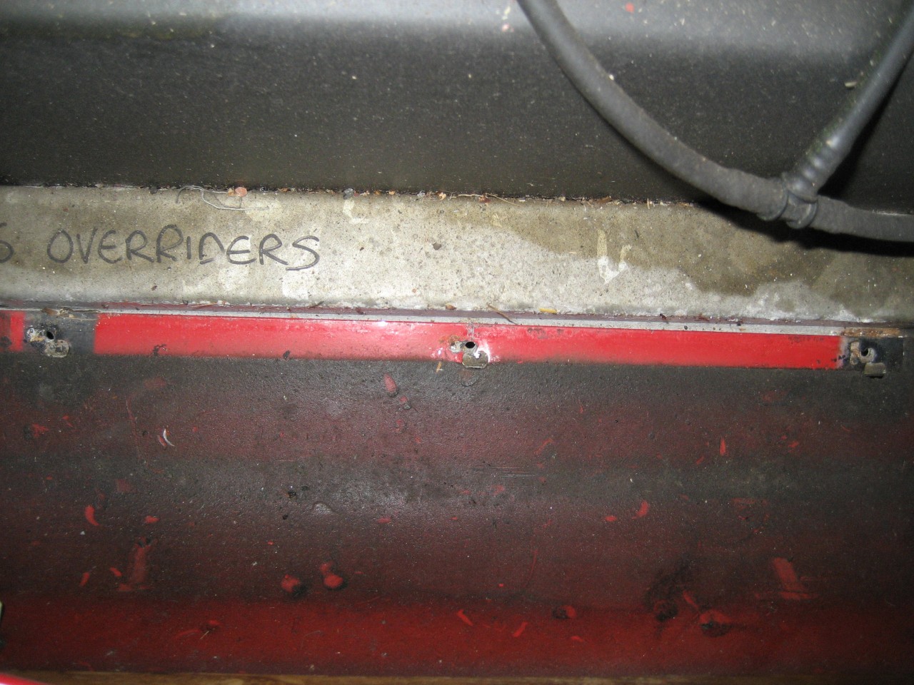

On the crossmember it notes "R/H V6 OVERRIDERS".
These are 3mm Allen heads with 8mm nuts.

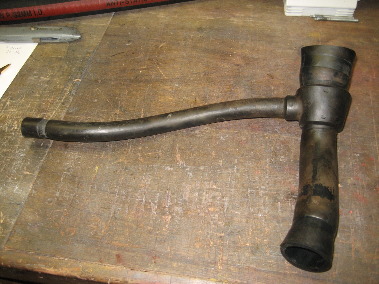

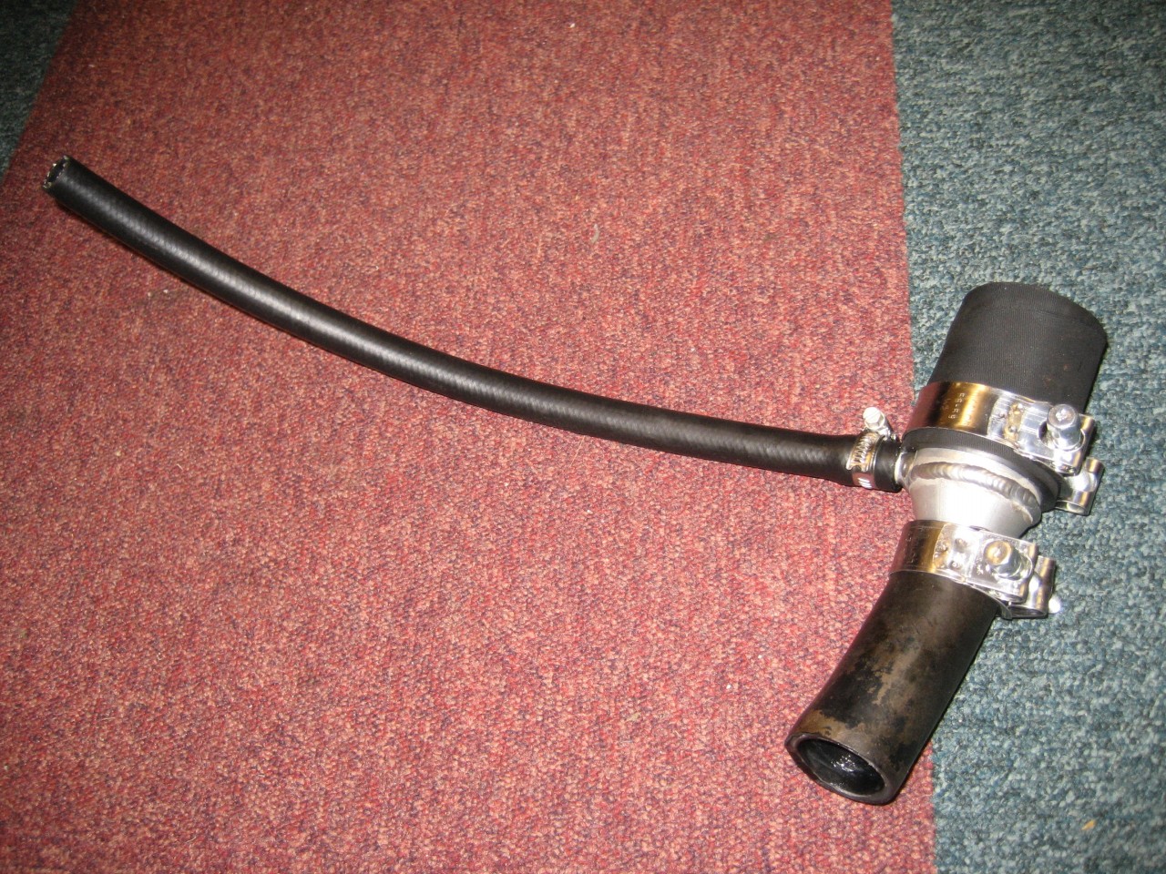

This is the fuel filler pipe. Although the breather pipe came off, the other two ends were stuck fast and had to be slit with a Stanley knife to get them off, therefore rendering the hose scrap. The rubber is very hard, but hardly any ageing, so I could have left it alone.

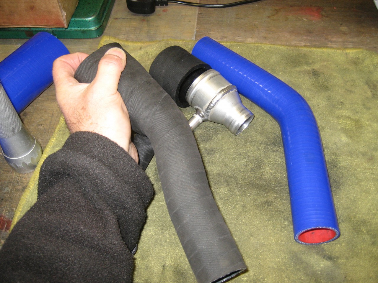

This was Plan A. I sent a drawing through to Simon At Sifab, for a short aluminium reducer with take off. My plan was to attach this to the filler cap with a short straight length of 51mm hose. The big problem I has with this arrangement was that the 32mm hose I bought for the lower section was too stiff, and despite removing the filler cap from the rear panel, it just wouldn't fit properly.
I retired to lick my wounds and ponder further.
In desperation I tried an offcut from the original hose, but it was too short and still not flexible enough........
While this was going on I filled the holes in the rear valance using JB Weld........

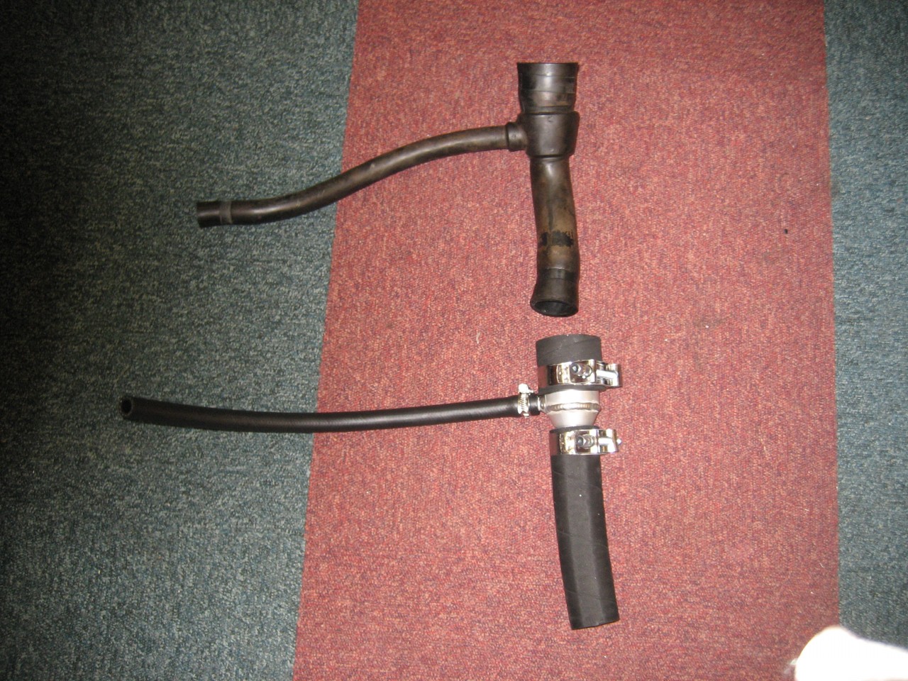

I decided to cut my losses and get a hose from Librands. Excellent service from Rob Wells. Although its advertised for Zetec cars it also fits the Roadster.

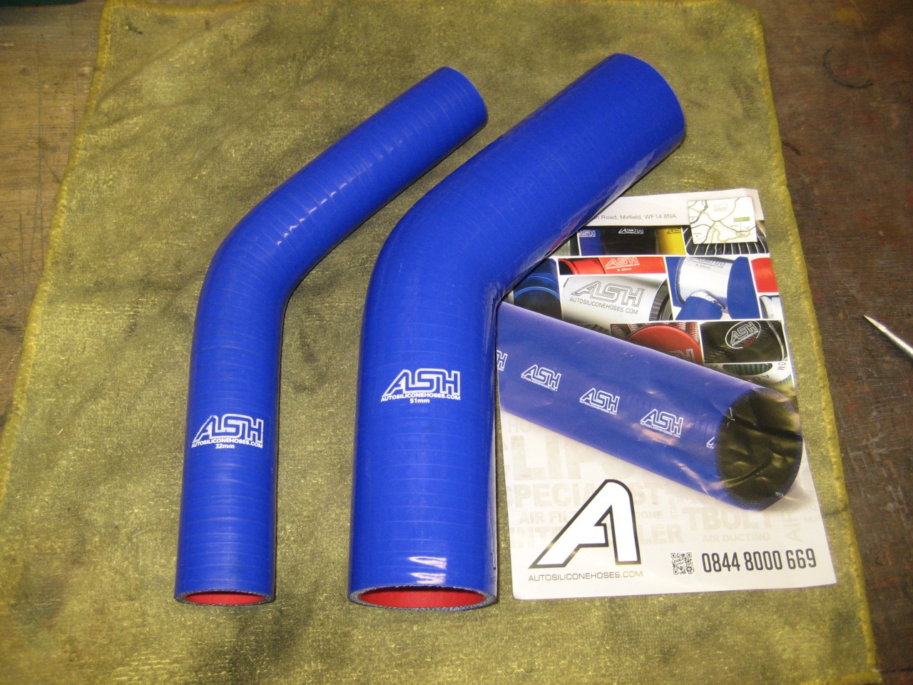

But I hadn't totally given up on the idea, and had also ordered some lined silicon hoses, which are fuel resistant. 51mm and 32mm.
Although I decided not to fabricate my own hose this time, note here that a short straight length of 51mm hose with the adaptor, and a shortened length of the 45degree silicon hose will do the job.

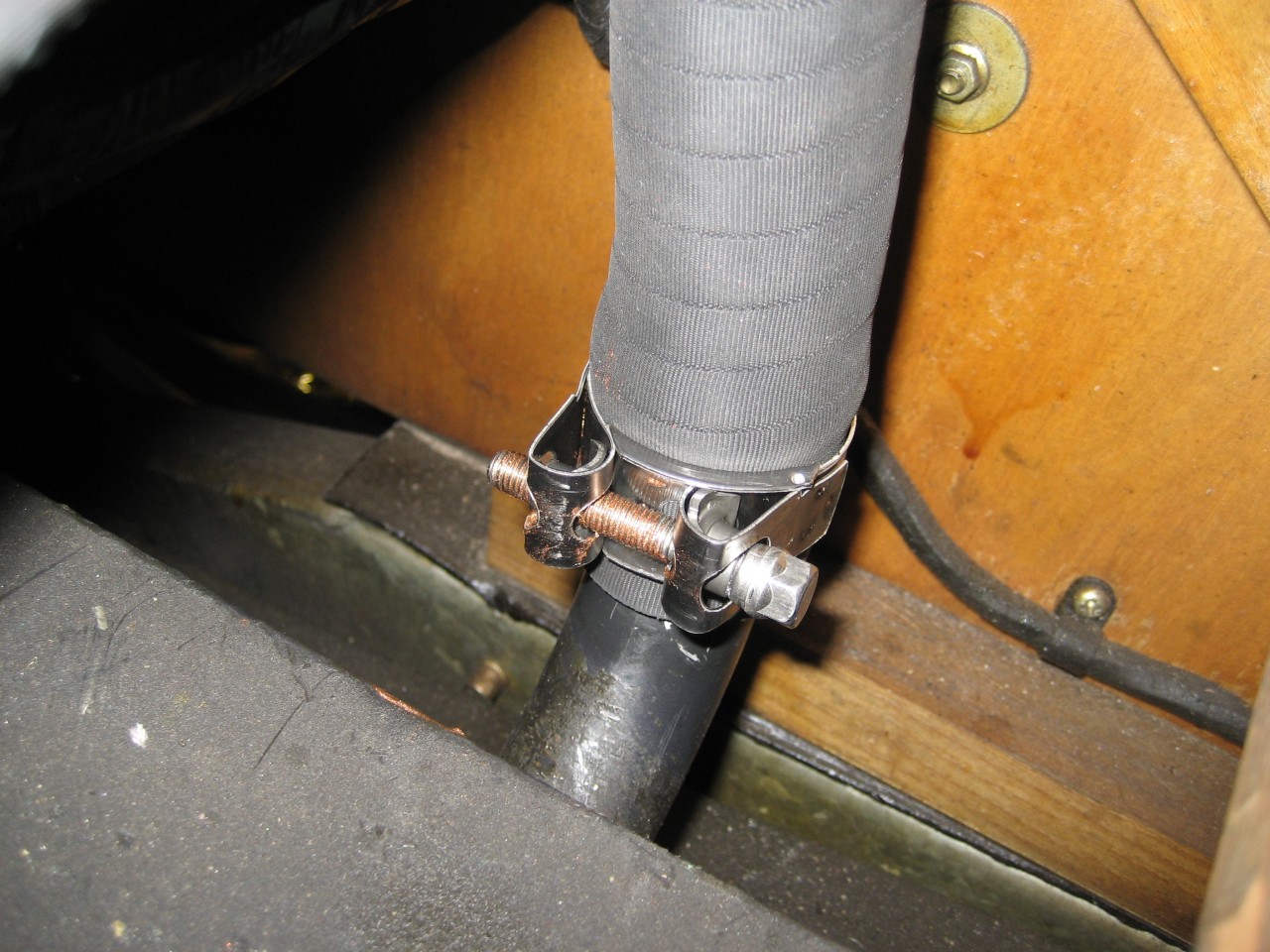

This is the tank connection with a superior hose clip.

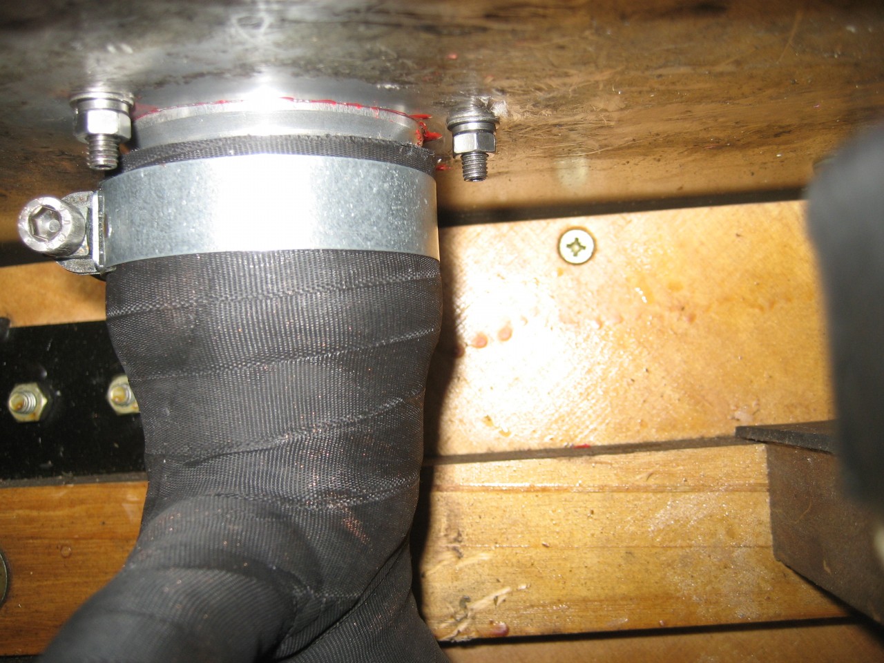

And this is under the filler cap. This was an absolute swine to re-attach. I tried it first with the filler cap removed but not a chance. The filler cap is held with 3x 5/16" nuts.
With the filler cap refitted, access is tight and the hose is a really tight fit. Really really tight. I had to replace the setscrew on the (original MMC) hoseclip as it was just too tight to fit. I used an Allen headed bolt, metric thread. What a sod this was to fit.......

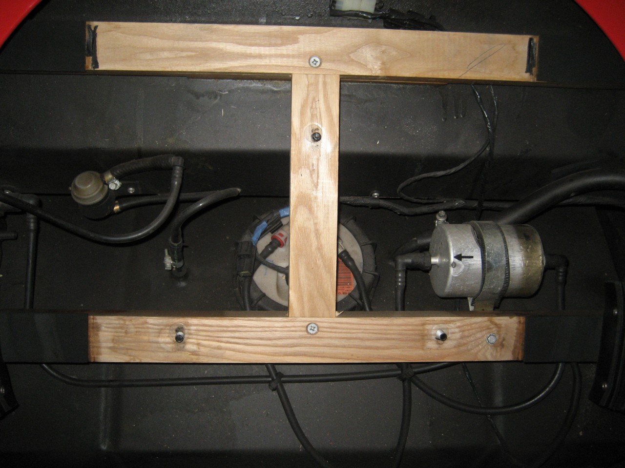

All back together and smartened up!

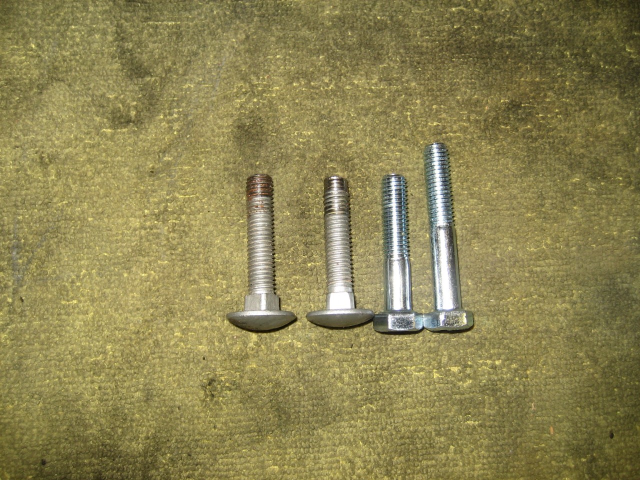

I replaced the three 13mm nuts here with stainless, but one of the coach bolts stripped. They can be drifted out from below, and so I replaced the lower two with 8mm bolts and penny washers.
The length is a bit marginal and so I used the extended bolt on the right.
