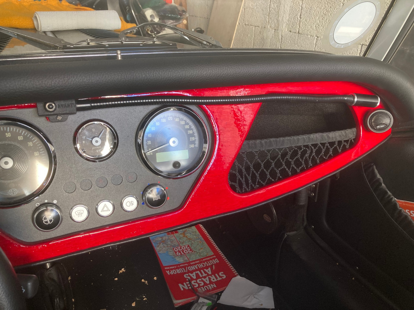

Now as it‘s done I would be happy about some help again.
I‘m not able to post pictures, I think it‘s worth for some pictures in the „dash theme“.
May be someone has seen it in „Facebook Morgan News“.

Here you go....

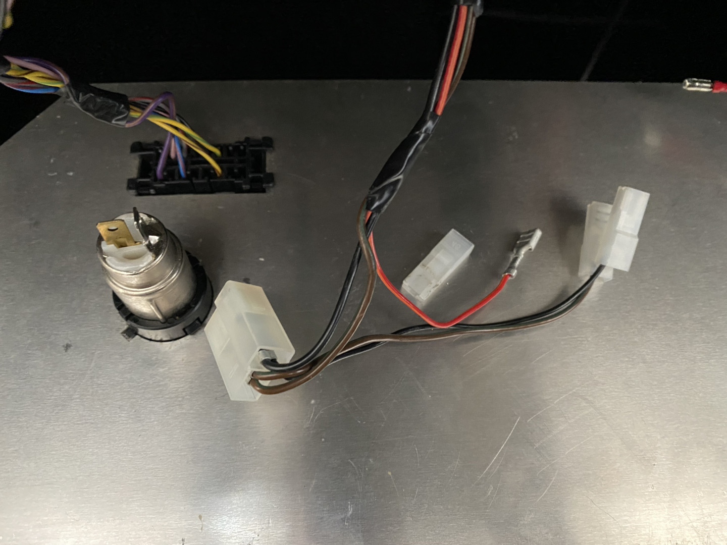

Just to add to this thread, a picture of the under-dash-tray, and the wiring. I added an additional horn to the brown-green wire (permament 12V) that was tied to the power socket connection, and my own footwell lighting to the orange-yellow wire (12V with ignition on).

Sorry, orange-yellow is 12V with sidelights on.
